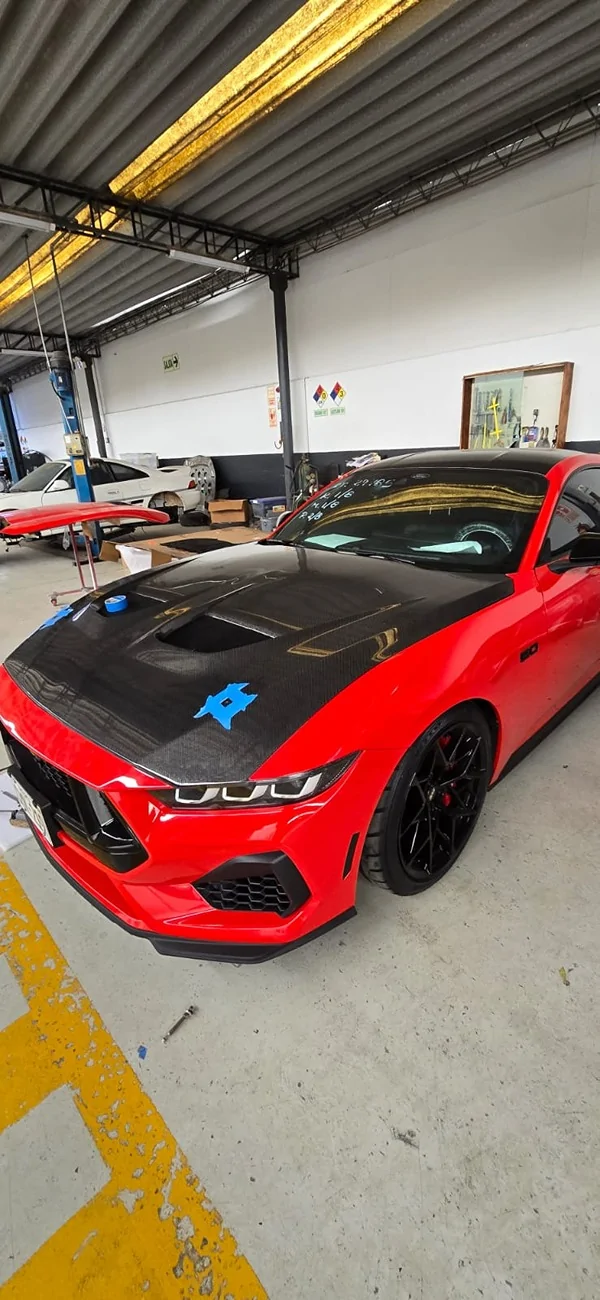

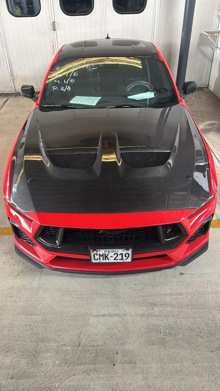

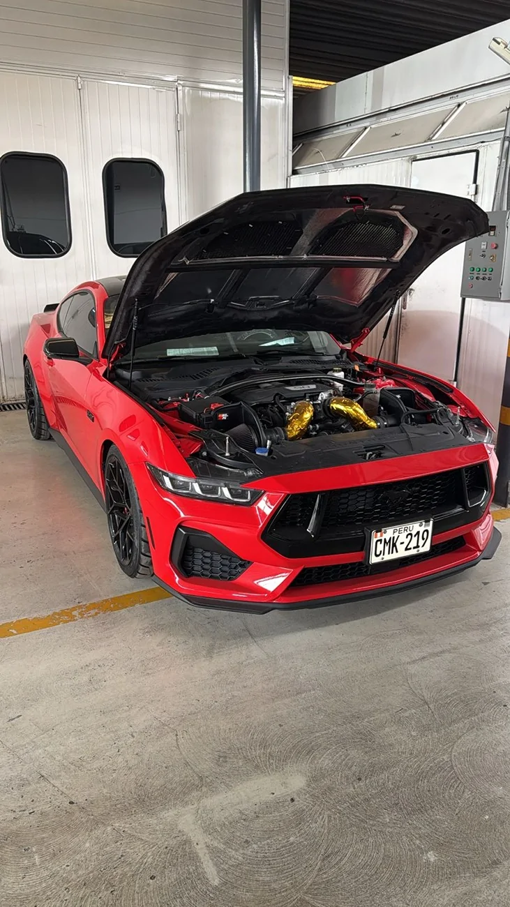

Hey, I just bought a CF hood and hood pins as suggested by Anderson Composites.
Can anybody help with the exact Pins location on the engine bay of an S650?, because I havent found anything specific for that generation.

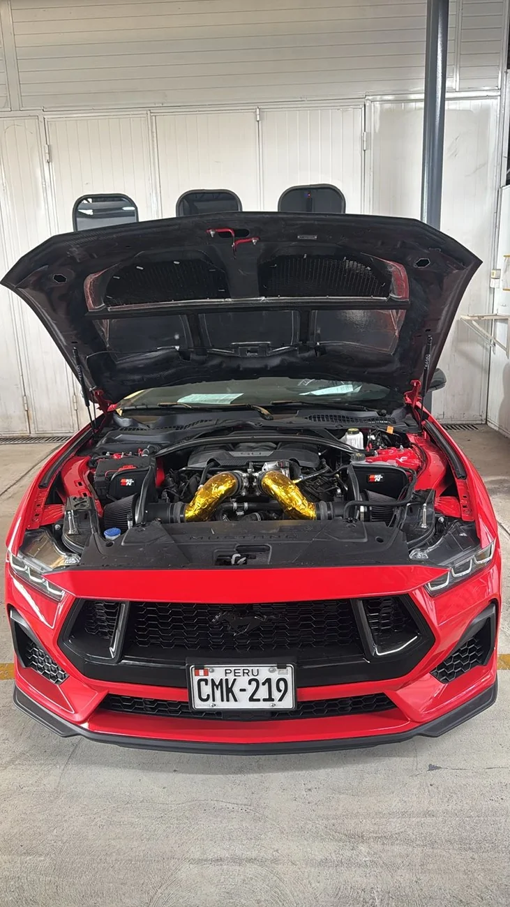

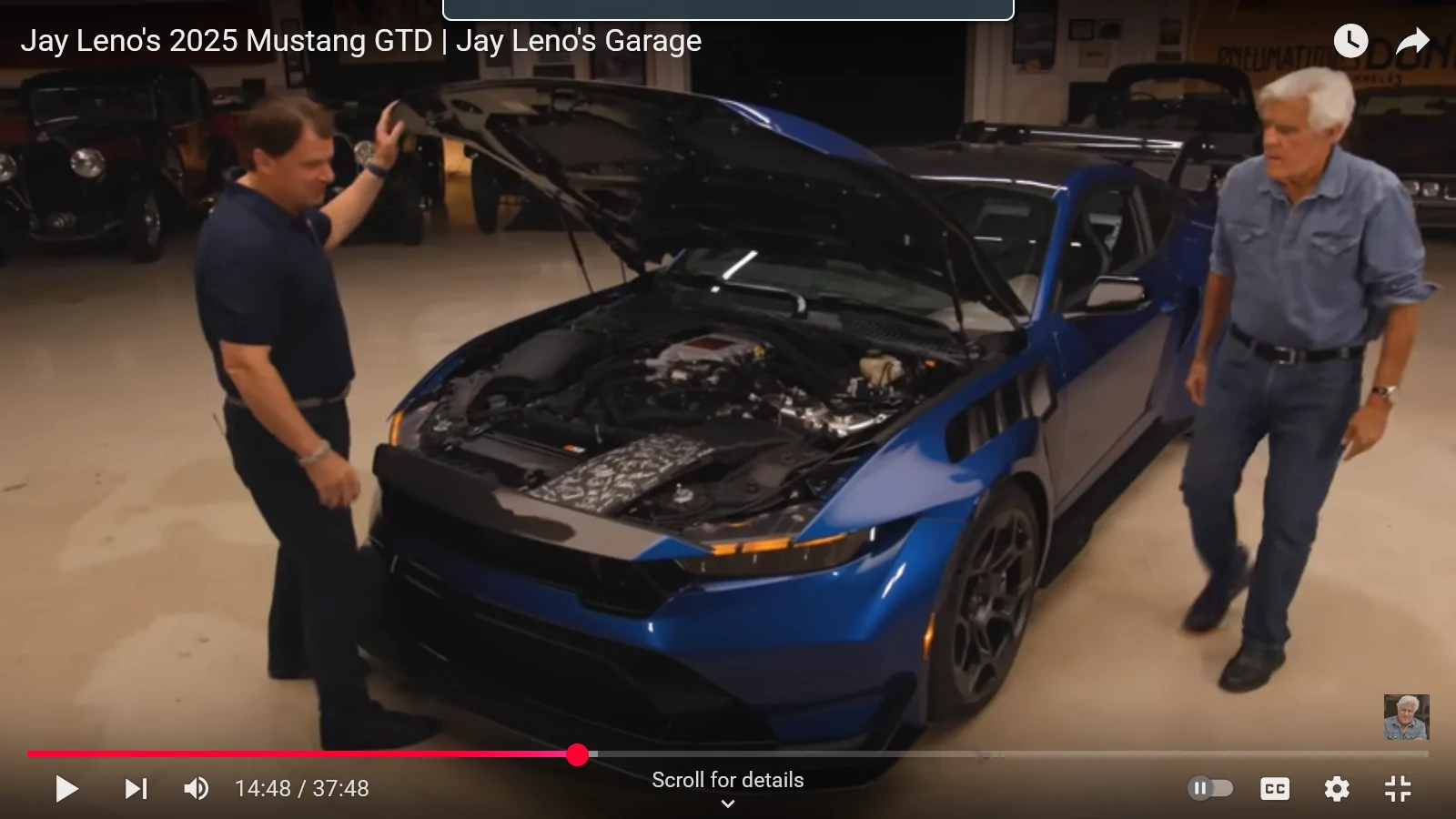

Well you can assume the pins are going to go into the upper tie bar on the core support
Someplace where there is not a wiring harness under where you will be drilling, no radiator under the area etc. and symmetrical
If you watch the GTD video from Jay Leno's Garage when they open the hood you can get a real good idea where they mounted the pins on that car.
I linked the video and a screen shot in the next post

Thanks for the answers, I saw that video but wasn't sure if it's the same location for the Regular GT.

I'm still debating on whether or not to keep it as exposed cf or to color match it to the rest of the car.
Any advice?
