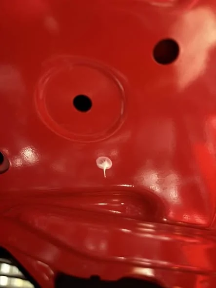

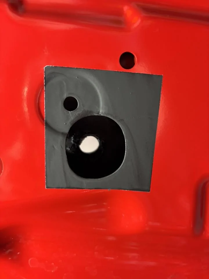

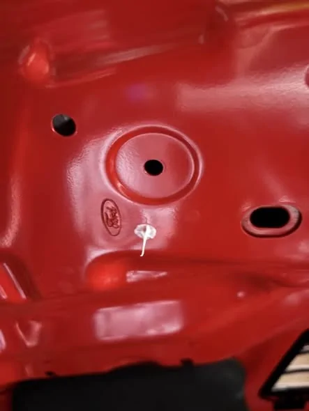

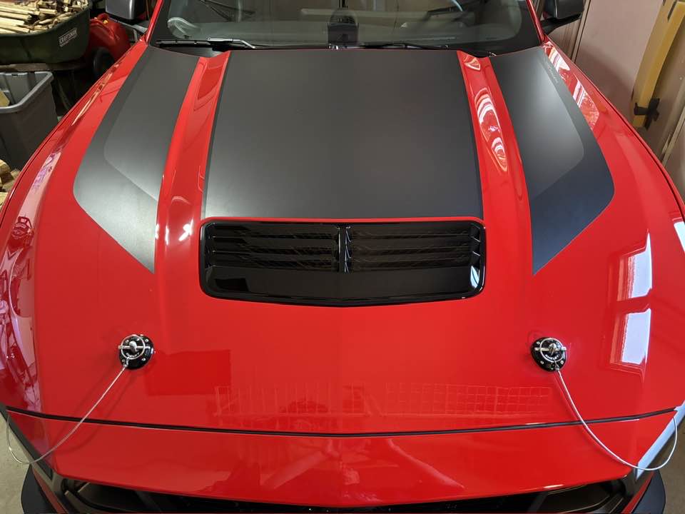

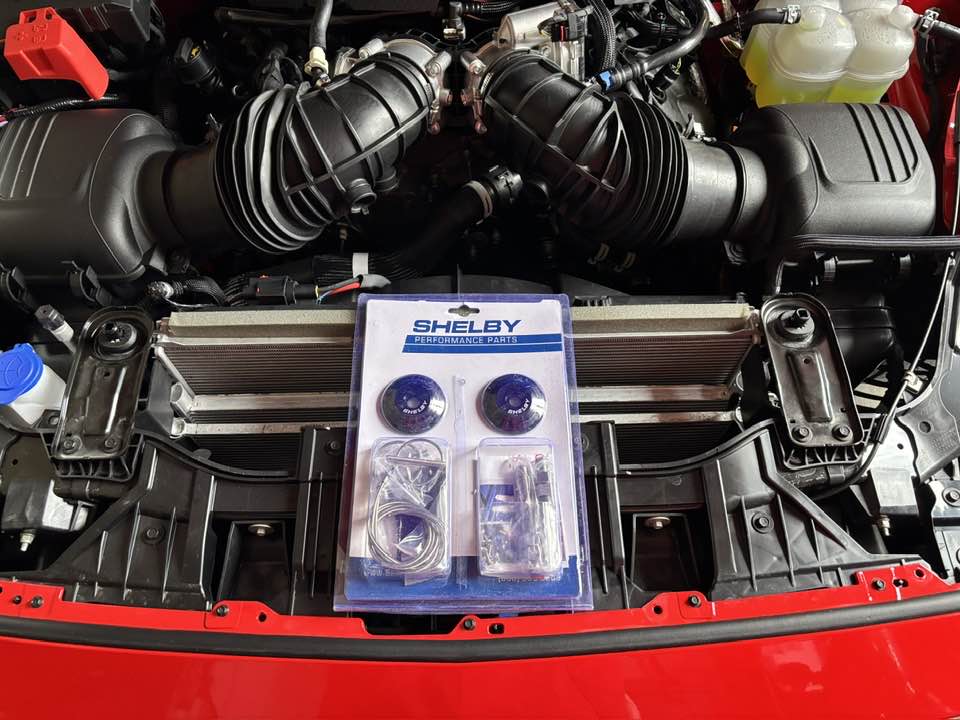

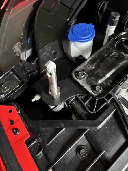

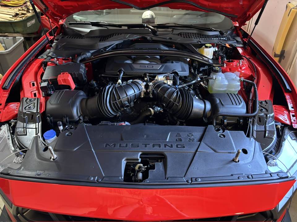

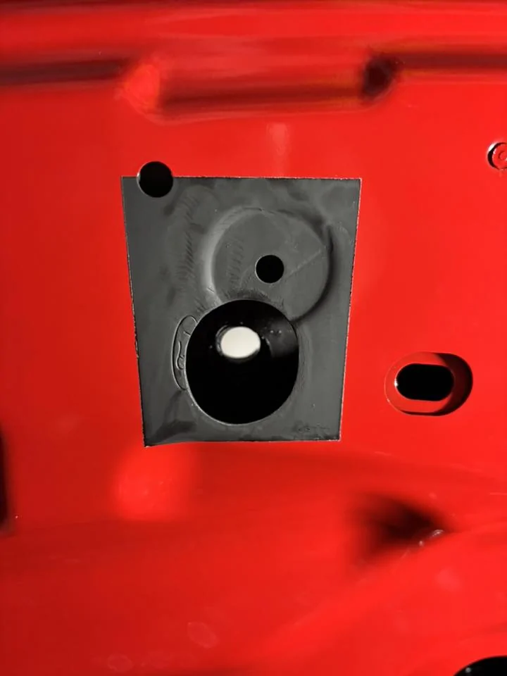

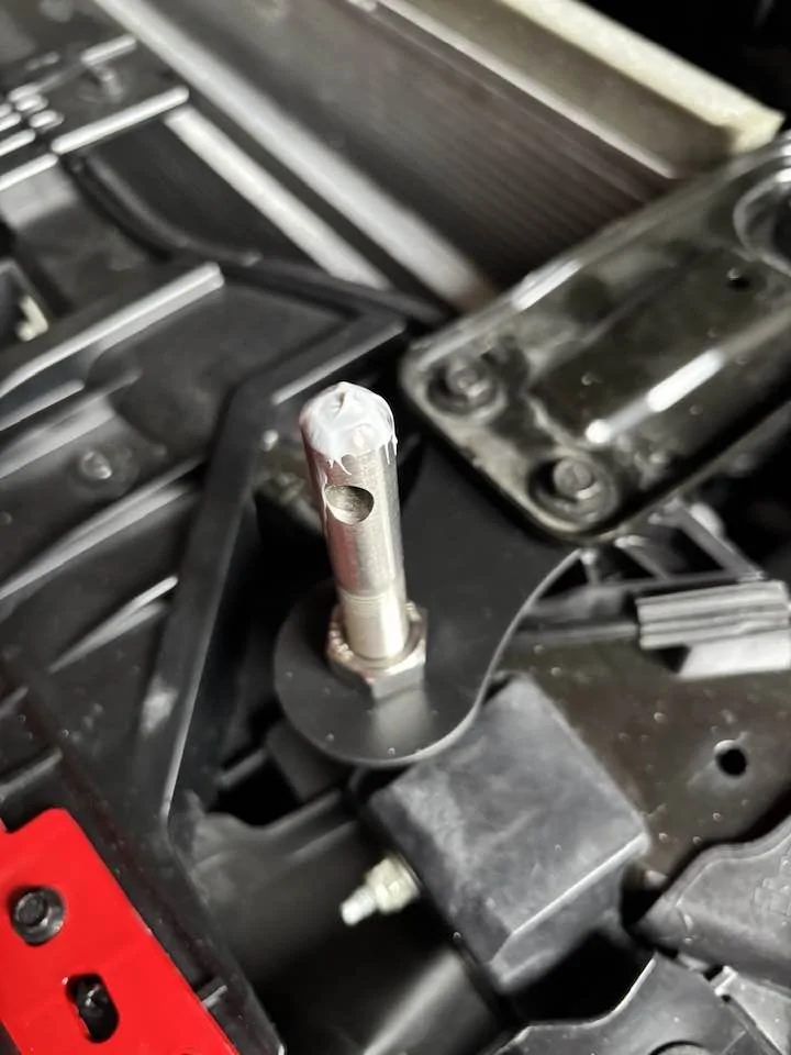

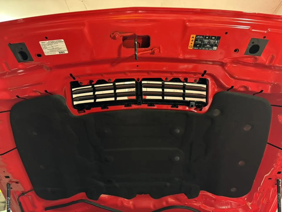

I used this kit on a stock Dark Horse hood and it worked really well, the supplied brackets use the original bolt location for the radiator support.
The white stuff is toothpaste to locate where to drill the pilot hole under the hood for a starting location...
