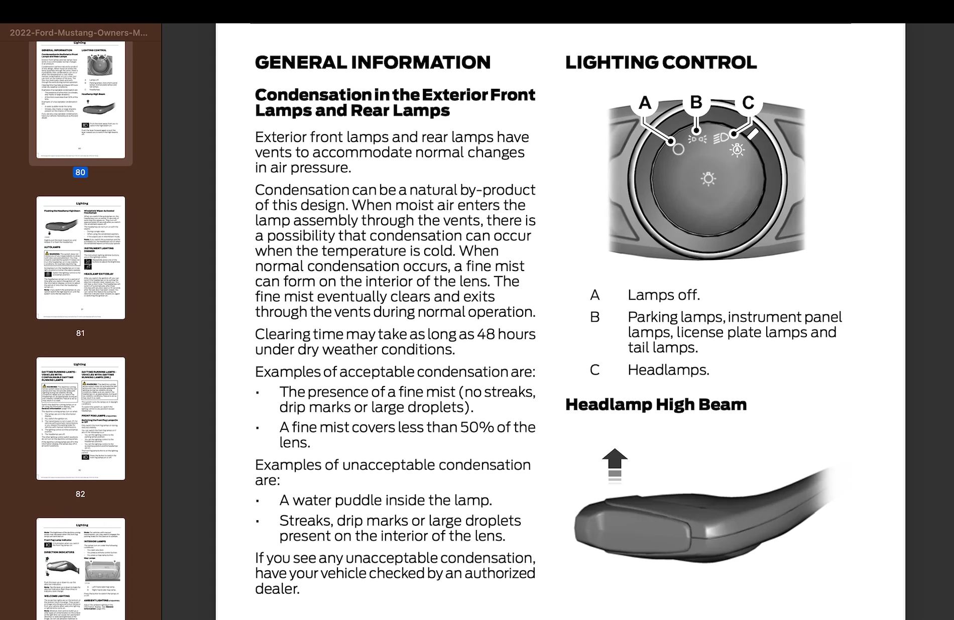

Hello everyone:
i just bought an S650 a week ago and I’m noticing the headlights are fogging up. I thought maybe there was a crack or something but the condensation is rather uniformed between both headlights.
Has someone here experienced this issue and if so, what’d you do to fix it?!
Thanks!

The assemblies are vented. Condensation in the headlights is often a result, in certain conditions.
https://www.google.com/search?q=mus...He-8E1IQrQIoAnoECBsQAw&biw=1463&bih=742&dpr=2
Thank you, Skye!
Same as mine. On both sides the condensation looks exactly the same. But that's only after a long drive. It has to do with heat and cold. It goes away eventually.
Thank you! I figured it was by design because of the uniformity but it works on my OCD! lol
