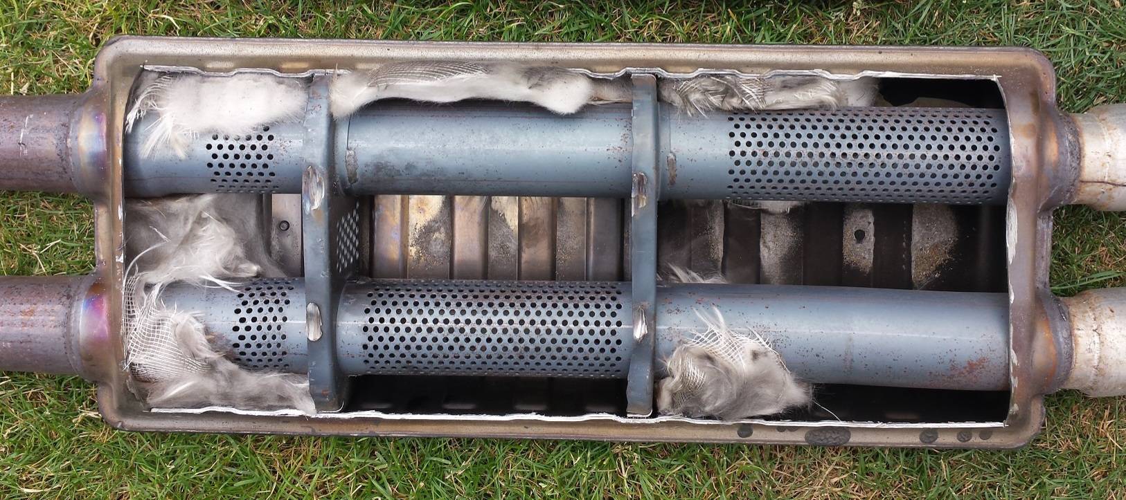

The emissions will change significantly with the H-pipe? To the point that it won't pass a regular test? Isn't the resonator just about the "sound"?
Incorrect but however…
a basic x or h (that isn’t leaking) will not ‘change’ the ‘emissions’ in a significant manner so that it will fail emission sniff testing but however it is a ‘modification’ to the as delivered emission equipment, thereby potentially voiding the ‘factory’ emissions’ warranty. There are circumstances that allow you to replace a defective part with either like or better rated but only (or something like 25 years) after failure or (accidental) damage of ‘stock’ part.
yes, resonator is mostly about sound but does play a part in flow

Yeah just wanted to know about the "legal" emissions... as they are very strict here in EU, so I was curious if they changes significantly to the point that will go over the "limits". As for the sound, I'm not much worried about the dB's, they doesn't check that (neither they know about the quiet mode or such). An H-Pipe is the only "mod" I would ever consider, coz I'm missing my former Bullitt (stock) sound so much. :(
No reason for the emissions to change, the resonator is just there to make less noise. Just look inside.
With an H, the noise will be a little louder, nothing more. 👍

I am pretty sure the European cars have a OPF filter. So even if you do a H-pipe it won`t be as loud as USA cars.
Cool cut out, for some reason I thought there was an H- connecting pipe in the stock resonator and not just vents
