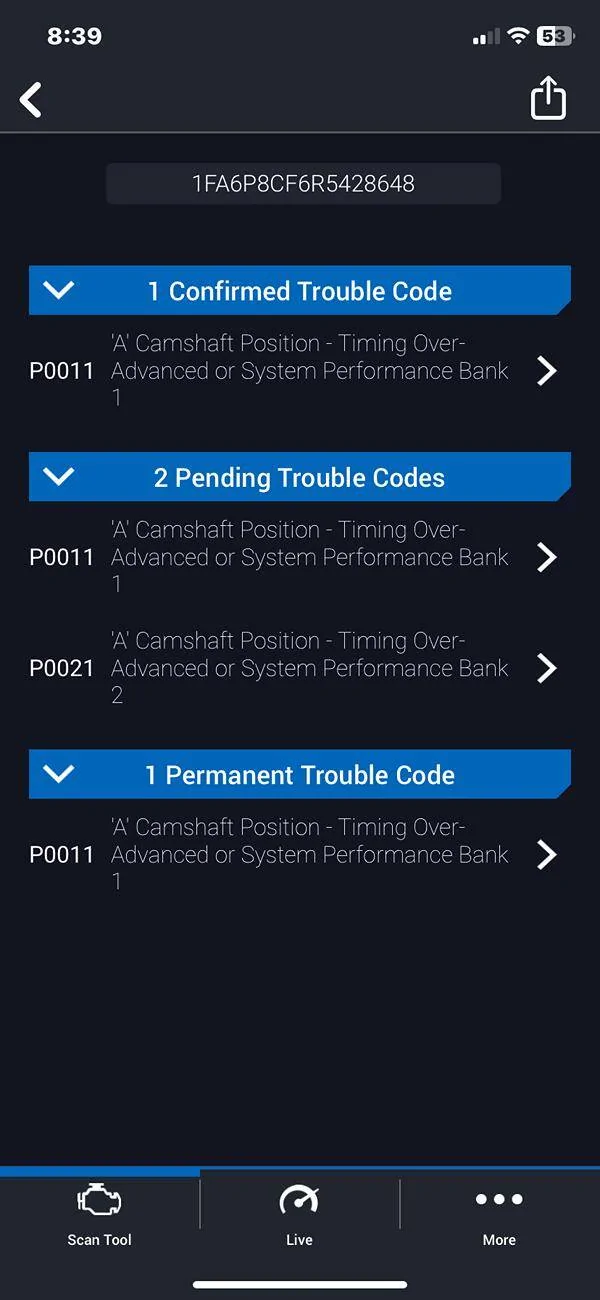

I lost mine twice, had to unhook battery and it came back along with check engine light!
i cleared them but, i have a stored permanent code. 2k miles on car
S650 Mustang Gauge cluster screen black IMG_9352
