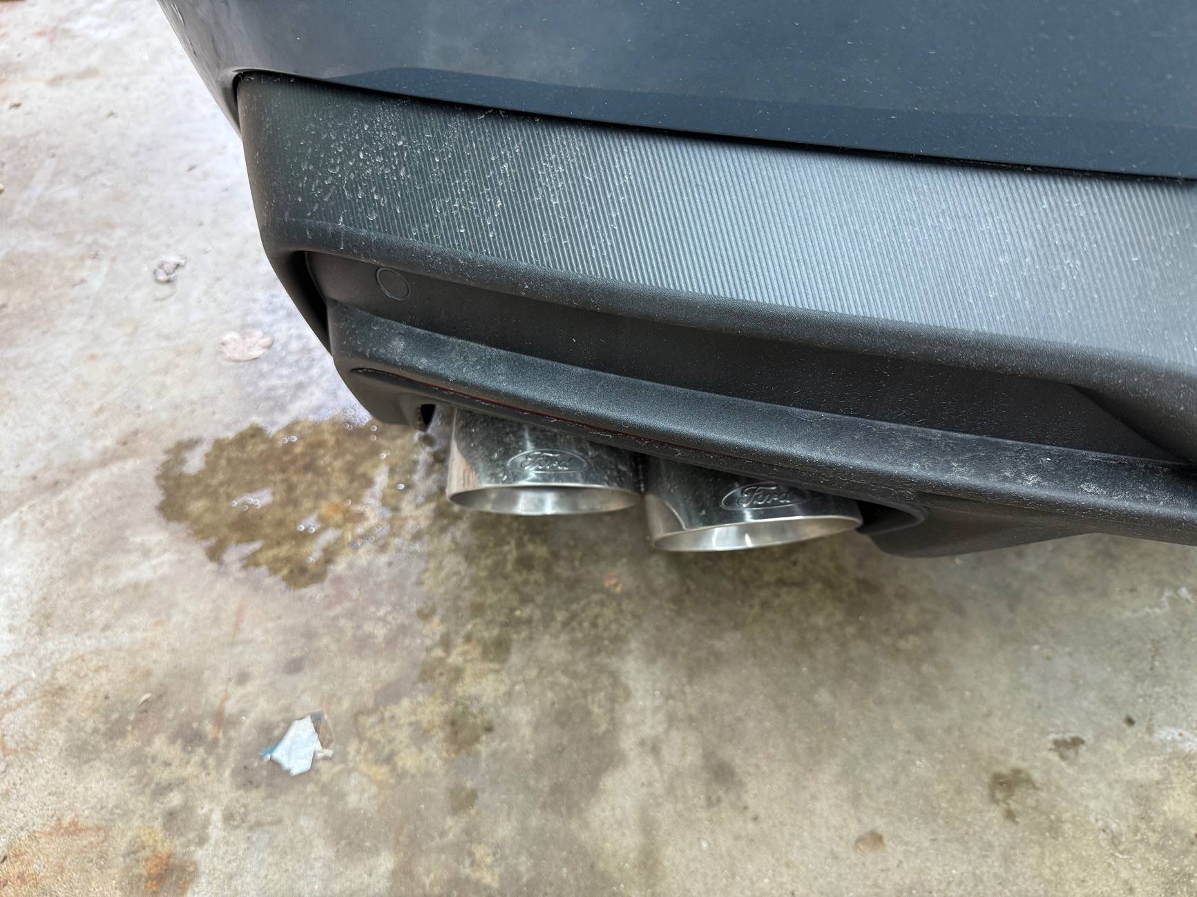

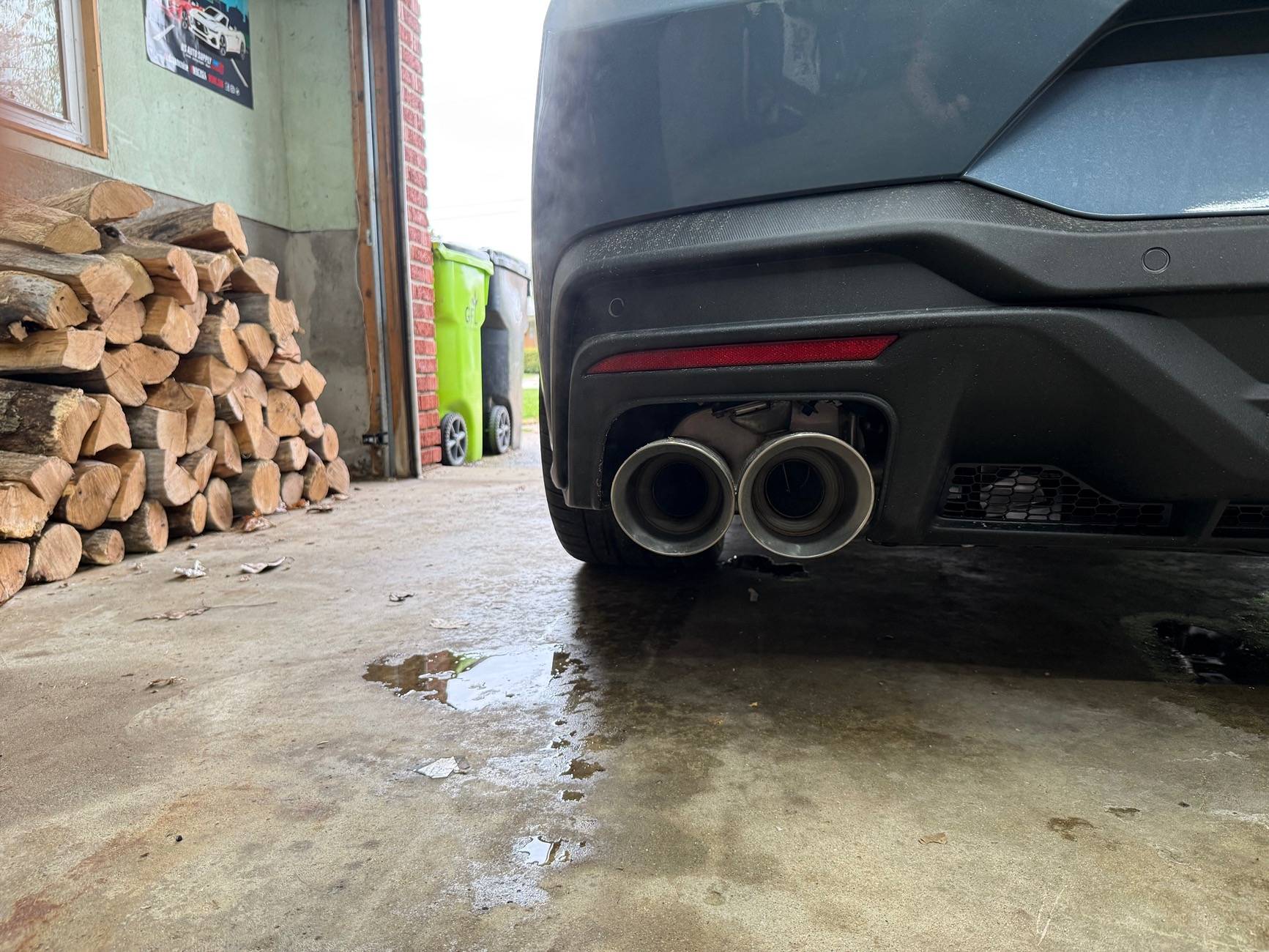

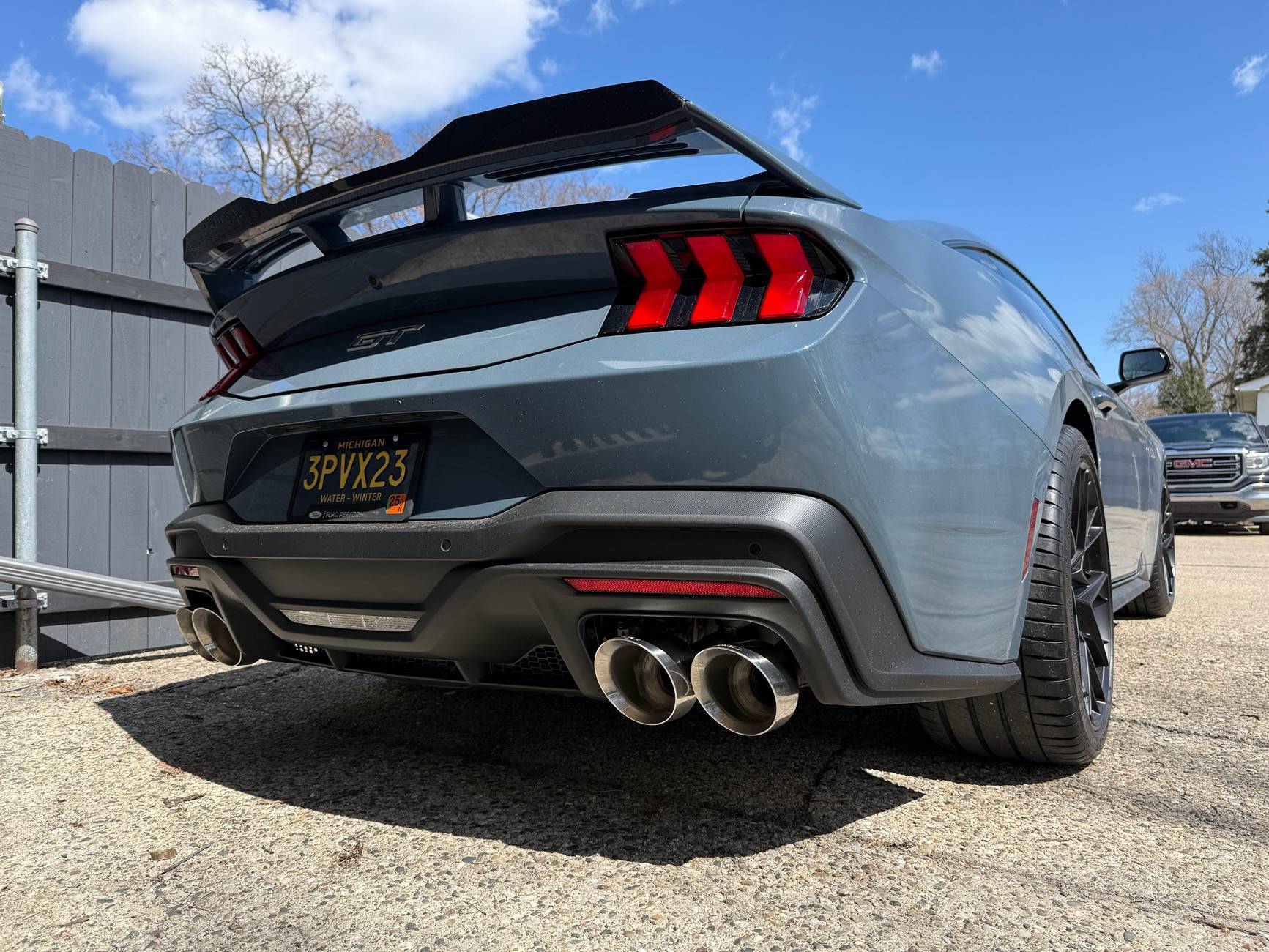

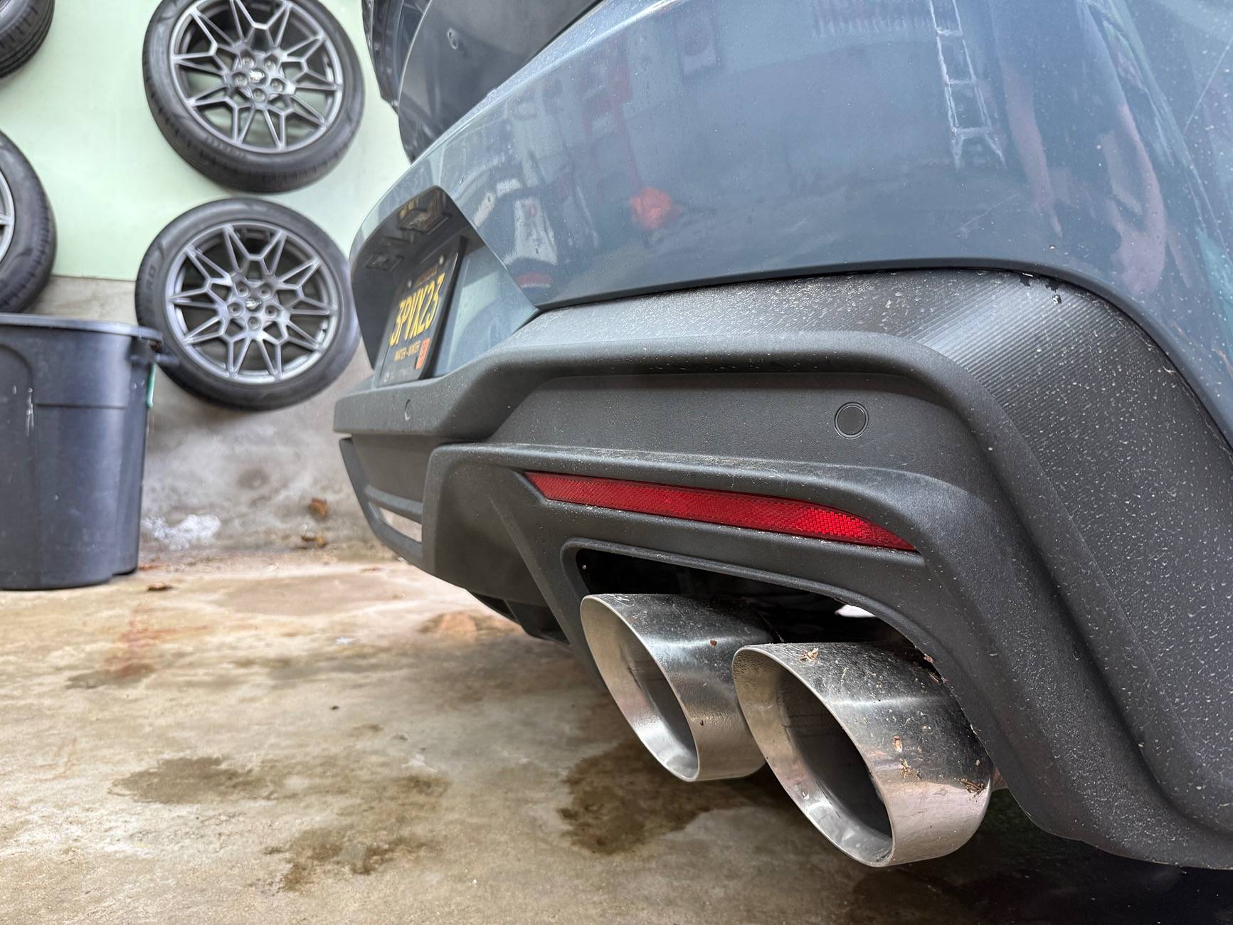

I'll be getting mine installed at an exhaust shop, i'm just scared the alignment doesn't look good later on lol, I'm trying to have it be as good as the stock alignment - but most of the pictures/videos i've seen, one is always lower than the other one or they're weirdly looking 😭

Thats what i thought before i ordered them but after the install they do not look as bad in person, especially at eye level. Since the FP tips are pretty big, like 5", the DH diffuser is designed to accomodate these larger tips while also giving the exhaust the "wiggle room" it needs. Because of this you can see a little of the muffler through the cutout for the exhaust on the diffuser which makes it look more misaligned than it actually is. If you're curious to see any other angles of the exhaust just let me know and i can post pics.

I would love to if you could, I’m pretty scared of how they’re gonna fit 😭. I like the stock look but I know these tips are bigger and stick out a little bit more lol

apologies for the dirty car, weather’s been crazy here in MI, yesterday was 84° and sunny today was 45° and rainy.
S650 Mustang FP by Borla Extreme Active Cat Back IMG_3404
S650 Mustang FP by Borla Extreme Active Cat Back IMG_3478
S650 Mustang FP by Borla Extreme Active Cat Back IMG_3475
S650 Mustang FP by Borla Extreme Active Cat Back IMG_3476

Fits like stock, I like it. I’ll definitely be asking for this fitment when I get mine done. I’m getting the black tips. I have vapor blue as well, best color in the lineup 🤪
