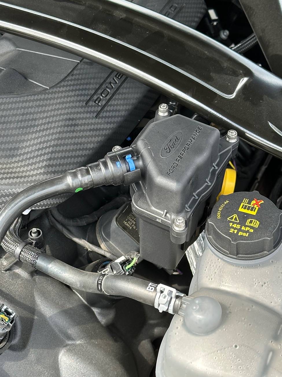

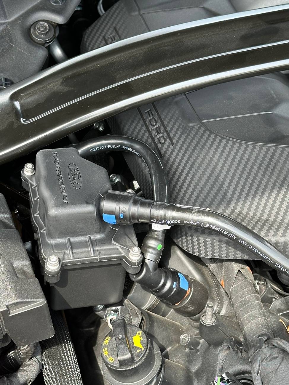

I have this, but just installed after winter storage. Very complete kit I cheated though and let dealer servicing the car install ($60).

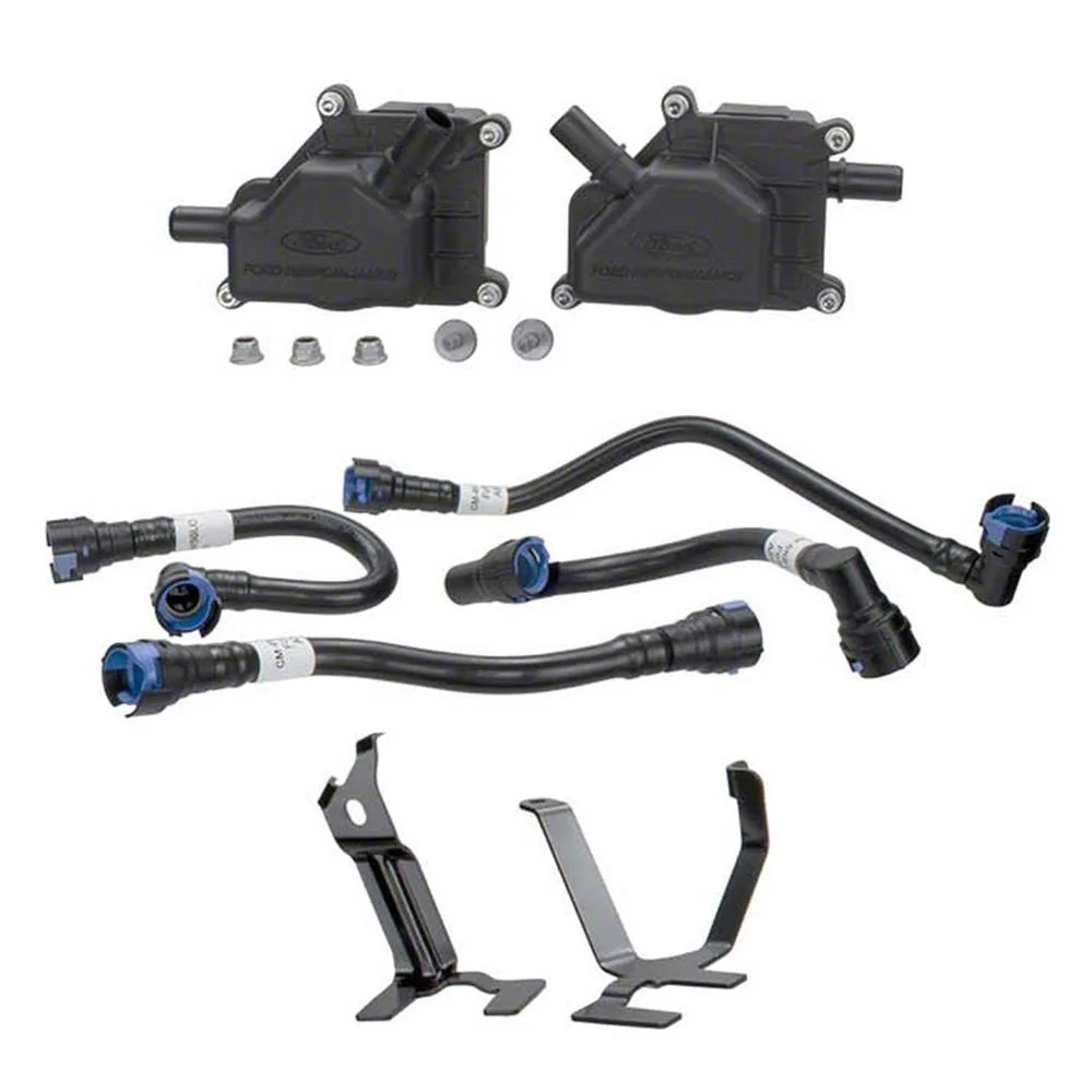

Probably a good idea if in warranty (if that matters to you) to have them install it. I am trying to evaluate my options. $600 is a bit steep for both sides (passenger/dirty and driver/clean) especially if the driver side is always empty. I'd say driver/clean side is a good idea if you have boost, but they make another part number for that M-6766-A50DSC vs M-6766-A50D. Also, if there's a way to see if the M-6766-A50D is similar enough as the M-6766-A50A for passenger/dirty (and maybe buy just new hoses if the AOS body is the same). Or just go aftermarket, JL OSC $170 or UPR $200 where I can add a clean side for $150 in the future if the Gen 4 Coyote without boost fills up both reservoirs.

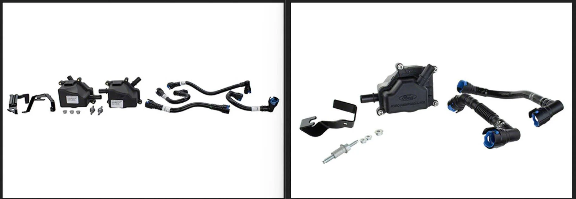

Side by side pic...
S650 Mustang Ford Performance 2024 Mustang Oil Separator Kit - Now Available 1746297838549-zc
Update, may have answered my own question, only thing in common is the AOS Body in the first line below. The hoses, brackets, and nuts/bots are different. The hoses don't show they can be ordered separate except for the S550 kit.
S550 Kit contents:S650 Kit contents:S650SC Kit contents:
1x CM-6766-A50A Oil separator1x CM-6766-A50A RH oil separator1x CM-6766-A50A RH oil separator
1x CM-6K817-M50A PCV tube1x CM-6K817-M50RI RH inlet PCV hose1x CM-6K817-M50RI RH inlet PCV hose
1x CM-6K817-M50B PCV tube1x CM-6K817-M50RO RH outlet PCV hose1x CM-6K817-M50SCRO RH outlet PCV hose
1x CM-BRKT-M50A Bracket1x CM-BRKT-M50R bracket1x CM-BRKT-M50L RH bracket
1x W520412-S437 10mm flanged self-locking nut3x W520201-S440 M6 nut1x W717798-S437 M6 bolt
1x HL3E-6C291-BA Cam Cover stud bolt2x W701571-S450 studbolt2x W701571-S450 studbolt
2x W520100-S437 8mm self-locking nut2x W520201-S440 M6 nut
1x CM-6766-M50D LH oil separator1x CM-6766-M50D LH oil separator
1x CM-6K817-M50LO LH outlet PCV hose1x CM-6K817-M50SCLO LH outlet PCV hose
1x CM-6K817-M50LI LH inlet PCV hose1x CM-6K817-M50SCLI LH inlet PCV hose
1x CM-BRKT-M50L bracket1x CM-BRKT-M50SCL LH bracket
