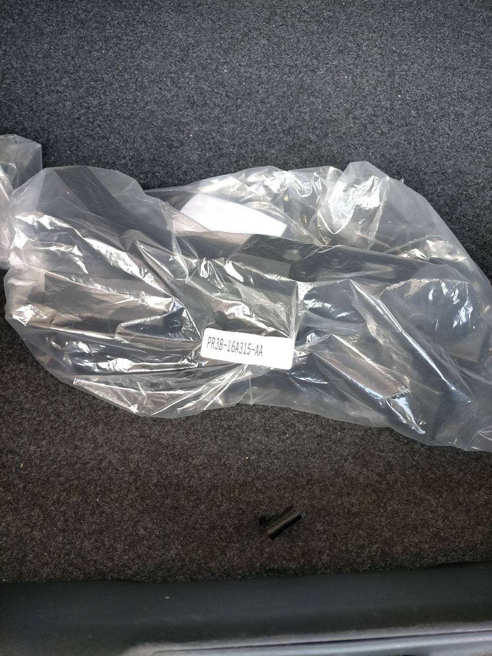

1. Under body aero strakes to fit

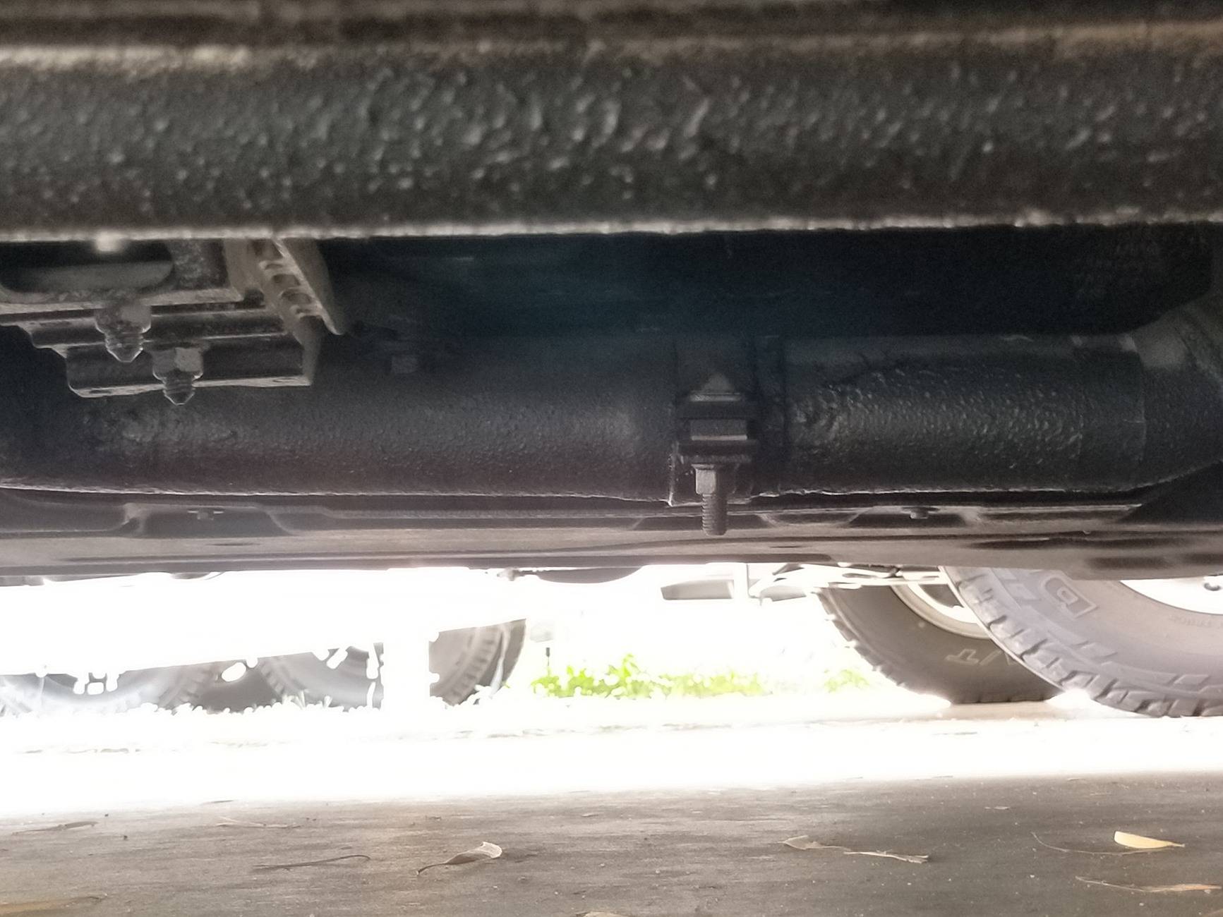

3. Rotate clamps on exhaust, scraping on driveway, bolt is sitting pretty much vertical

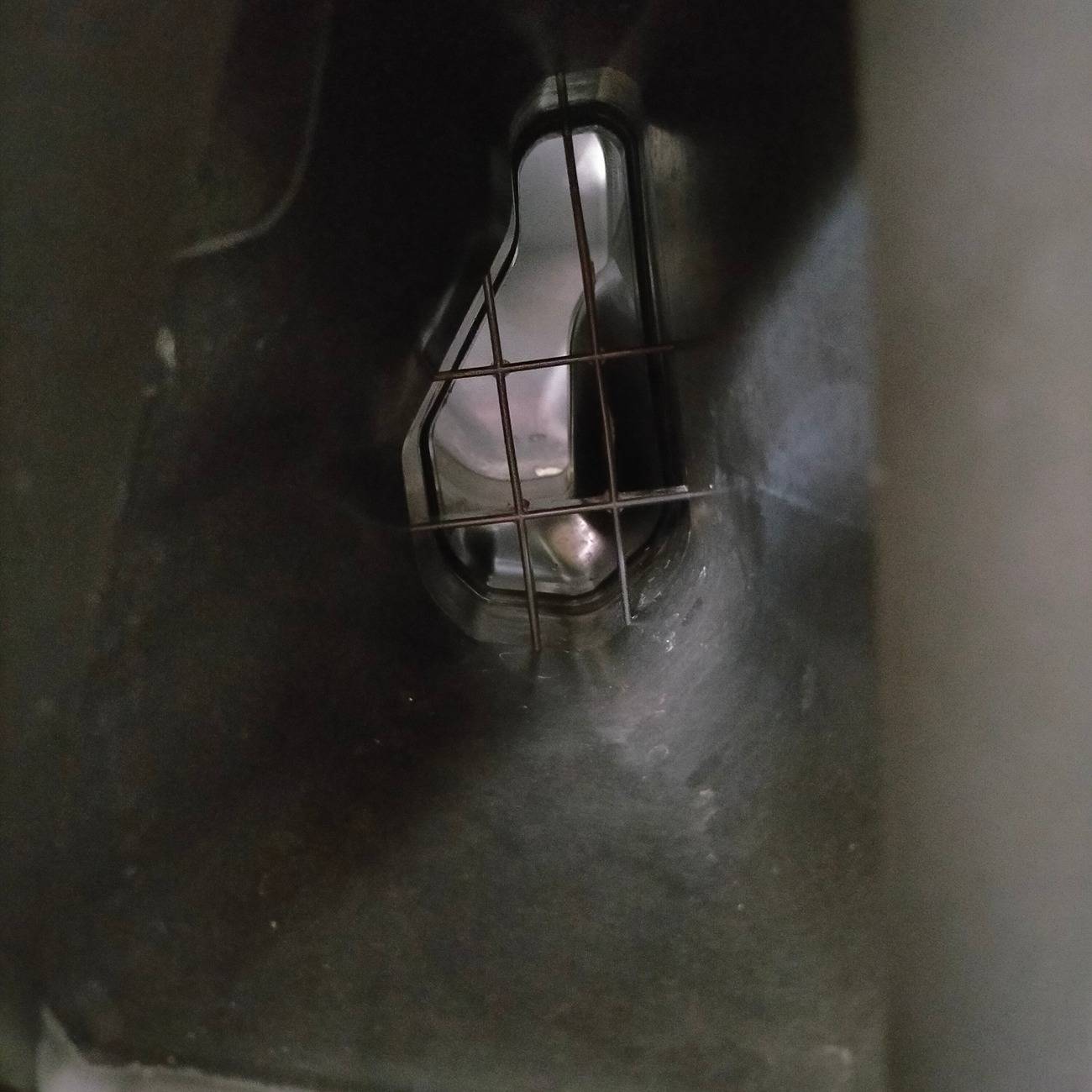

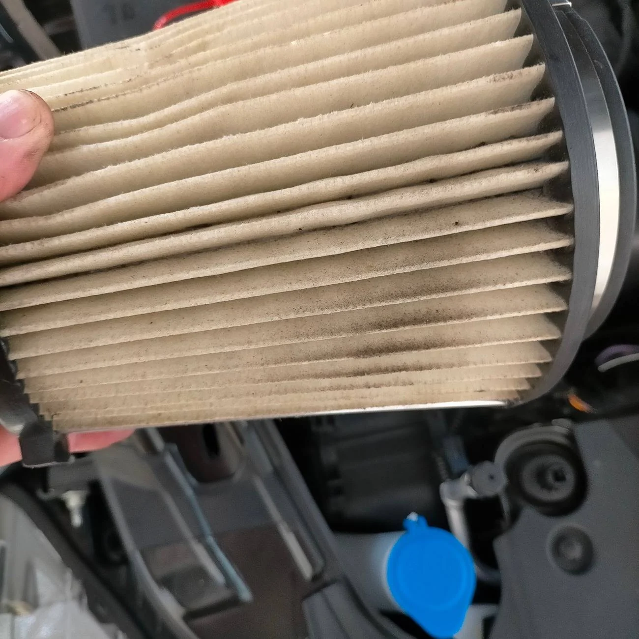

I fixed the drivers side intake connection to airbox this morning, pretty easy, removed filter (1076km) which was surprisingly filthy, and bracket screw, and pushed into place
S650 Mustang First Service Time IMG20241030072720
All fixed, left hand side looking at photo pushed back in place, was pretty much all that side not engaged and choking off intake

I do not see the OE filters lasting 10k miles. Mine looked about the same. I think you would be lucky to get 5k out of them before needing to buy new. I also had to realign one of my intake pipes into the filter housing.
My exhaust does not scrap but my front lips and Sto N Sho setup does if I do not leave at a steep angle. My exhaust flange bolts are pointed straight down as well. I will add that to the list.

@Mastermind46 I only noticed the exhaust scrapes when someone is in the passenger seat, but the gutter is a sloped 60 degree by 200mm high, so I got to take a fair angle.

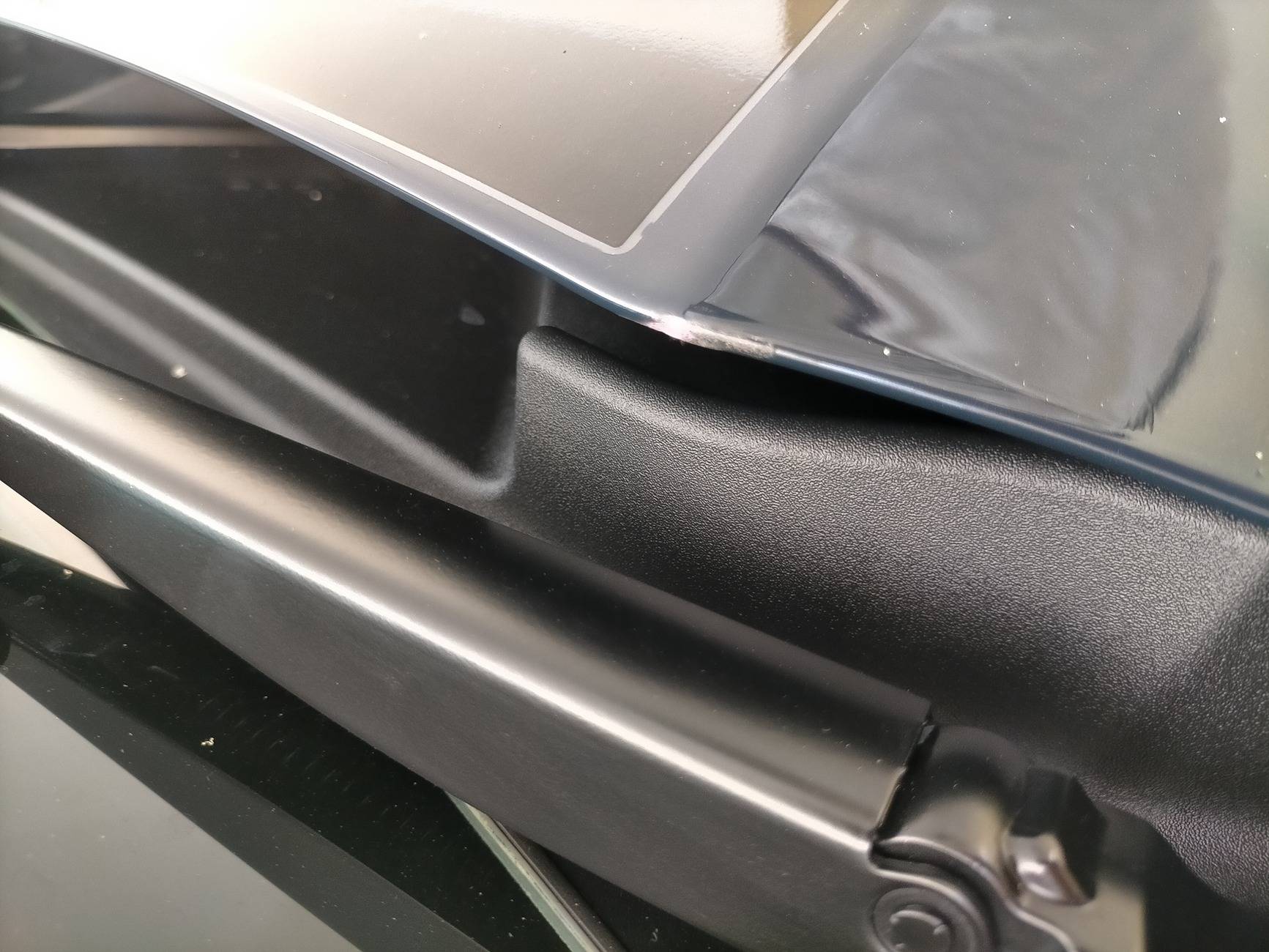

Only real thing bothering me with the car is the bonnet, when I talked to Mackay Ford, I did want the car booked in on the Friday to get sorted, but they said Saturday would work for them as workshop foreman would sort......list of other things sorted...exhaust clamps spun round, aero strakes fitted but a miriad of excuses for bonnet not done, followed by an option for next available time for me to drop in and get sorted....pretty annoyed and it's a 500+km round trip, as you can now see wear marks on the ppf (kind of glad it's installed TBO) where it rubs when it opens, or in particular where the drivers windscreen wiper is lifted to clean windscreen.....pretty sure dropping front latch 2mm and sliding DS rear forward 1mm would sort all the issues.....will put on beers if anyone wants to help.
