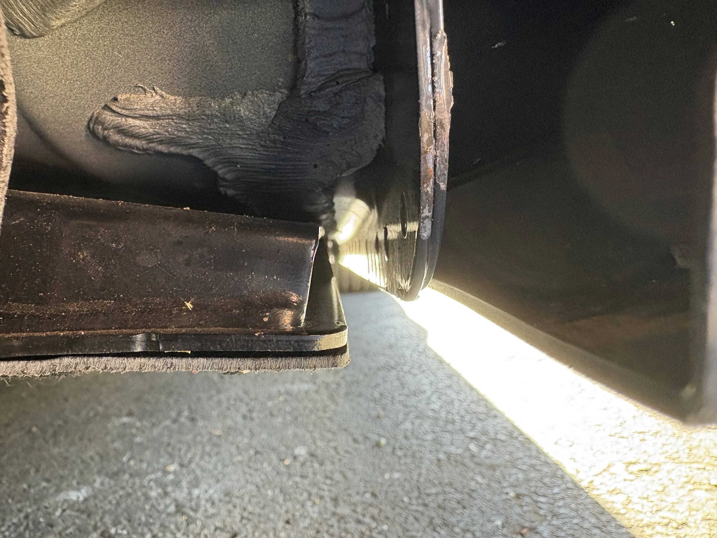

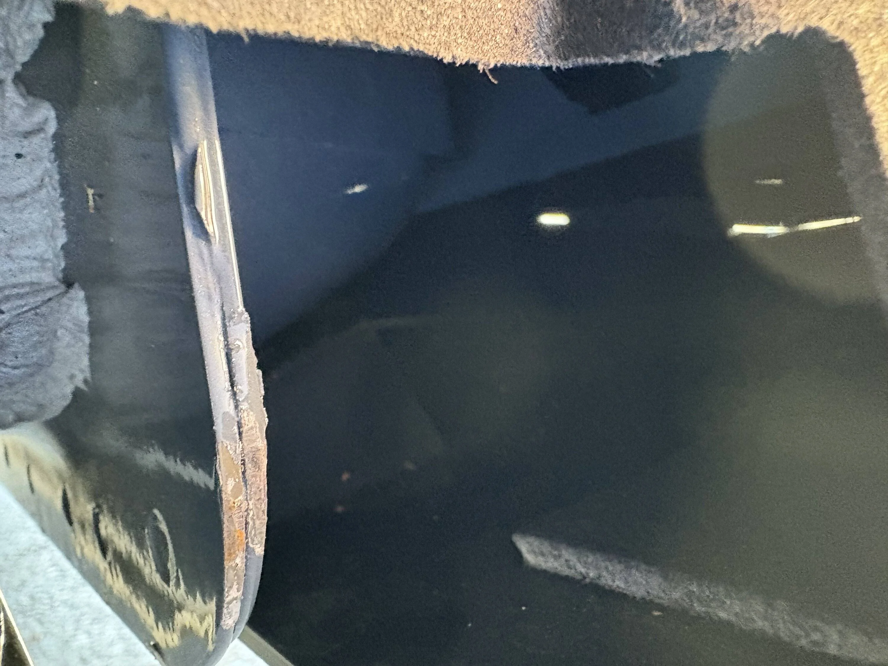

The following pictures are taken from my car, thru the inner front fender hole. I took these pictures just before I cover the holes. At the time the car had 26 miles on it, mostly highway from dealer to home. I have hard time believing my driving caused this. I see rust on a 1 day old car.
I'm interested to know your thoughts.

Since the holes in the fender liners were to aid the production assembly process at Flatrock I would say those scuffs on the pinch weld edges were made at the factory. I suggest a light sanding on the edge and then use the factory touch up paint 2 coats.

@bimmerborn .....mine was like that that after a few hundred miles but a local Mustang group member had that at 30 miles +/-. I looked at a new DH at a local dealership on purpose with a flashlight and it did not have that damage. Discussions with guys at local Mustang meets about the issue - some said no damage at all when they picked their cars up (then put tape or stuffed socks/rags into the holes until they got home and ordered their kits) some didn't look until they saw the Tony Unica posts and found chips and rust and many, like me, found a ton of stones and gravel all over the place under the belly and side pans then sanded cleaned, primed and painted the front curved pinch welds and K frame areas then installed the covers from DIYvan.com. You don't have your drive far for stones/road debris to be fired at that front pinch weld and K frame as they hit with a pretty significant velocity. That Ford has made this error is human but for Ford to not issue a warning to dealers and particularly owners of new vehicles is IMO dirtbag behavior. As far as I know Ford has still not publicly acknowledged this or warned dealers/owners. I have been buying Fords since the 70's and have dropped a lot of coin in their pockets. I was real pi$$ed at Ford when I got my new 2024 Mustang GT Premium home and found the damage I did. Ford monitors forums and Tony posted his video as did others all over - I bet a wad that Ford knew this real soon after the first 2024s were delivered. At no point has Ford (I asked) or anyone said this was to aid production/assembly. Looking at the area no one has said there was any need for these areas to be open and guys who have studied Ford assembly line videos can't see any need. BUT - if it was indeed necessary why has Ford been silent for a year. IMO - shameful!
