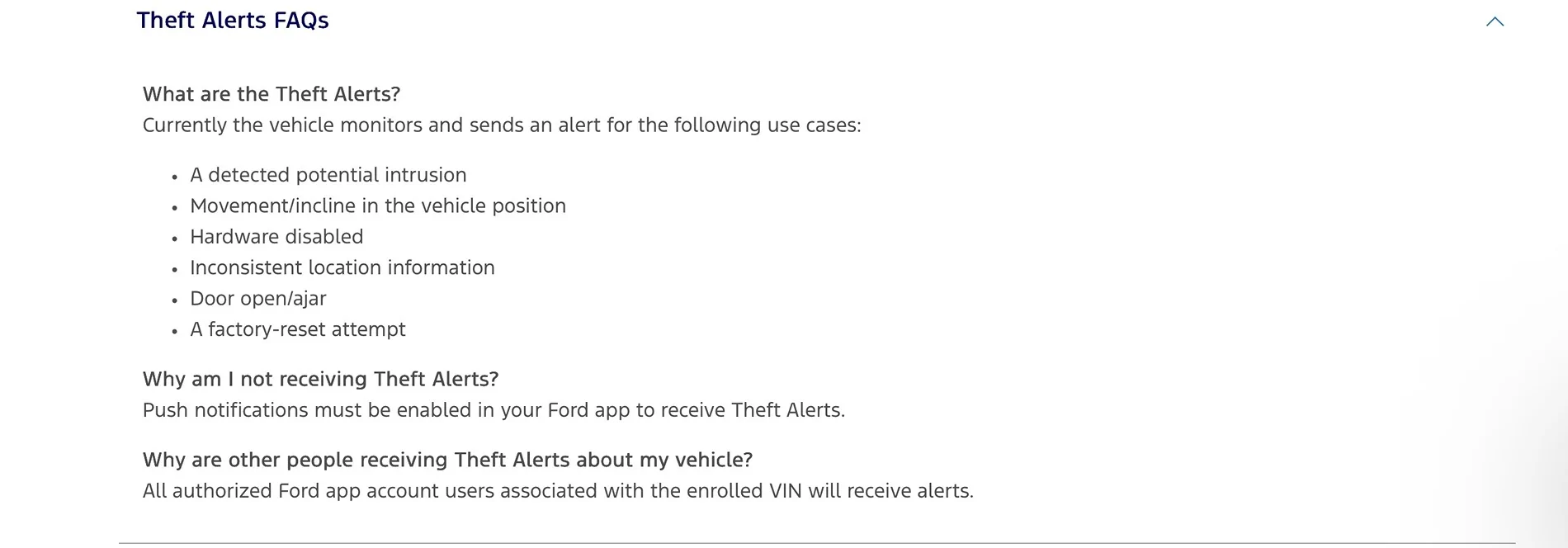

Sure, you don’t get the lockable center console without the package, but I’m wondering if there might be a way to enable the enhanced security features anyway. Ford is slowly rolling out a new subscription service called “Ford Secure.” According to the description, if you pay monthly you can get an enhanced perimeter alarm, and it specifically mentions motion detection.
I’ll include a picture below of what I’m talking about.
They haven’t rolled it out to the Mustang yet—first it was trucks, then the Expedition—but every week I see more vehicles being added to the list that can enroll. So maybe it’s coming to Mustangs soon?

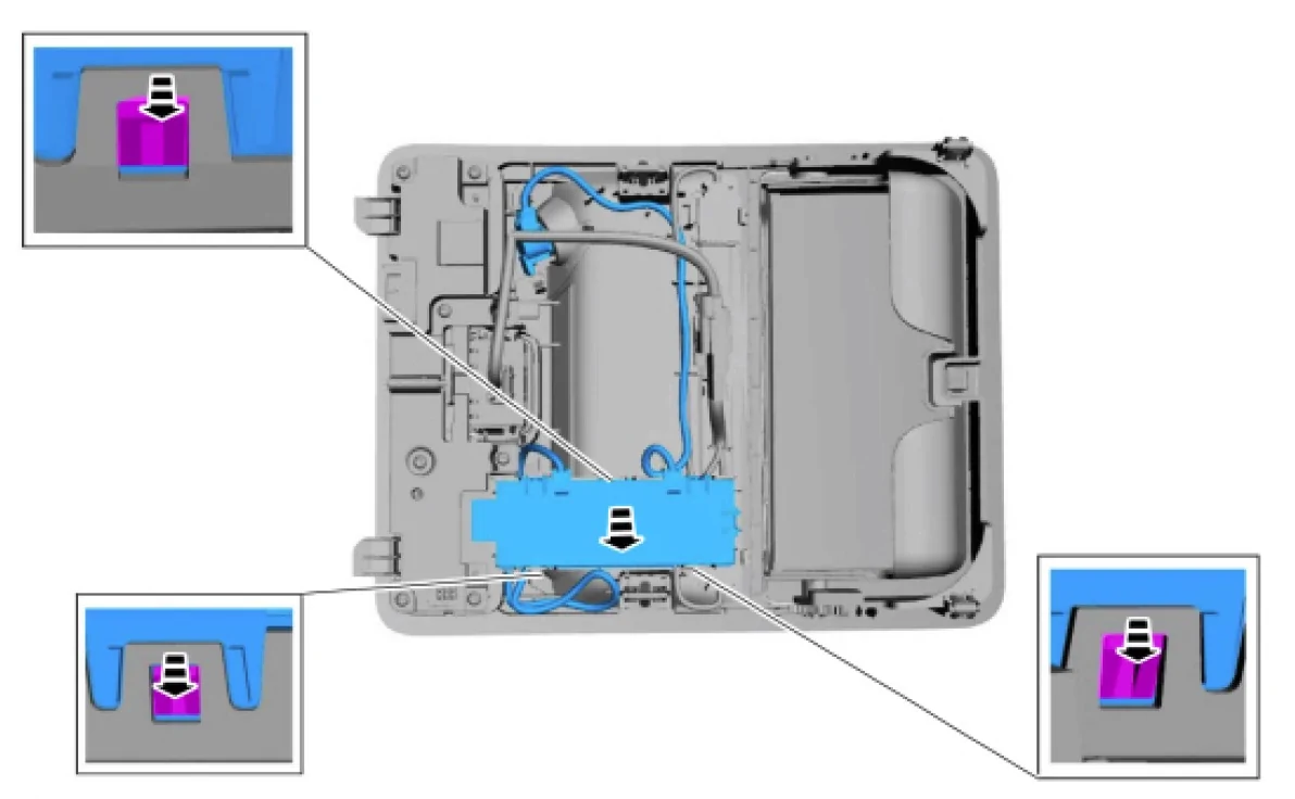

The dome may look the same but they are not. They have different part numbers. I found this out on the S550.

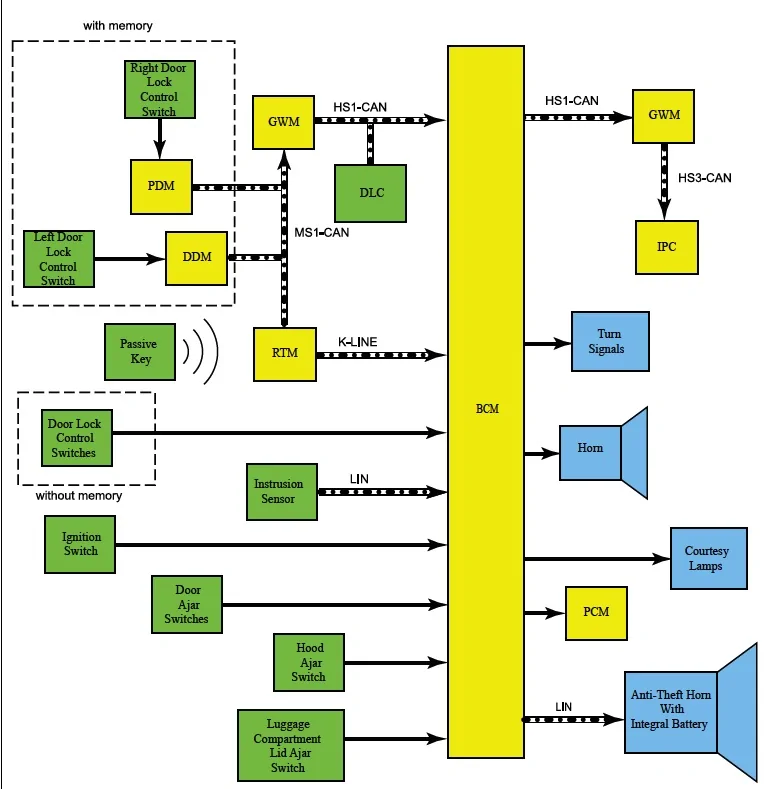

Here is a picture of the intrusion module that has to be installed in the overhead console. Inside the module is also integrated inclination sensor and the module communicates over the "LIN" bus to the BCM module. Not sure if the cable harness to the console has the connector for it in a vehicle that does not have the enhanced security option.

What if you buy the module would it work?

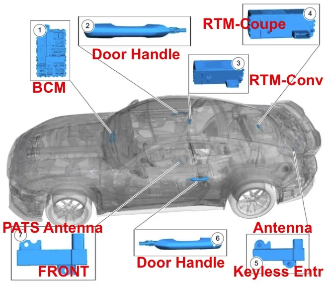

Assuming that you have the wiring in the upper console for the module you could buy it, but my best guess is that programming will be required to work with your vehicle network. The PATS components in your car would have to work with the new module. Attached is the network diagram and picture of the PATS system in the vehicle for reference.
