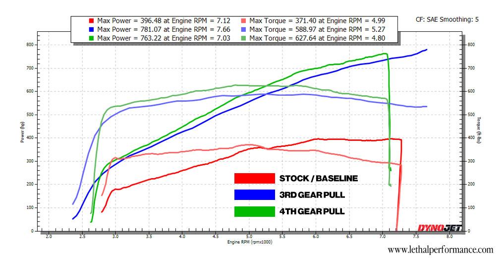

The dyno results are in on our Whipple Supercharged 2024 Mustang GT ....for now!
It's what you have all been waiting for (some more patiently than others...)!
We put our Whipple Supercharged Mustang GT on the dyno over at Palm Beach Dyno to see what numbers it would make... and it did NOT disappoint!
This is a 6-speed 2024 Mustang GT using the Whipple calibration on 93 octane. We installed a Stage 2 Whipple Supercharger kit with the Gen 6 3.0L supercharger and are using the 3.75" pulley, which is what comes standard in the kit. We also have a set of Kooks Longtube headers, a Corsa HH-pipe, an RXT clutch and a QA1 carbon fiber driveshaft.
We did run into an issue of hitting a limiter at 7100rpm which is set by Ford on all manual transmission 2024 Mustangs (including the Dark Horse) so we didn't get a full RPM run. This same issue happened with our stock baseline runs. We did do a full pull in 3rd gear, which did not hit a limiter, and it made 781rwhp! On average, the 4th gear numbers were about 20-30hp more than 3rd gear so we wonder if fixing the limiter will present us with an 800+rwhp number.
Remember this is on the stock Whipple calibration, stock 3.75" pulley and 93 octane!

But Whipple is working on a limiter fix! However the numbers so far are more than promising and you would not be hitting 7100rpm in 4th gear while going down the track in this setup.... which means it's time to hit the drag strip!
