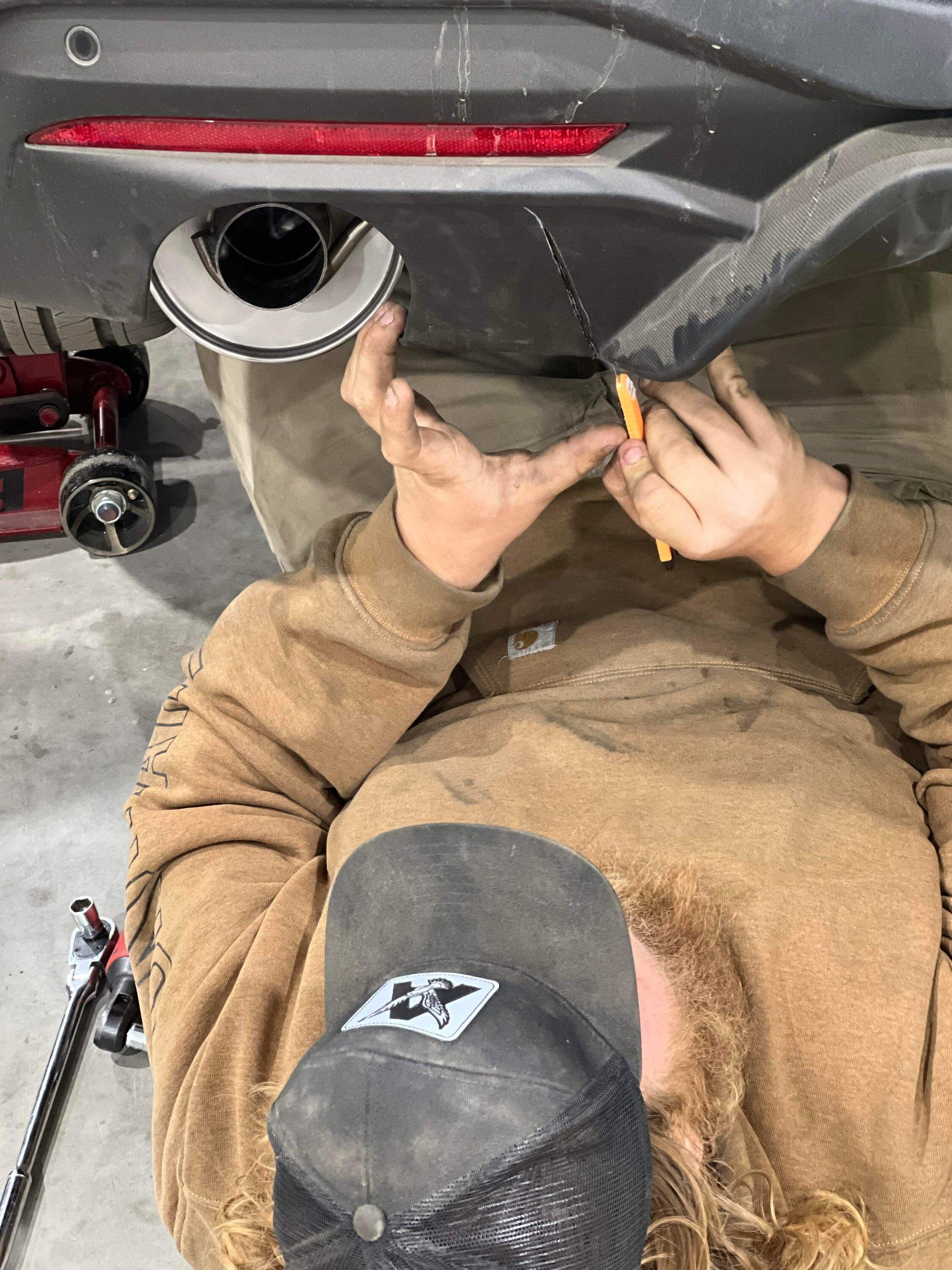

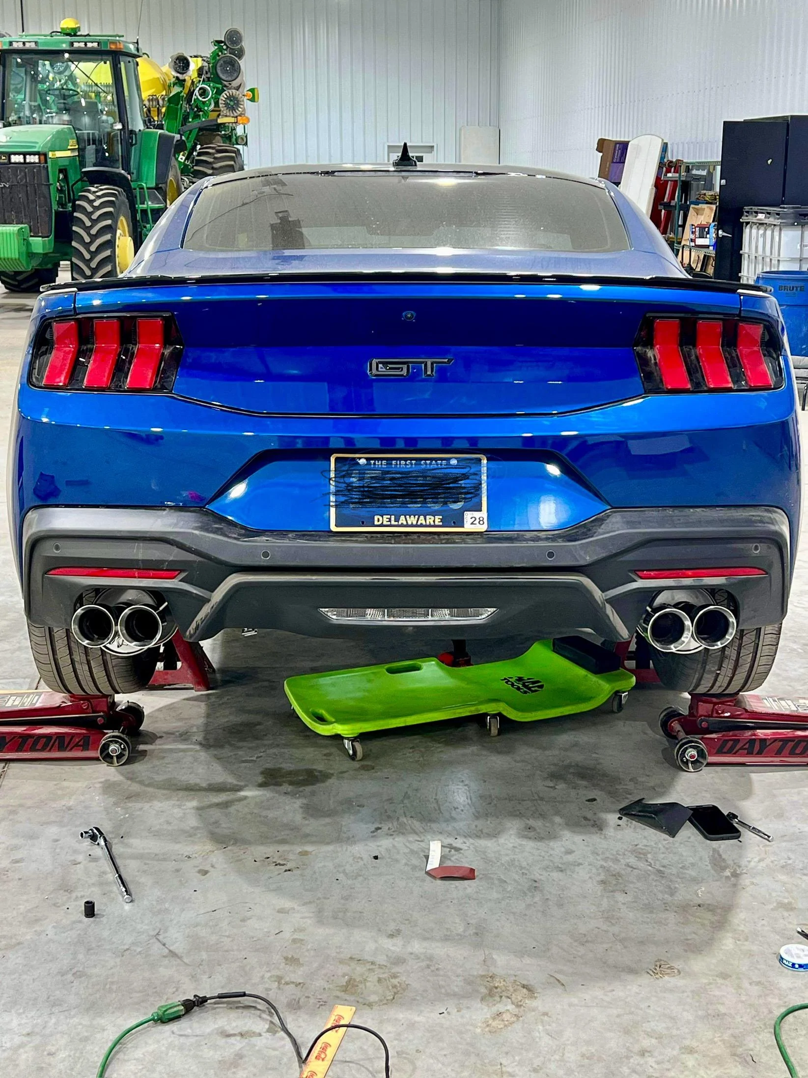

My nephew went from dual to quad exhaust. We cut out the openings and smoothed them. Can't even tell.
Looks pretty good. Do you have close up pictures where the cuts were made? What was your process for smoothing out the plastic after it was cut?
Just cut carefully with a cut off wheel then file to make the shape you want. Then smooth out with some fine emory paper.

Plan to do this to my Dual tip GT, when I buy my Quad tip mufflers... no sense in buying the $400+ lower valance when u can snip it and sand it to look nice!
