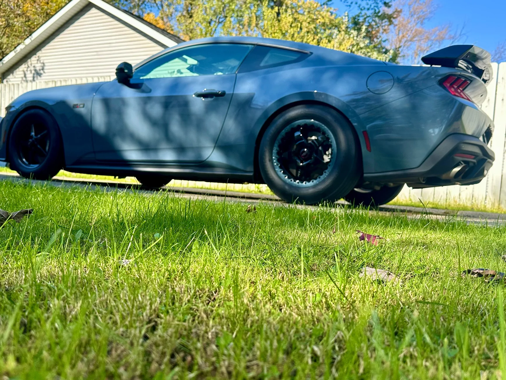

What's up guys I need a bit of help on getting a drag pack setup.
I was looking at 17x10 but don't understand the offset stuff. I have a 19GT if that helps any.
If y'all got any pictures of y'all's setup and specs that'd help me out a lot. Camber and toe adjusts too if possible thanks!

Base model brakes are required for 17s
normal backspace is 6.5 on a 17x10
this is 17x10 with a 28/11.5/17 lowered on steeda progressives

Did you get an alignment? What's the specs for the camber? What's the tire size?

Nope, put the springs on it, lidio had a post about a zero rear camber alignment for drag specific setups…
I just bolted and went, you also need to make sure there are no balancer weights inside the wheel.
I run bias plys so no balancing either.
