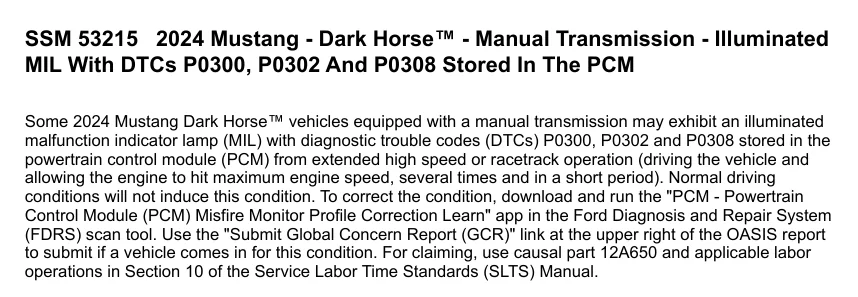

I found this technical service bulletin SSM 53215, so I carried out the ‘Forscan Misfire Monitor Profile Correction Learn’ procedure. I haven’t had a chance to check yet whether it helped, but I’m wondering if there’s a PCM update related to this issue? As far as I know, the tuner hasn’t altered the knock detection strategy.
