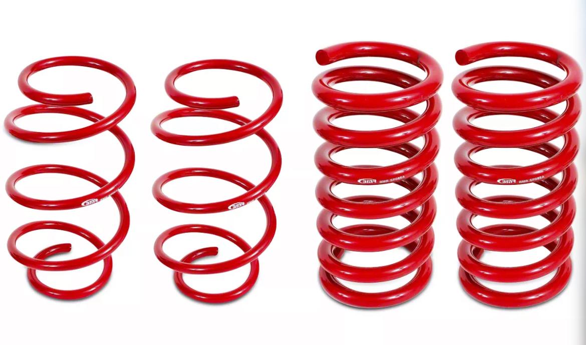

Of course you can cut them.
However the design of the spring doesn't always lend itself to cutting.
The spring on the left you can't really cut but the spring on the right you can.

Also most aftermarket spring companies will tell you to trim your spring to get the exact ride height for your application
