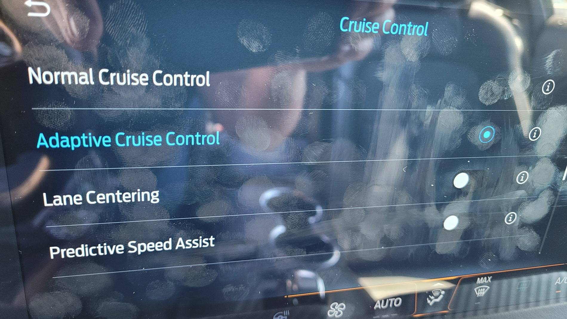

Ok, I think I solved the mystery.
It looks like the "predictive speed assist" function was turned on under the adaptive cruise control settings. Predictive speed assist can adjust your vehicle speed based on road geometry and speed limits provided by navigation WHILE USING CRUISE CONTROL.
This apparently, is a separate function of the "speed limiter" feature on the wheel which operates independently of cruise control but functions very similar. 🤦‍♂️
Yeesh Ford. That was a tough one to track down. Hopefully this fixes the issue.
