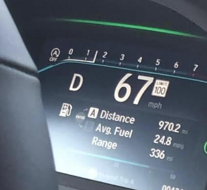

I'd agree with testing the speed sign recognition going past the same sign if possible. We discovered my wife's Honda would always mis-read a particular 65 sign near our house as 100. Even got a pic of it.
