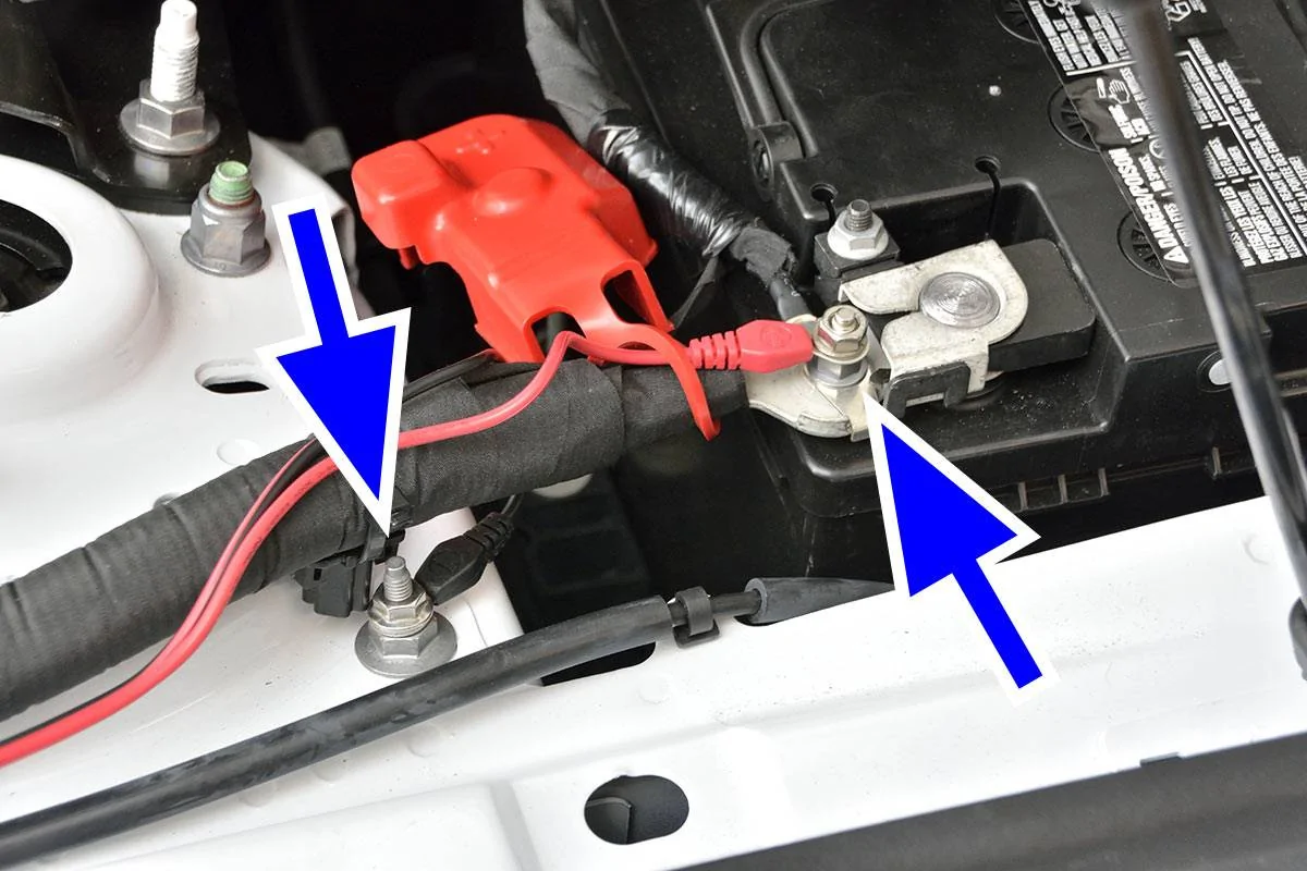

I use the stud that the red arrow points to in Bfets image for the negative lead of the charger. The positive lead goes on the positive pole of the battery. No problems. However you connect it, after 2 weeks you get a message on the Ford app to say that certain features have been disabled to preserve the battery. That's a fluke, the battery will be full and the car will start as if it ran the previous day. Enjoy your time away!

Is there a spot on the same side as the battery that I can safely use for negative?
Going away for 1 month and using a borrowed tender that doesn't have the reach required to connect to the negative stud near the fuse box.
If you are looking for something even closer than the charging stud, this point that @5.0ALM used should work well.
