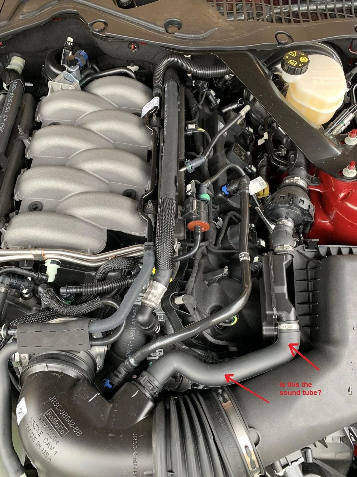

To put the GT bit to rest two things firstly simply starting the car and listening tells you the sound is coming from the exhaust side of the car
Secondly the GT had a sound tube pumping in noise (ignore the question I pulled this off google)

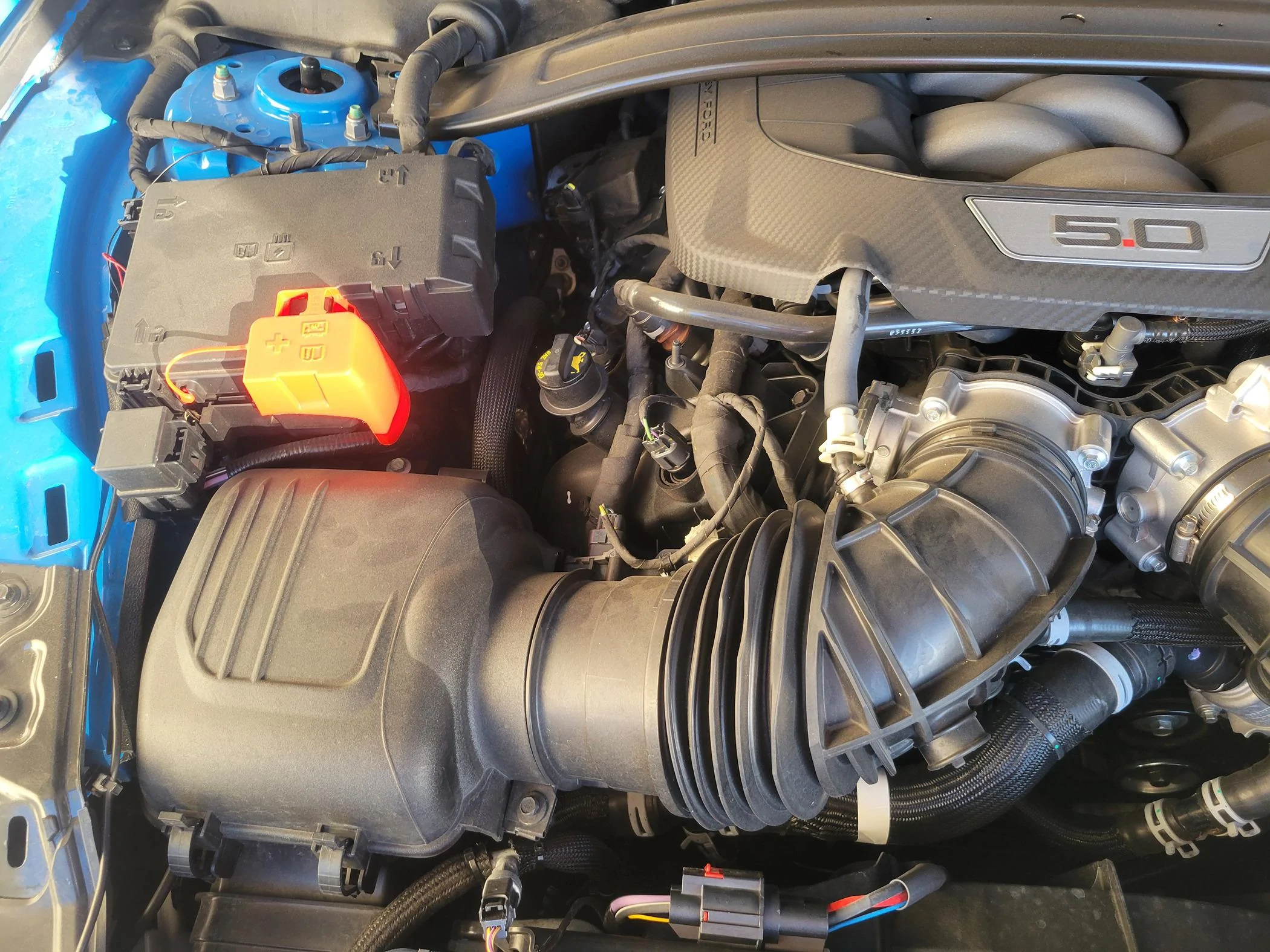

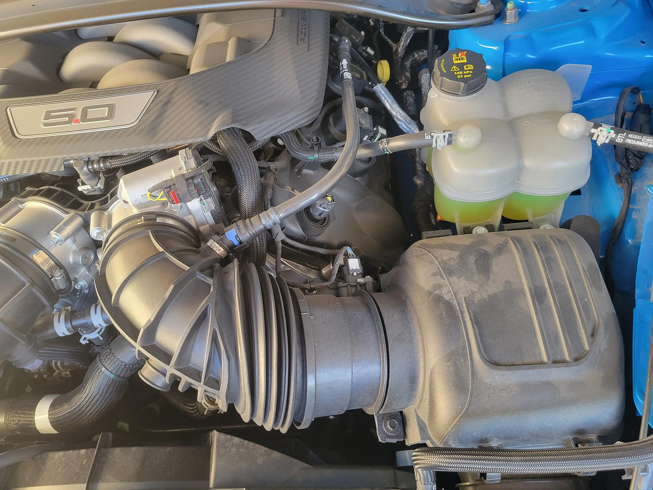

Meanwhile the 2024 has nothing on its intakes
S650 Mustang Can the piped in fake exhaust sound be silenced? 20240422_190823
S650 Mustang Can the piped in fake exhaust sound be silenced? 20240422_190819
So I can say that it definitely doesn't pump in audio like it used to.
