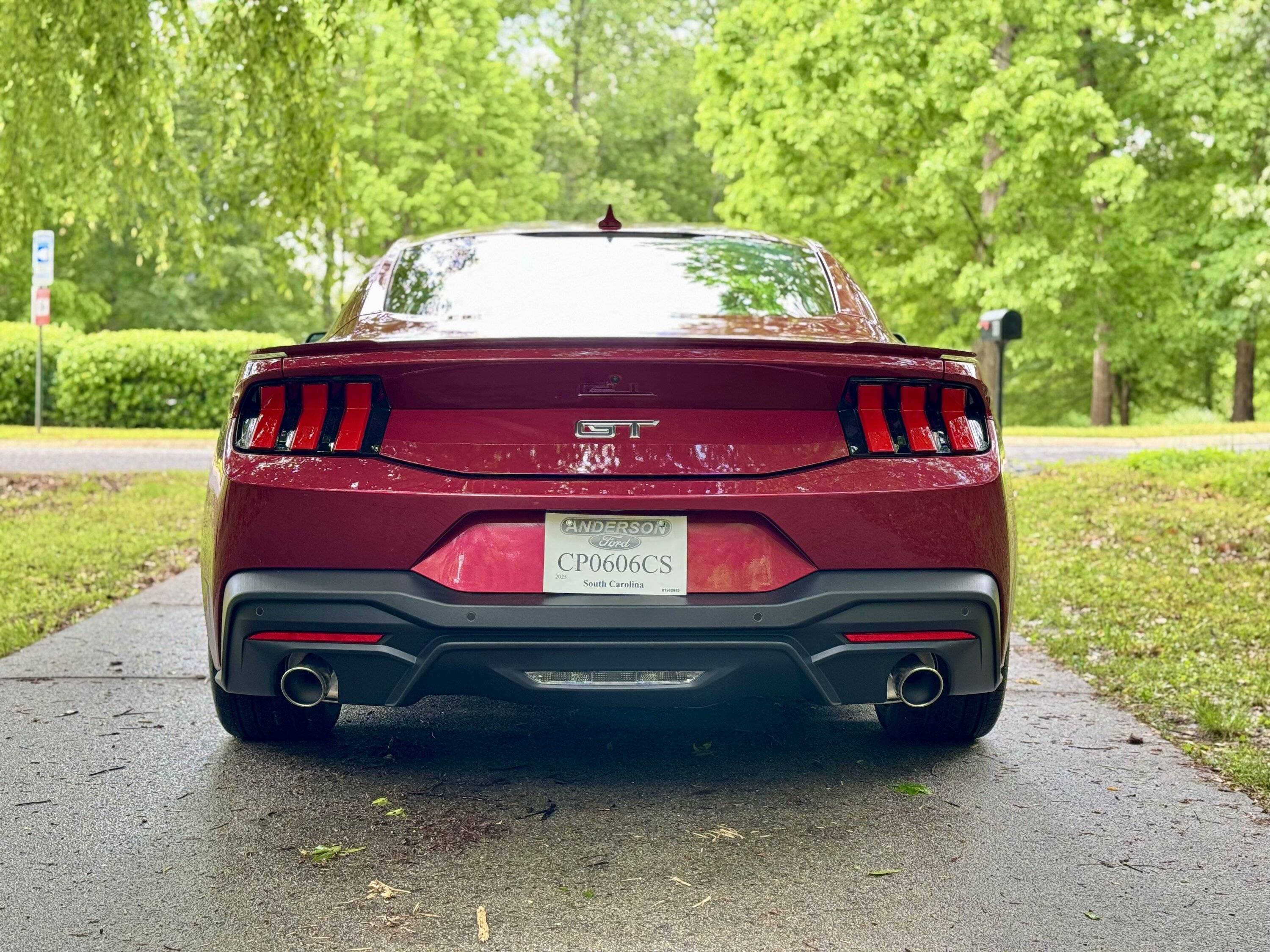

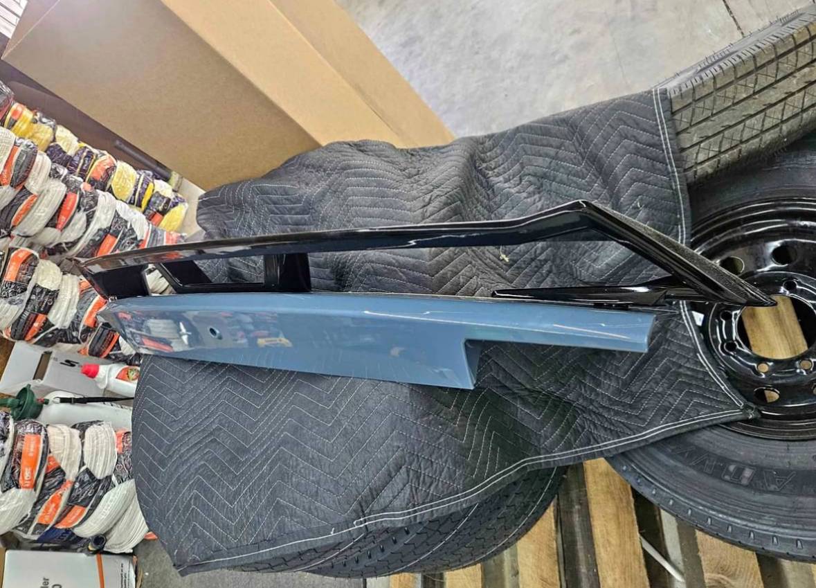

Someone is selling this. Was wondering if it could be removed from the blue lid and then remove whatever little spoiler is on mine, drill holes and install this one. Pics of the one for sale and my car for reference.

Yes, it can be removed and installed on your Mustang. I would assume you would have to drill some holes. I missed that you have the blade spoiler which means you should have the holes already. Should be a fairly easy removal and install. You will have some adhesive to remove when you take your spoiler off. Also, you would need some 3m adhesive or like when installing.
FYI - It appears that spoiler has either been removed before or the owner installed it without adhesive. I can see between the underside and the panel in the photo. That would make removal easier. I would ask for a few more photos to verify no major scratches unless you plan on painting it. I would leave as is.

I put the pp spoiler on my grabber blue car and painted it to match, and have had a ton of comments on it. I just don't like black stuff on cars unless they're also black

As you have a spoiler already it should bolt right up. You will need some 3M trim tape to install. If you want black get that one, if you want car color, check ebay as there are lots on there and can get in that color.

IF you have the blade spoiler it will bolt right up. Holes are all the same for the 24+ spoilers, pp, dh, dhpp spoiler.
