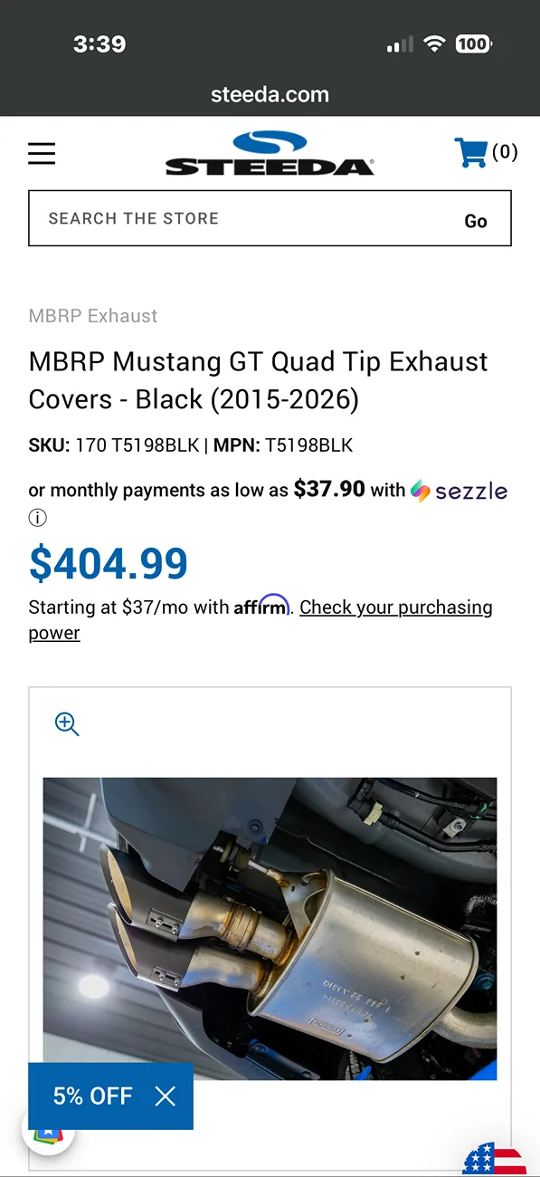

I wonder if these will fit over the stock tips …? I reached out to Steeda waiting for an answer -
jboogie1289
Dec 10, 2023
549
454
Friendswood Texas, 77546
If I'm not mistaken, I think the DH comes with 5" Tips and the GT's have 4" Tips. Double check that though .....

2,681
4,067
the DH also has a slightly different way the tips are mounted, similar to how the S550 GT500 and Mach 1 were. putting on tips for a GT will have it conflict with the diffuser

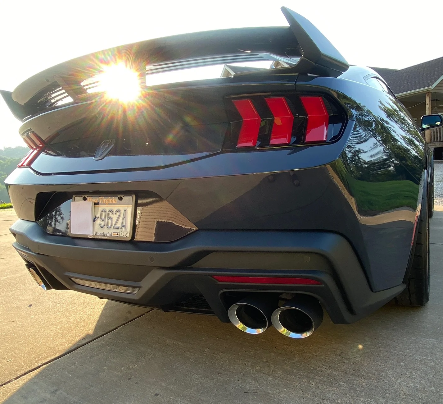

DHGOOD
Apr 19, 2025
66
73
West Virginia
2024 Mustang DH HP Premium, 2025 Mustang GT Premium, 2019 SuperDuty 6.2L 4x4

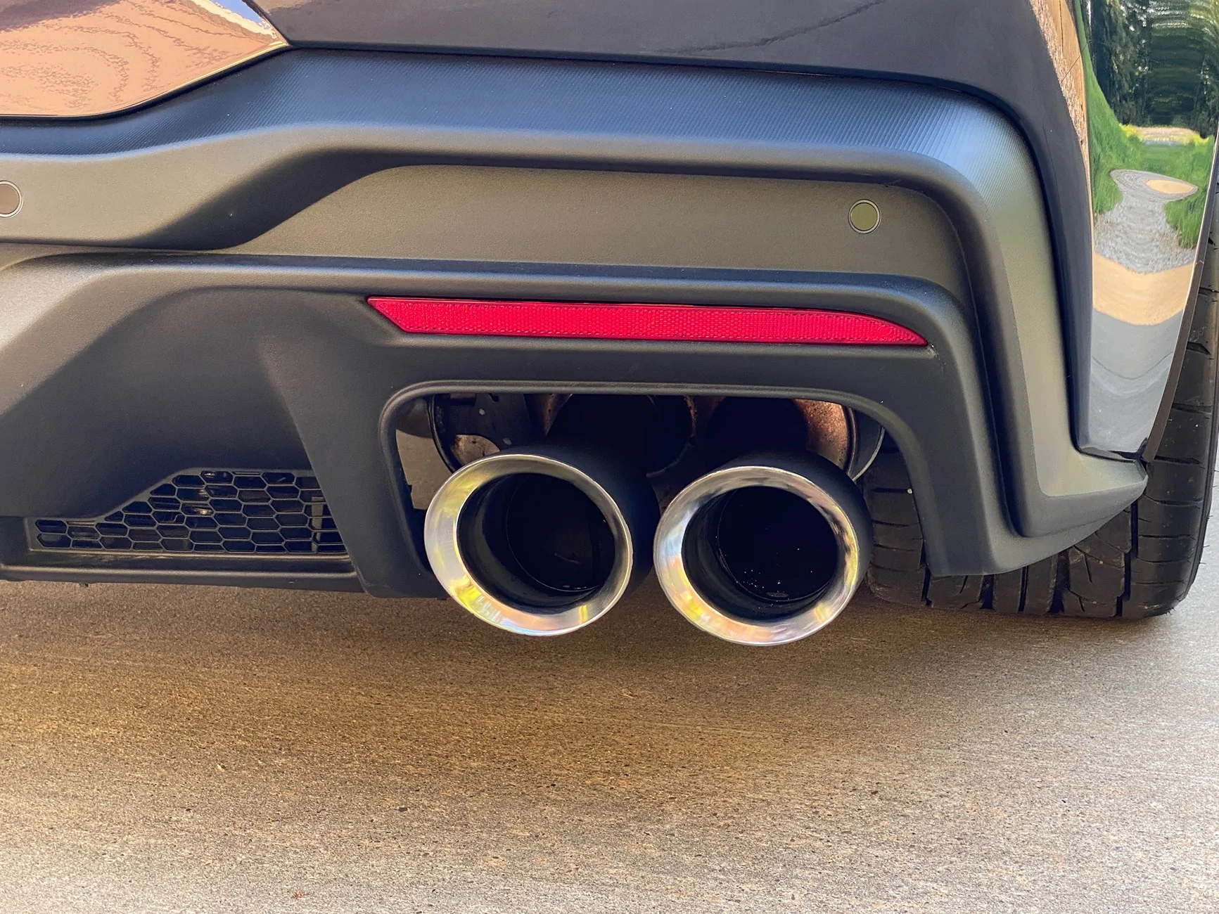

The paint wipes off with brake cleaner. The tips are stainless under the paint and are easy to polish. I did just the inner rings and painted the outer black again with VHT.
