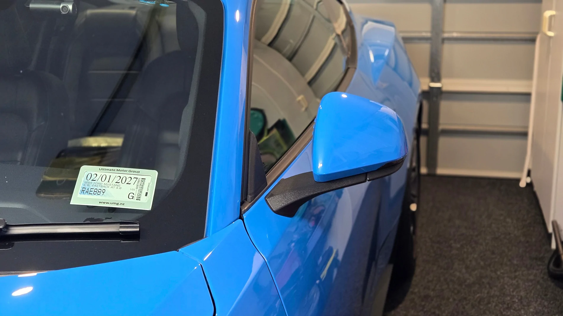

This is a Standard US Shape Side Mirror Housing. Yours appears to have more of a Triangular Peak on the Inboard Side while the US has more of a Rectangular Parallel Top and Bottom.

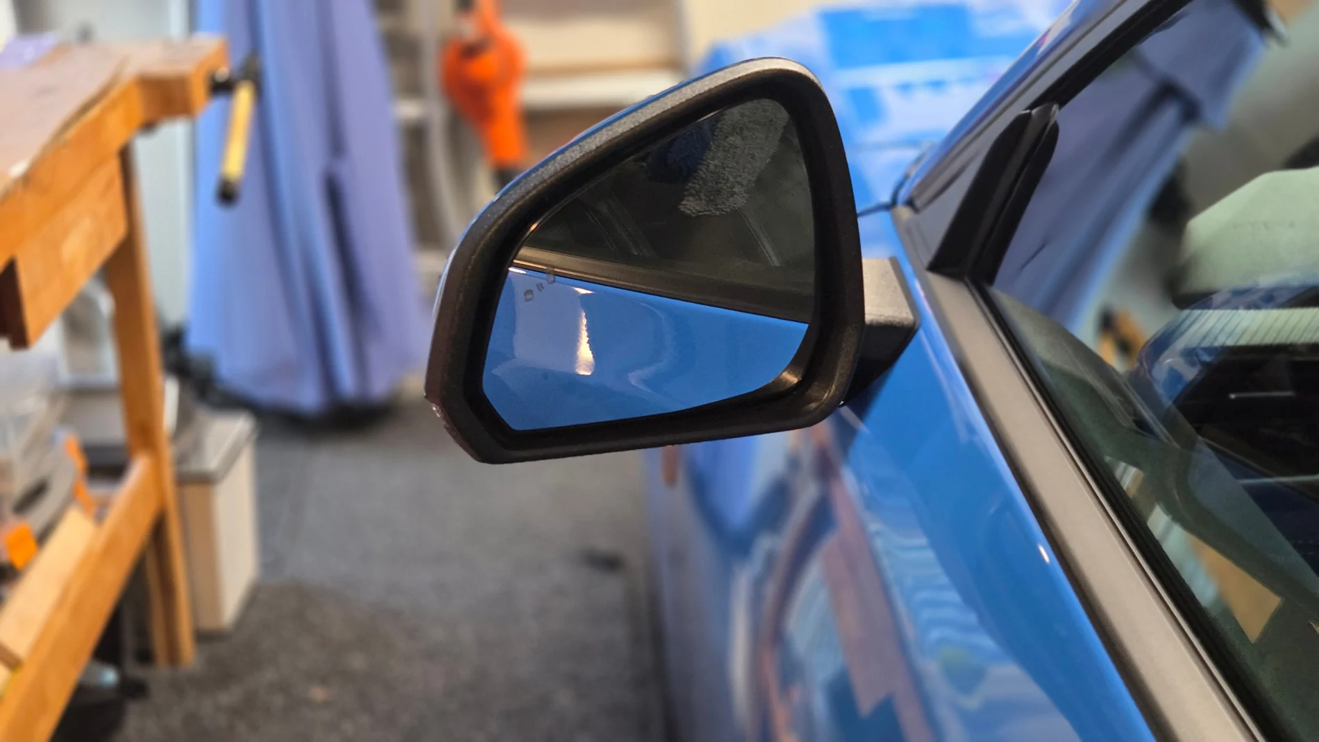

70cm wide? And 45cm high?
I know the EU mirrors are bigger but..
You know how big that is? Almost as big as your wheels 🤣
S650 Mustang Auto fold side mirror option.... Screenshot_20260519_094440_Gallery
Here is my mirror.
