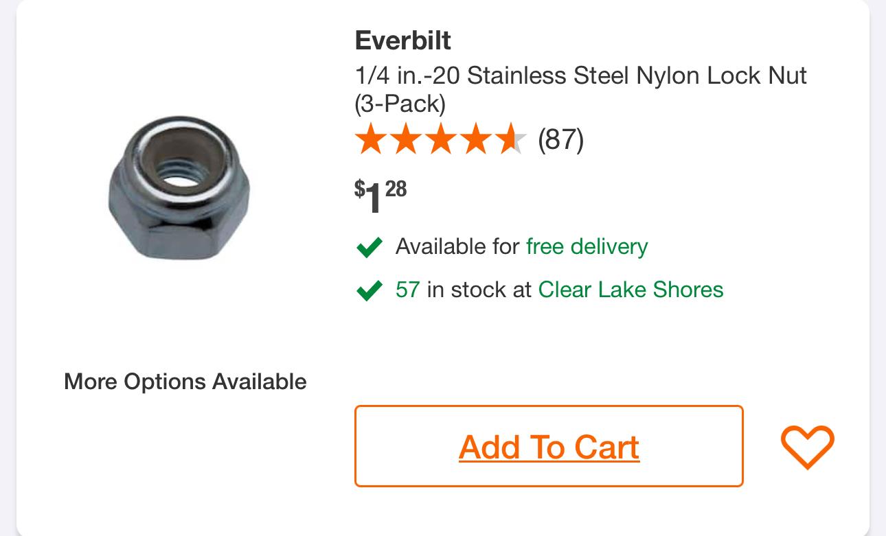

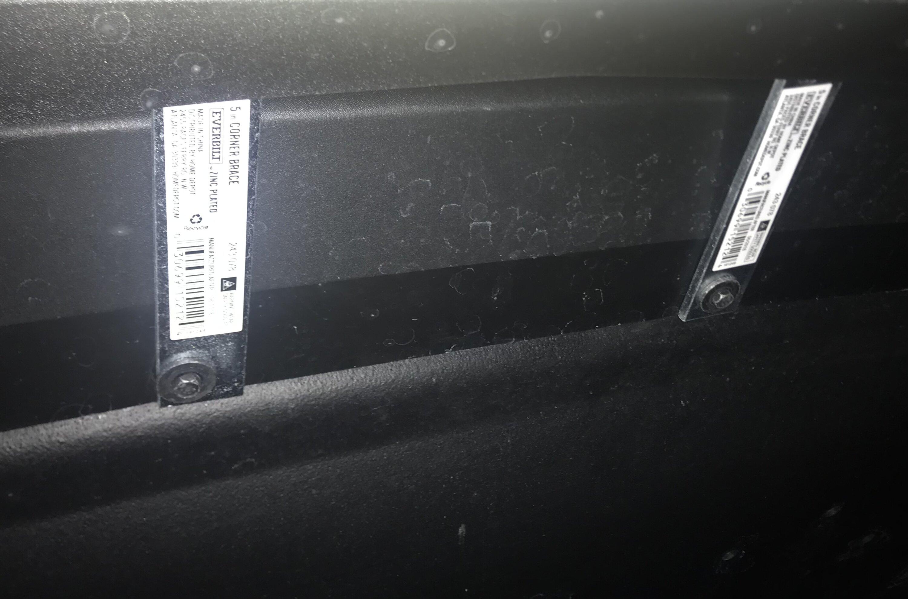

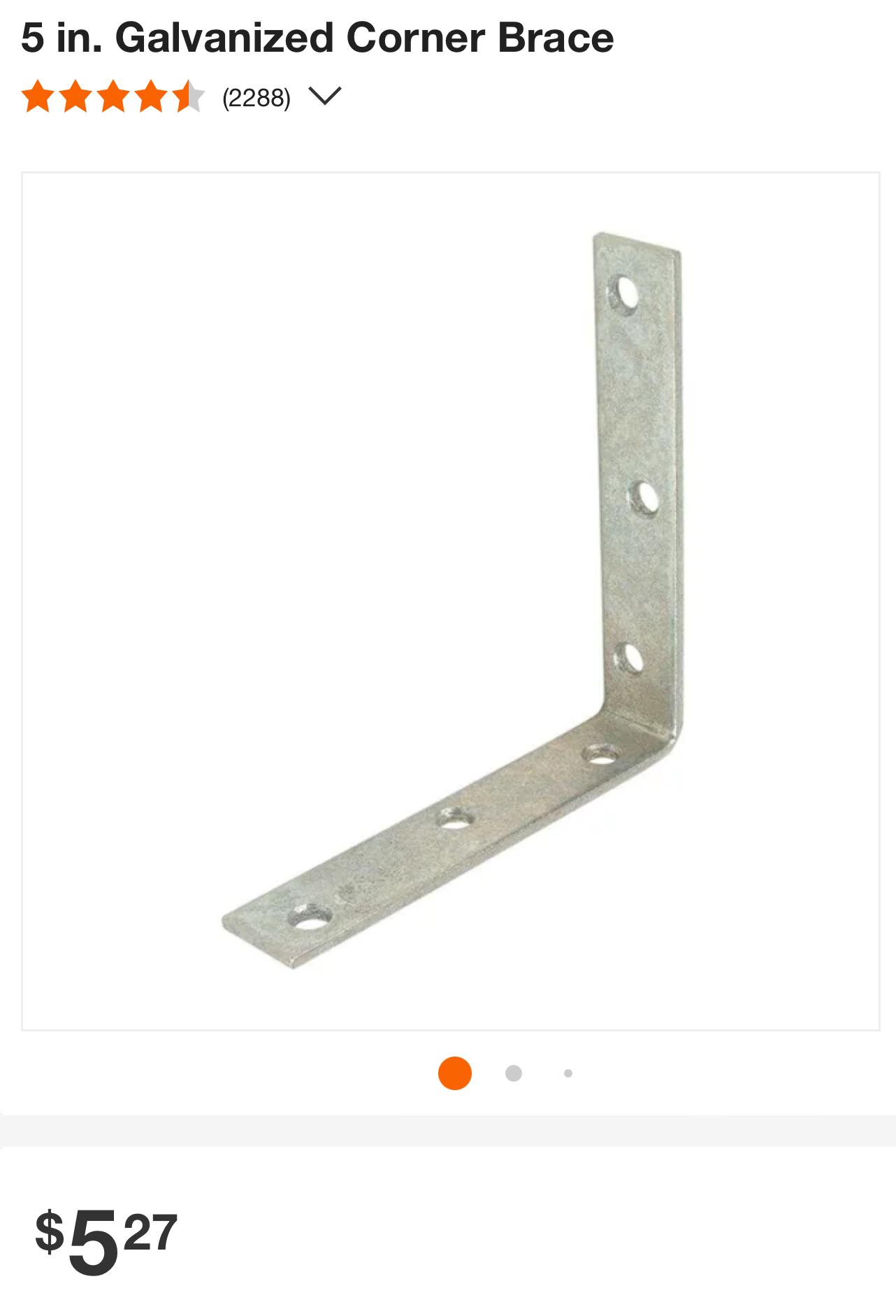

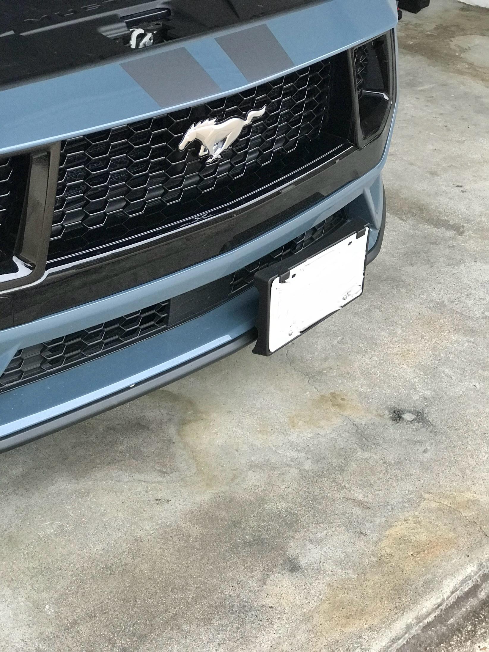

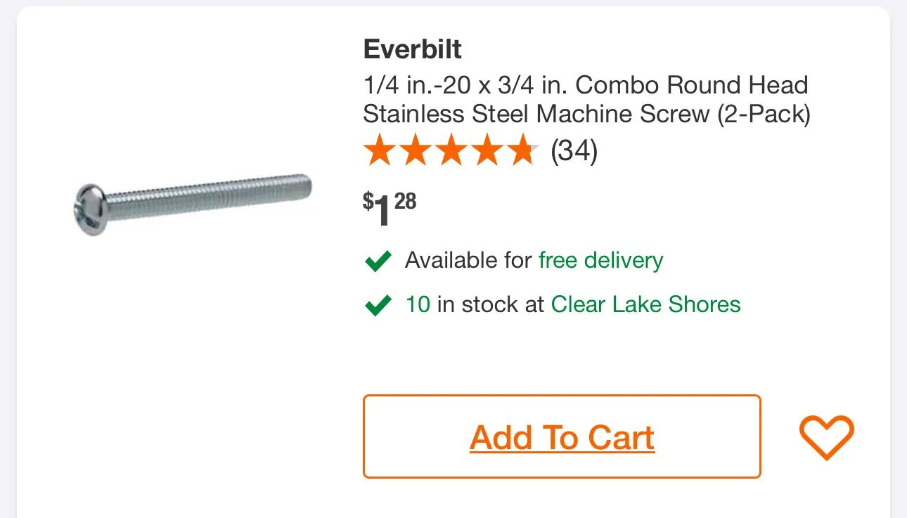

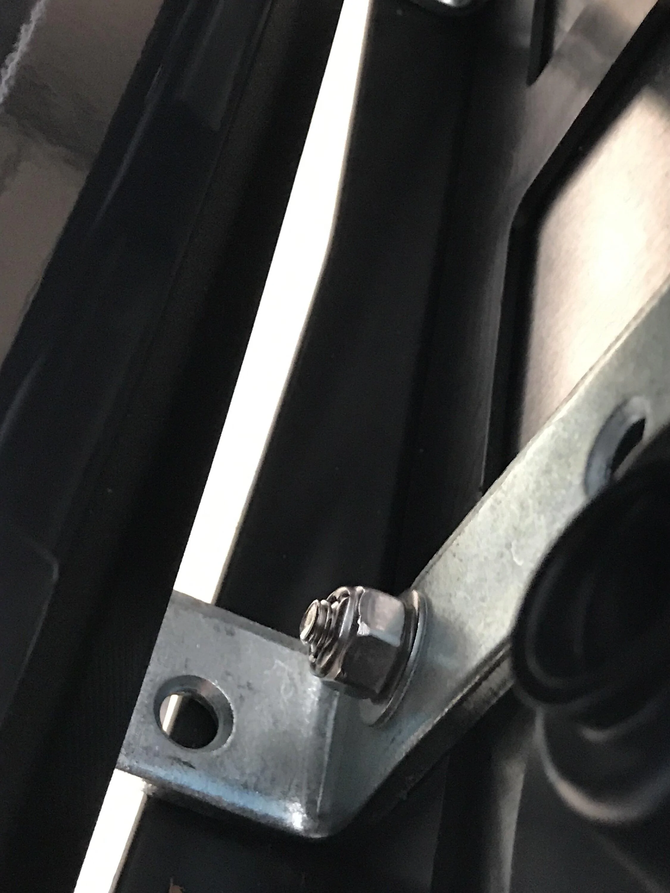

Done …and yes some cars have the 360 adaptive cruise but mine don’t so no sensor in the center grill .:. Yes bracket can be relocated anywhere on front ..and yes it’s Texas State trooper approved ..follow my images and you’ll figure it out ..lol

Done …and yes some cars have the 360 adaptive cruise but mine don’t so no sensor in the center grill .:. Yes bracket can relocated anywhere on front ..and yes it’s Texas State trooper approved ..follow my images and you’ll figure it out ..lol
looks good

Do check your state though, this is not legal in all states. I did the 5" L-brackets, and it works great. I'd post a pick, my baby is in the shop with a water leak. :-(

You need to have the Toe Hook receiver, which is not included on all builds. From what I can figure, and this not confirmed by FORD, that only the Perf Pack builds get the receiver. Check behind the square cutout before you invest in any Toe Hook License Plate holder.
This is corrrect. PP and DH are the only ones who actually have a tow hook mount behind the little plastic piece. I made my own mount behind that plastic piece. My pics are 1 or 2 pages back.
