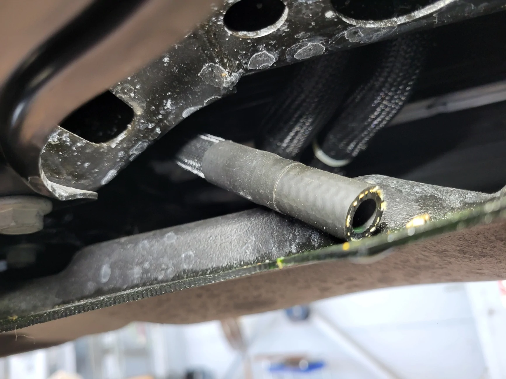

I did an oil change at just over 1k miles and noticed coolant on the top part of the underbelly tray. Looked up and found what I assume is an overflow hose. I also noticed dried coolant around the coolant reservoir. Maybe an overheat or overflow. Nothing on the dash though. Stage 1 whipple installed.
S650 Mustang Antifreeze Smell 1000019395
