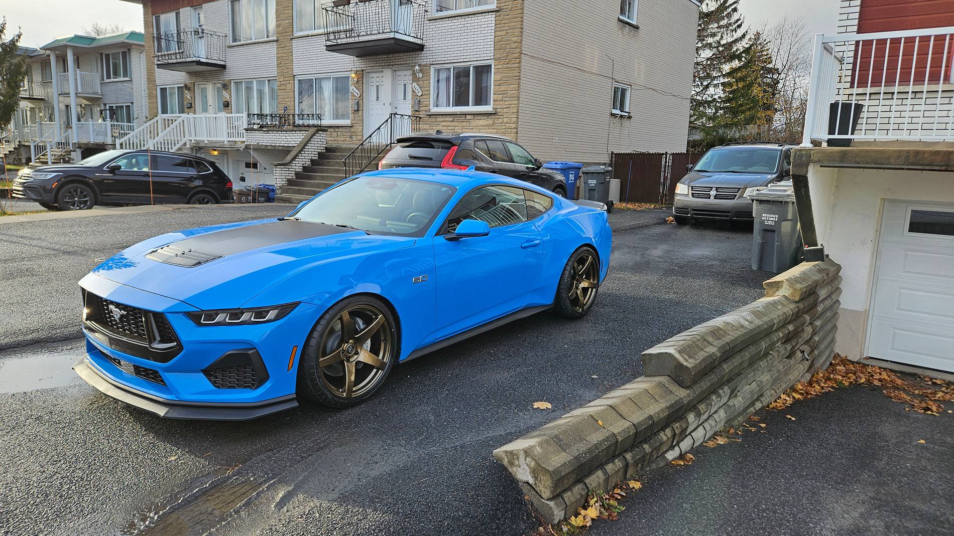

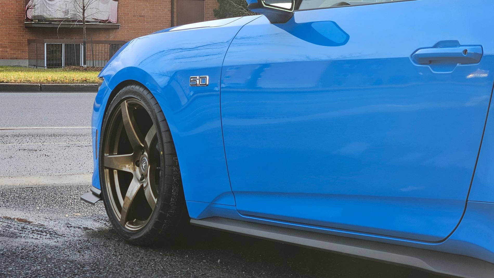

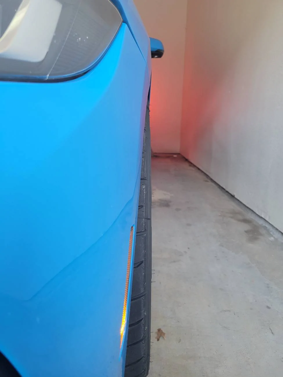

20X10 wrapped in 285/35s
S650 Mustang 20x10 vs 20x9.5 with 275/35R20 20240420_135117
S650 Mustang 20x10 vs 20x9.5 with 275/35R20 20240423_193151
The rears are 20x11 so ignore those

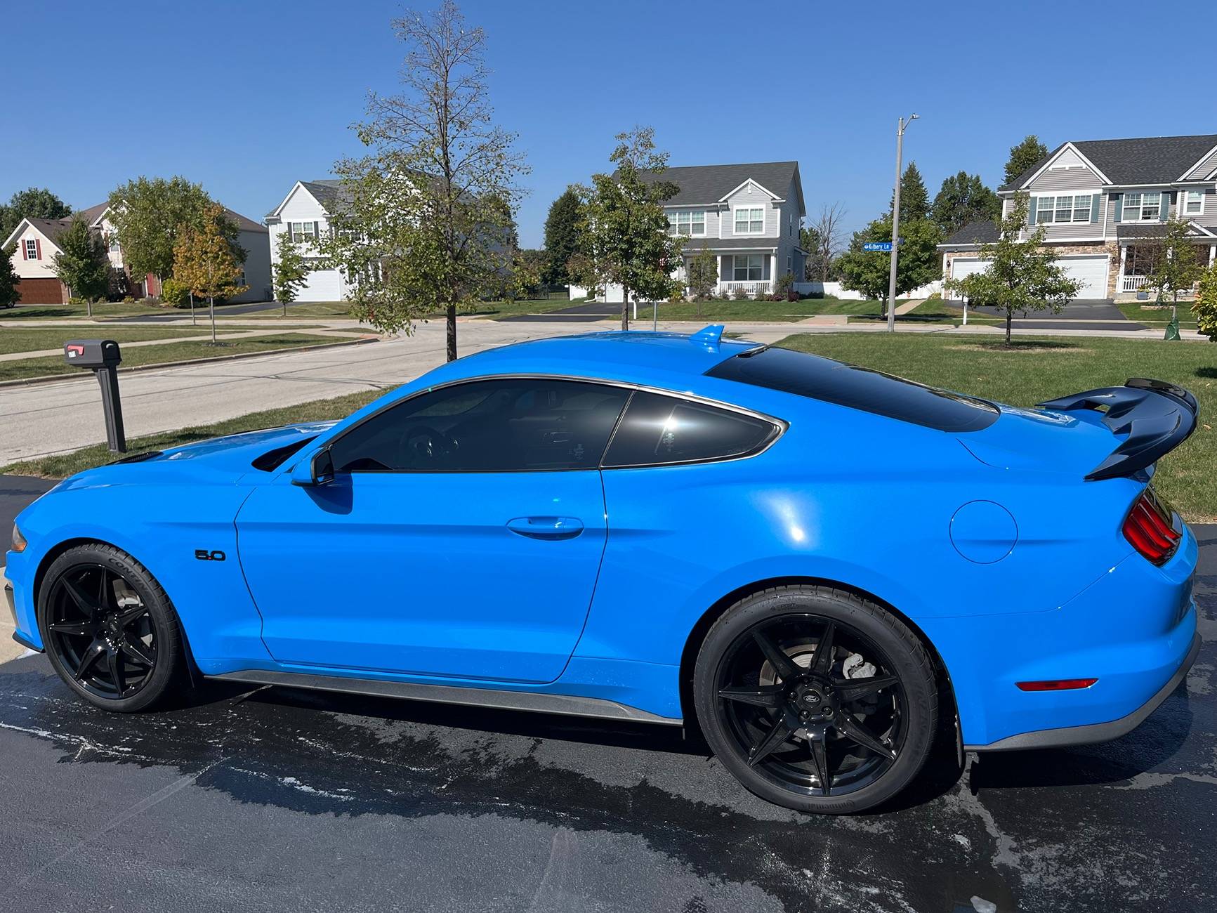

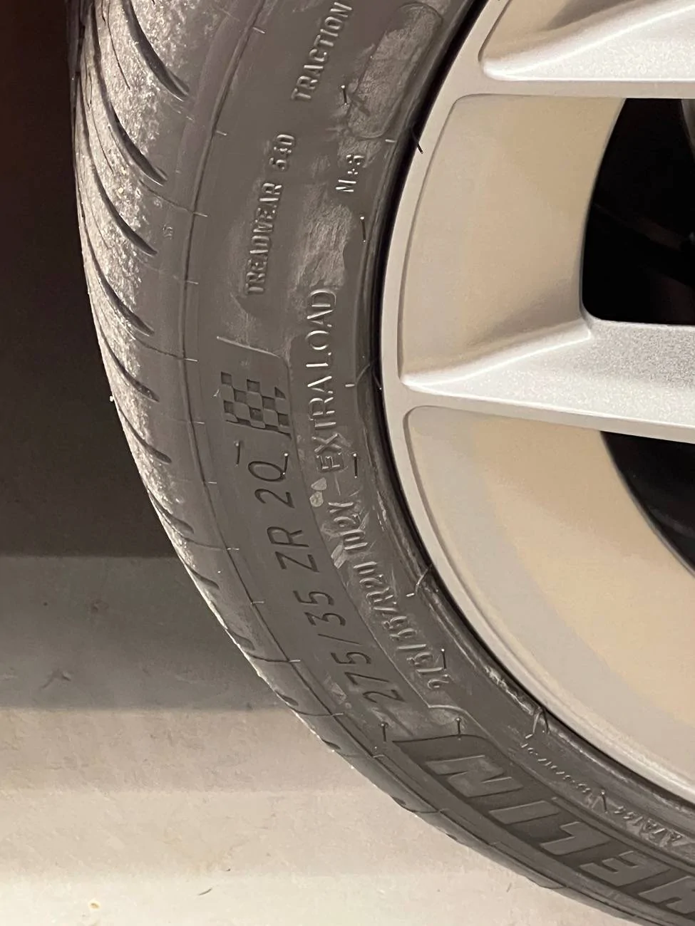

I know it’s not an S650, but I run 285/35/20 on 20x10 squares in summer. Stock tires are 235/50/18. 3% rule is pretty good IMO, but honestly 3.3% isn’t making a huge difference. If you want to run 275’s, a 9.5” wide wheel is ideal for most tires

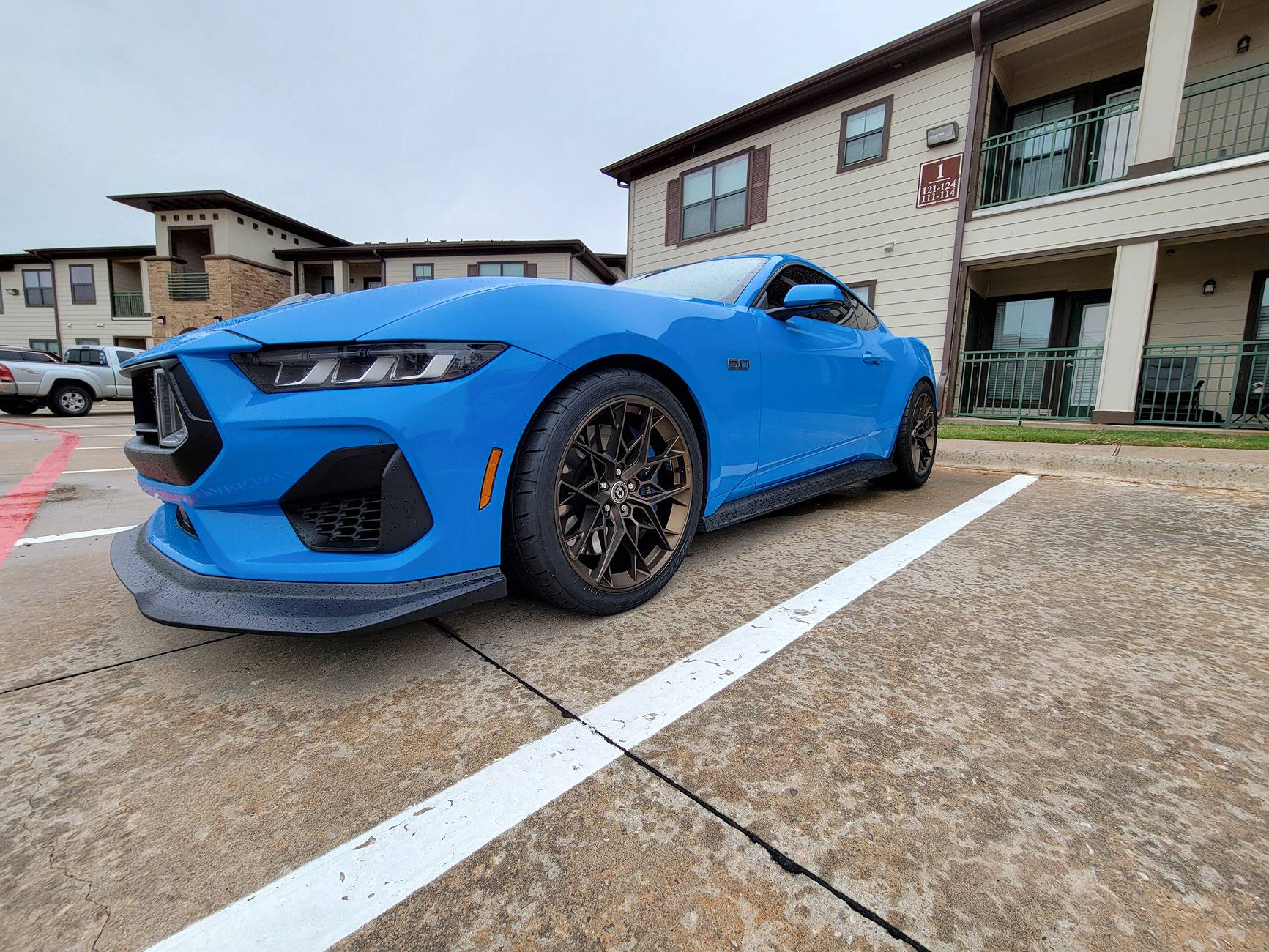

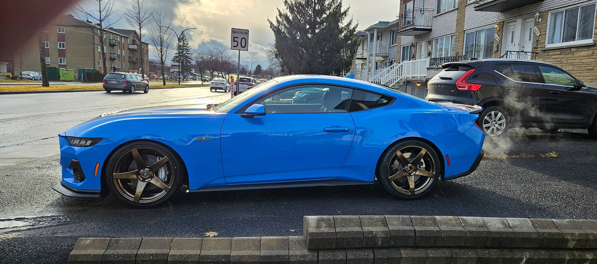

I have a staggered set up on mine and run a 20 x 9.5 +33 wheel on the front with a 275 35 20 and I like the way it looks. Here’s some pics to give you an idea what to expect.
S650 Mustang 20x10 vs 20x9.5 with 275/35R20 IMG_0234
S650 Mustang 20x10 vs 20x9.5 with 275/35R20 IMG_0235
S650 Mustang 20x10 vs 20x9.5 with 275/35R20 IMG_0236
