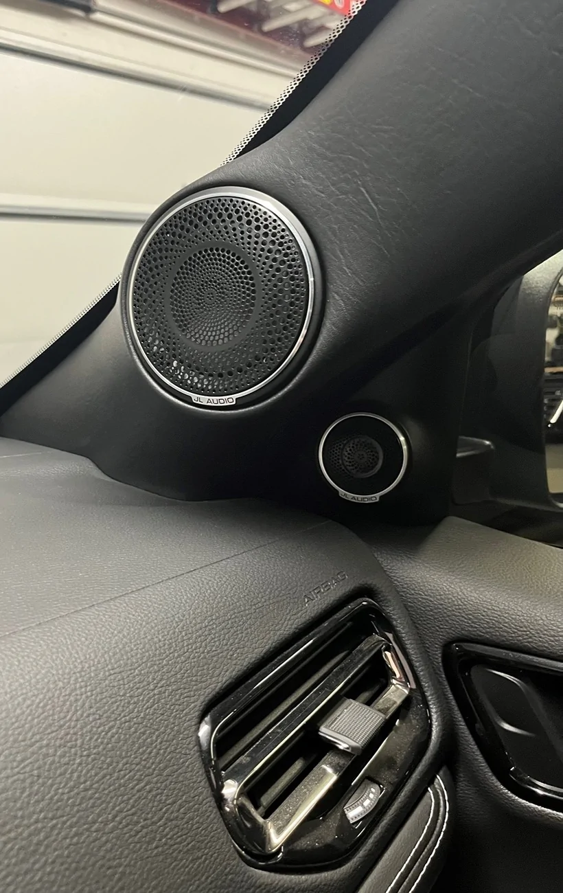

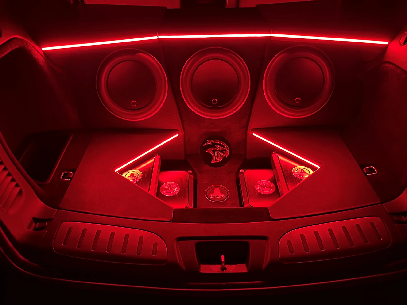

I compete in IASCA Sound Quality and have a 26' Mustang that just got built yesterday. Should be here in a month I would guess. Needless to say, I'm WAY into car Audio (have been since 1990).
If you have the B&O, the first thing you need is a PAC Audio Amp Pro (the iDataLink Maestro doesn't work with the B&O, but will with the 9 speaker). This takes all of the time alignment, crossover points, all pass filters, etc out of the signal and created a flat frequency response.
From there you can run 3 sets of preamp cables or the Toslink output to your new DSP or amp with built in DSP. I run both analog and the digital signal and create different presets.
This is my Durango Hellcat:

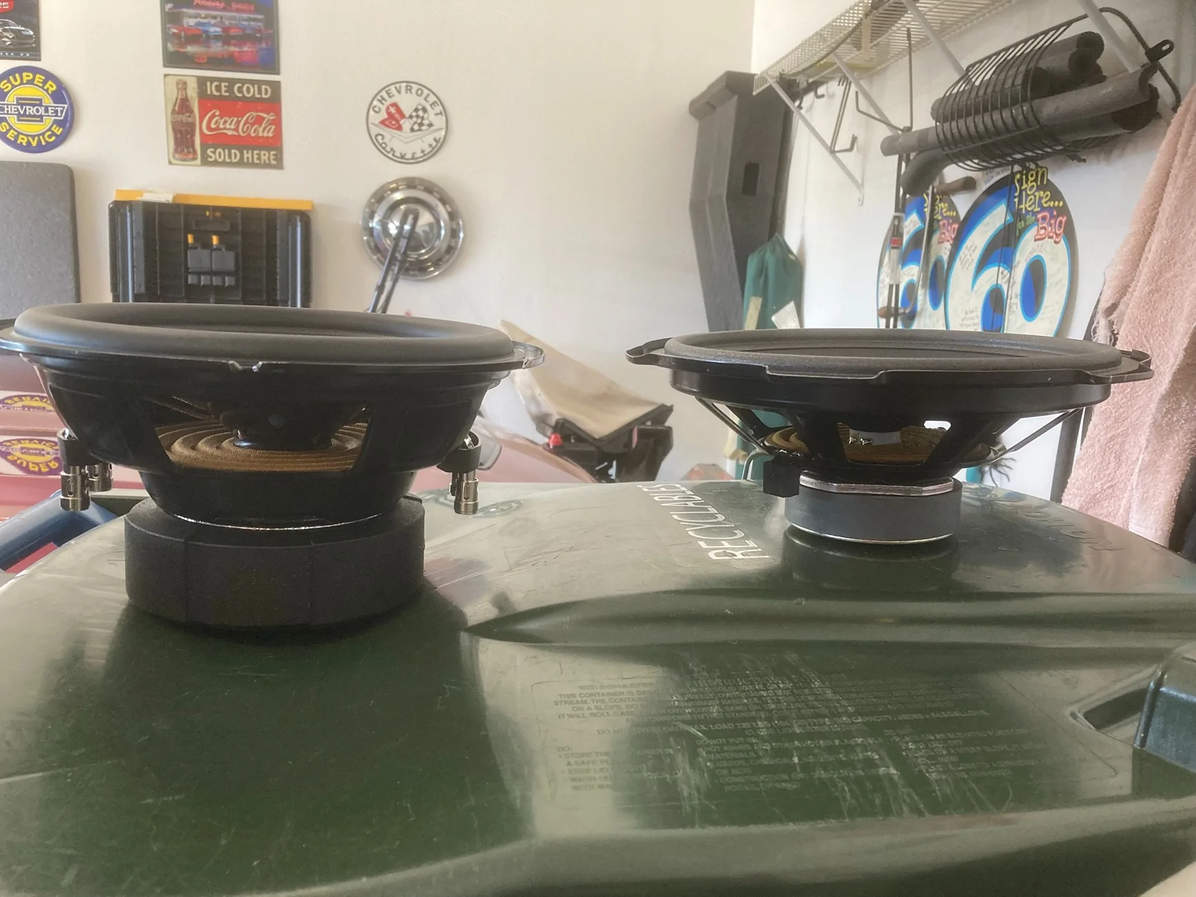

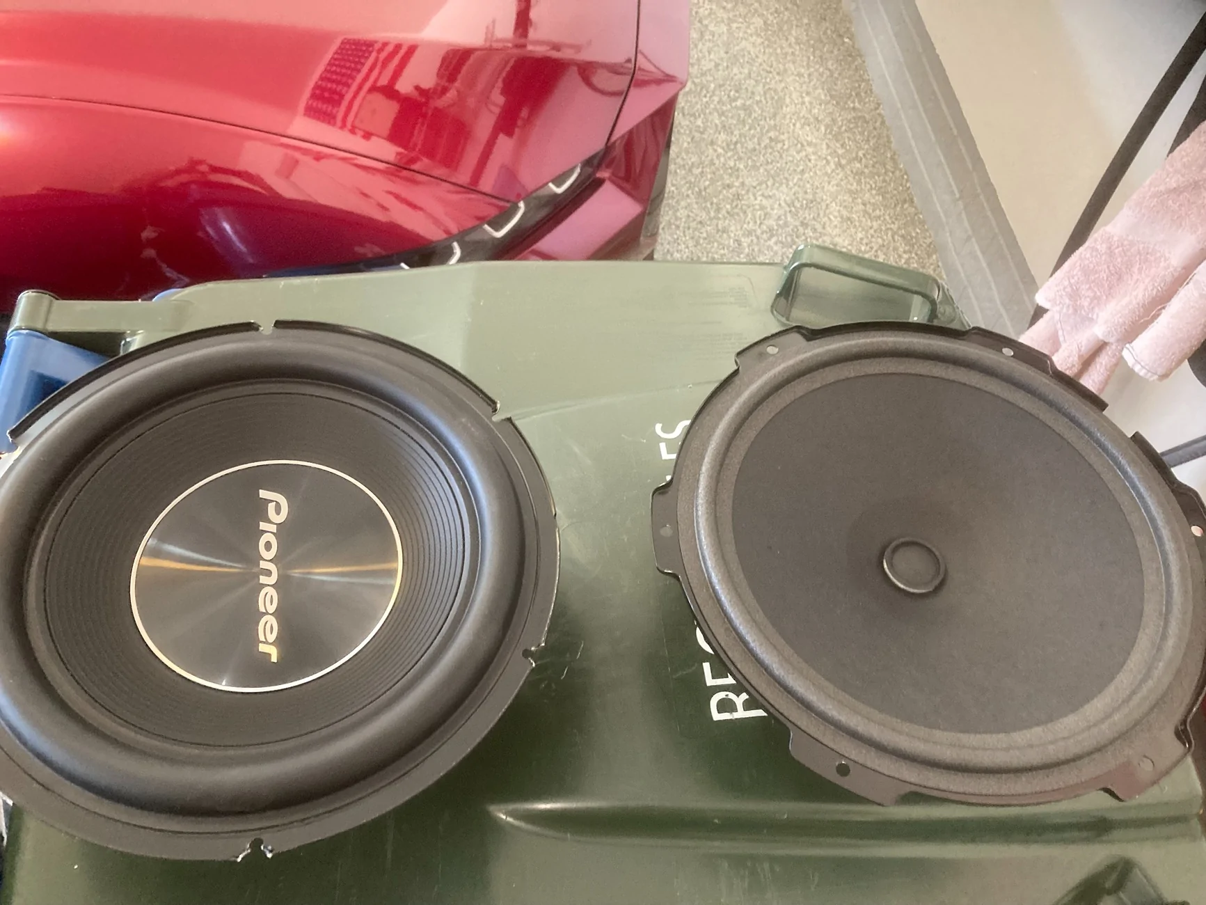

Not loud enough? It's just not good enough. You probably want a complete make over, but here's what I did given this system:
1. Replace the sub-woofer with a Pioneer TS-A250SDA 10 inch. I'm told it really can't support anything much stronger.
2. Replace both door mid-woofers with Focal 165AS.
You'll get limited returns from replacing the tweeters, mid-range, or rear parcel shelf speakers.
I owned a 9 speaker car system, too, Replacing anything other than the door mid-bass is a waste of money because the amp can't drive them.

Did you notice any significant difference considering the amount of worked put into replacing those speakers?
Absolutely. The sub alone is critical. The Focal add punch. I'm still disappointed in Ford in that you pay all that money for what amounts to an "upgradable system". The last generation Chargers and Challengers got it right. These have larger door speakers for starters.
