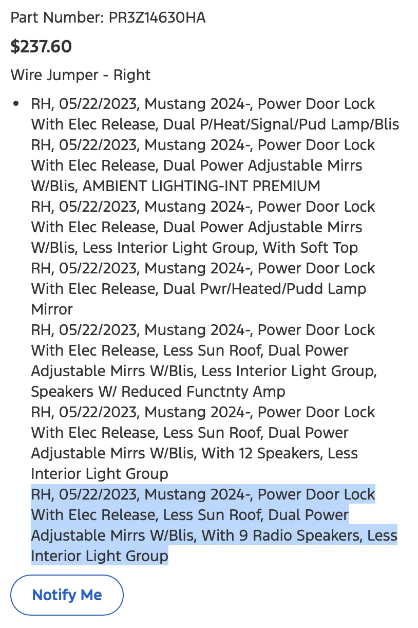

tsaoandy12
Feb 24, 2026
Maryland, US
From the diagram I have, it'd take a few hours per door. The main plug should be just inside the foot well of each door. Then you'd have to remove the door panel and start snaking the harness. Shouldn't be too hard, just takes time.
Still definitely on my list of wants.
I also have a 2025 Mustang that has 301A. I am looking at the part description and it looks like 301A already using the PR3Z-14630-HA and PR3Z-14630-KA harness since we have the 9 speakers. Am I miss something or miss understand it?
If I need the harness..... They are out of stock right now.... sad :crying:
