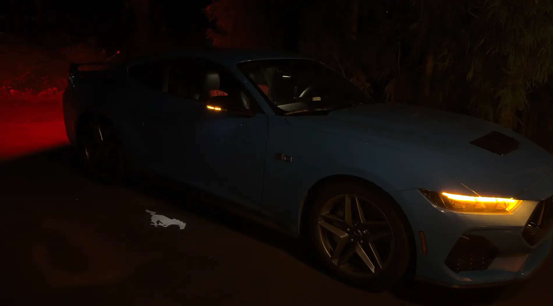

I post in the wrong section earlier in the Interior Mods.... Anyway....
I just installed premium mirrors with puddle lights, turn signals, and heating on my 2025 Mustang GT (301A), so I figured I’d share. Make sure you have the correct door harness before attempting this mod. Base Mustangs with the 6-speaker system will likely need a new door harness that includes the wiring and pins for these features. The Harness need for both doors are PR3Z-14630-HA and PR3Z-14630-KA.
The attachment PDF is my instruction and stuff that need to do the mod.
