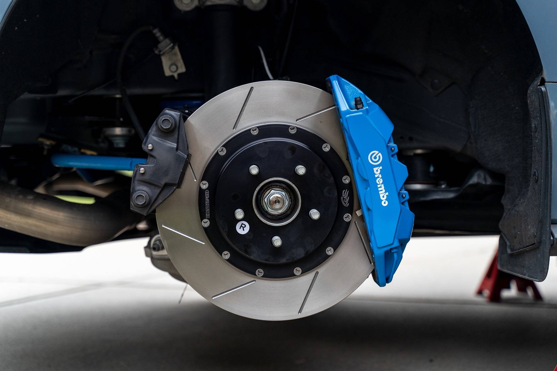

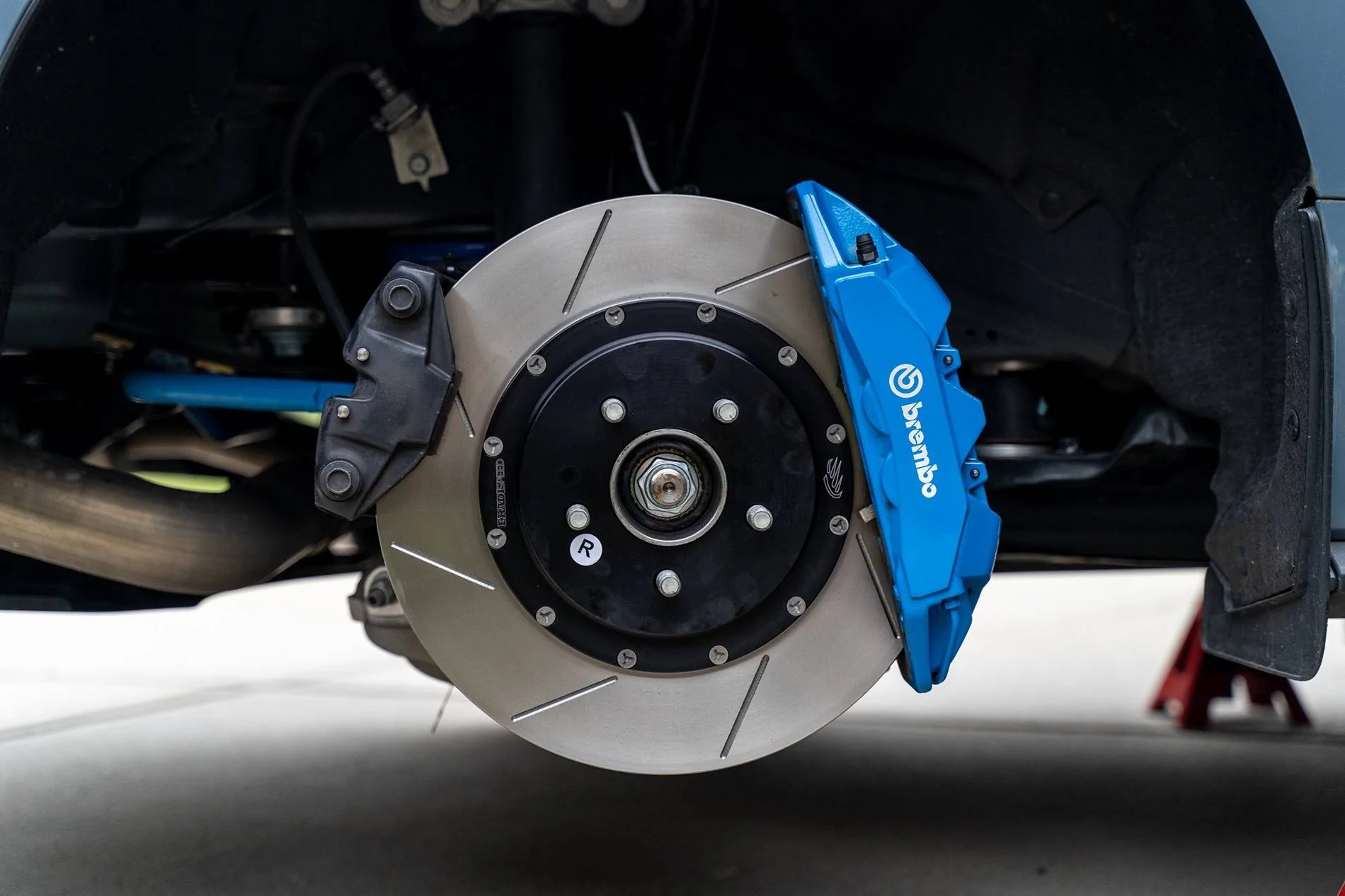

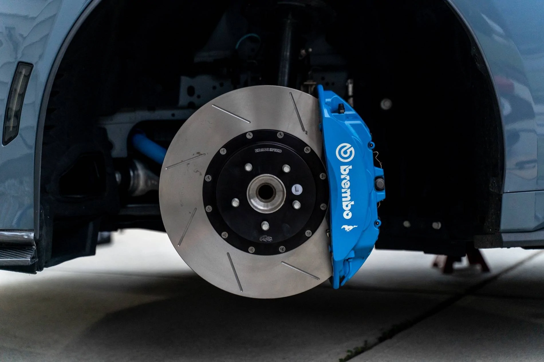

For those that don’t know about the Eradispeed+ Rotors from Baer, they’ve been around since 2015 for the Mustang. It’s a very high-quality direct-fit replacement rotor that typically comes cross-drilled and slotted. I’m happy to report they also offer a slotted-only version for us track folks that are looking for an upgrade that will stand the immense brake temperatures seen out on track.

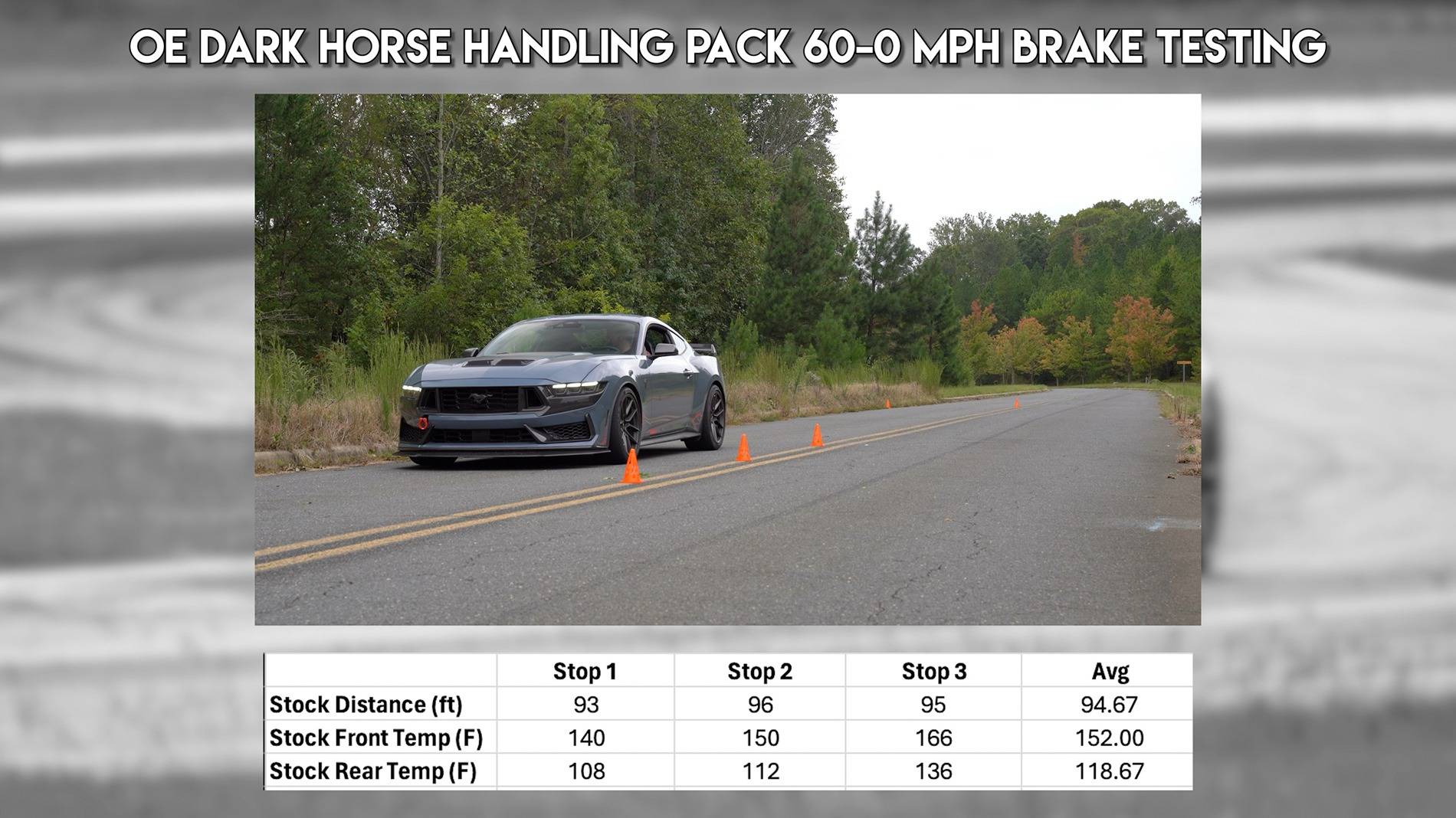

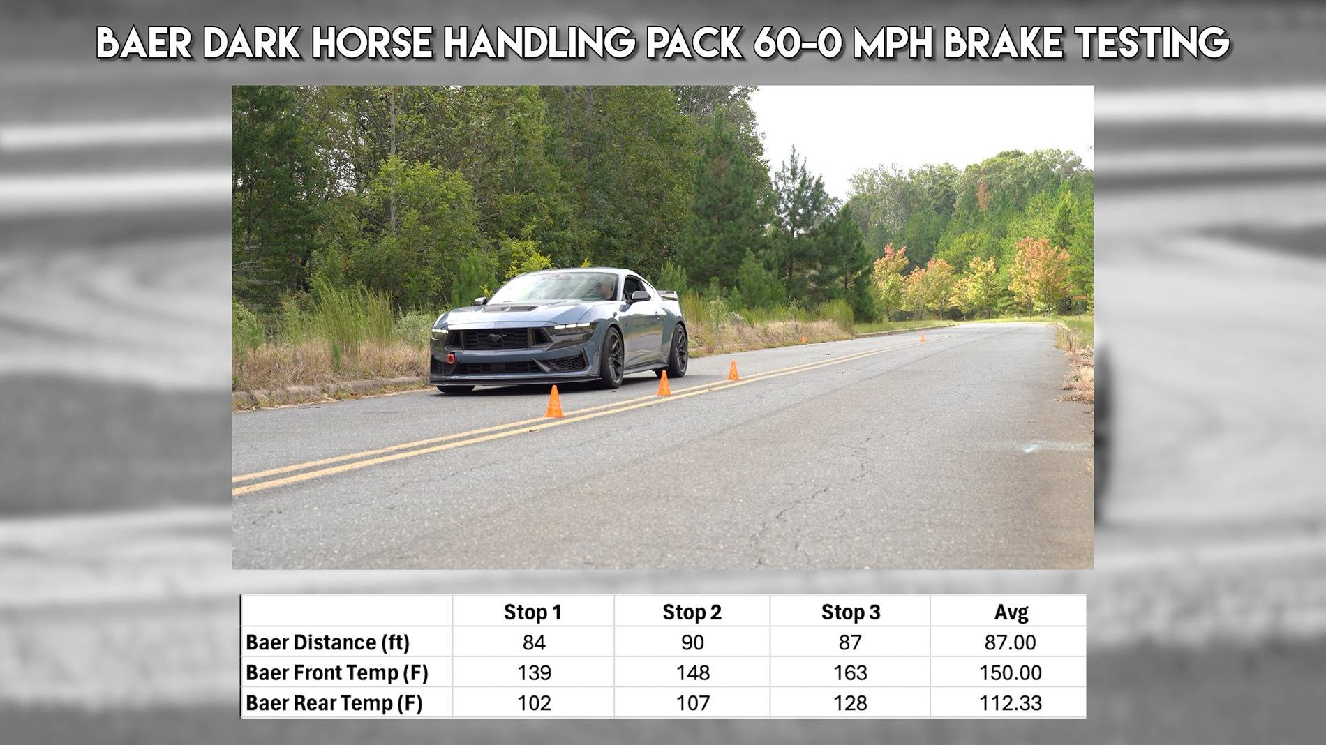

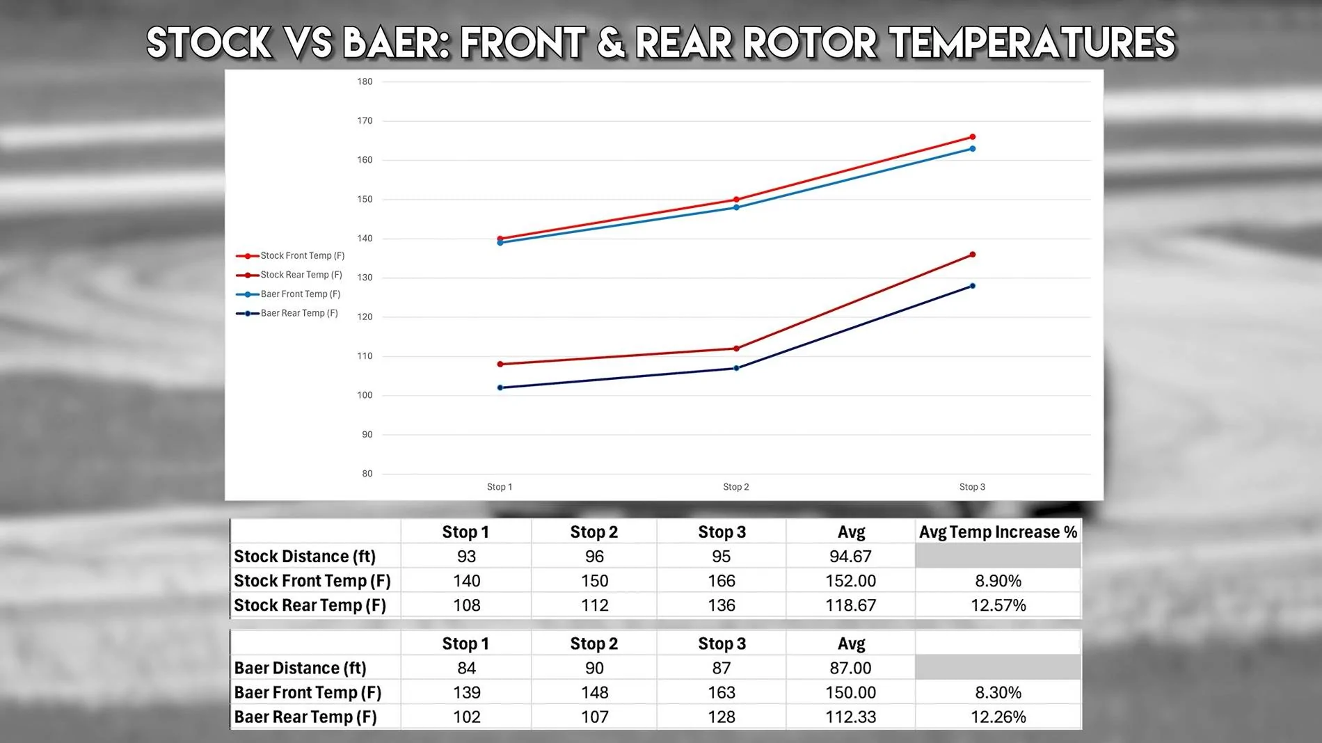

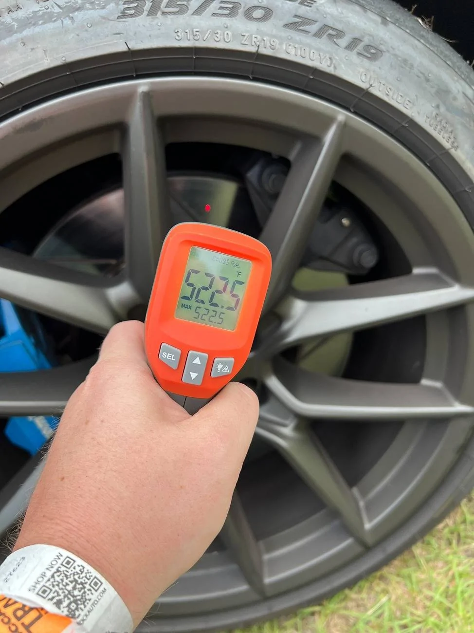

Before installing the new rotors, I was sure to do some before 60-0 mph testing to get a baseline. Man, this car already brakes amazingly from the factory! After installation, I was pleasantly surprised to see measurably reduced braking distances along with a more favorable temperature curve which bodes well for Baer’s claims for evacuating heat out on course.

I installed mine yesterday. For a reason that I don't understand, the slotted rotors are few hundred dollars more than the drilled and slotted.

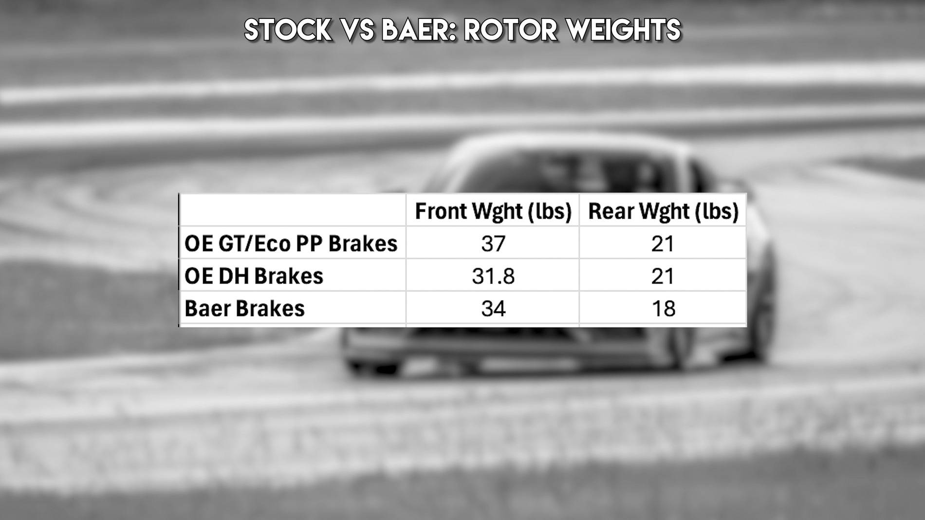

Interesting to see that the DH has lighter rotors than GT. That wasn’t the case with my Mach 1, I lost 10lbs on each front rotor with girodisc slotted.
timd38
Dec 25, 2015
990
379
Hudson WI
GT has one piece rotors, DH has 2 piece with the hat section being aluminum, making the DH rotors lighter.
That’s awesome! Thanks for the info.
Not many people mention this difference
