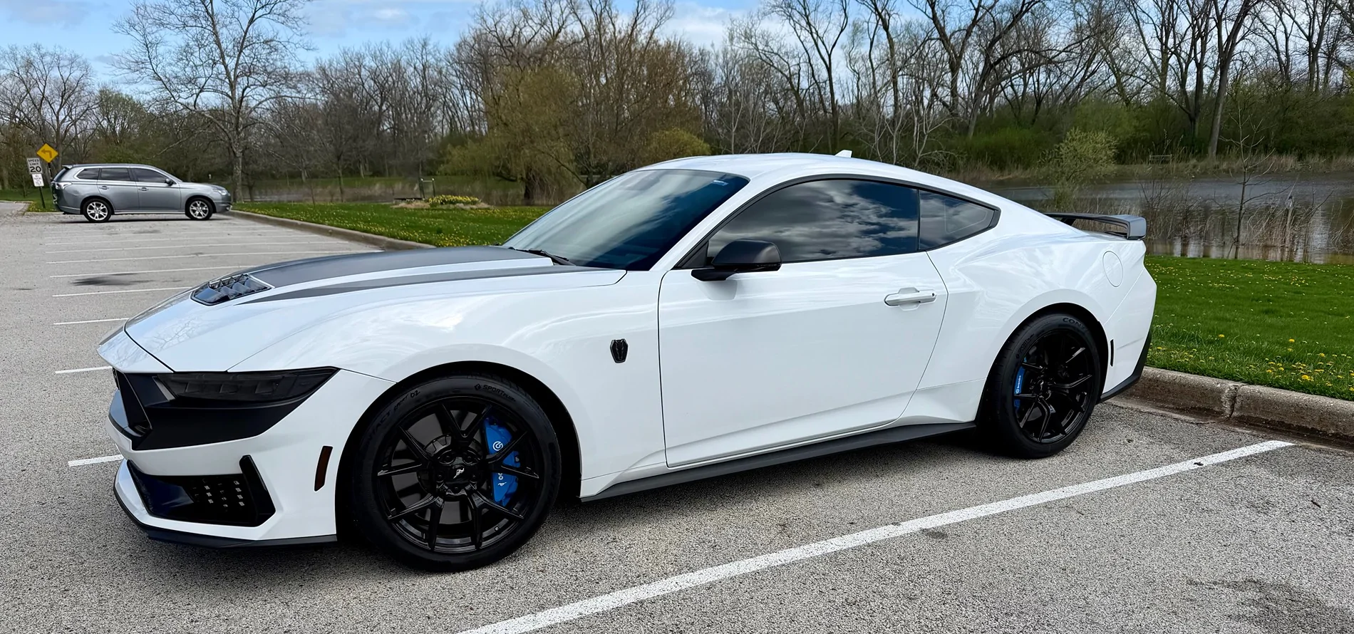

here's mine on stock non-hp
285/35 x 305/35 Continental ECS Sport 02’s
Very happy , wheel gap is not as bad as I thought it could be.

Stock suspension?
Im thinking about doing same size 285/35 -305/35 19R on my DH.

Looks great Staliion!
I just ordered the same wheels for my non-HP Dark horse but with Continental ECS sport 02'
Do you feel the wheel well gap is more than stock with this setup?
The picture LMR provided of the DH seemed like increase gap too but photo's are deceiving.
Stock PP or non-hp is 27" diameter front and 27.7" rear
the 285/35 is 26.9" and 305/35 is 27.4" so seems like it's so close that the gap wouldn't be noticeable
I think the wheel gap up front with the 255 is less apparent because it is tucked in. With 285/35 it more apparent because of more poke and less place to hide.
Yes, stock suspension.
I think the rear is more noticeable than the front actually.
It really isn’t bad though and I’m super anal about it.
