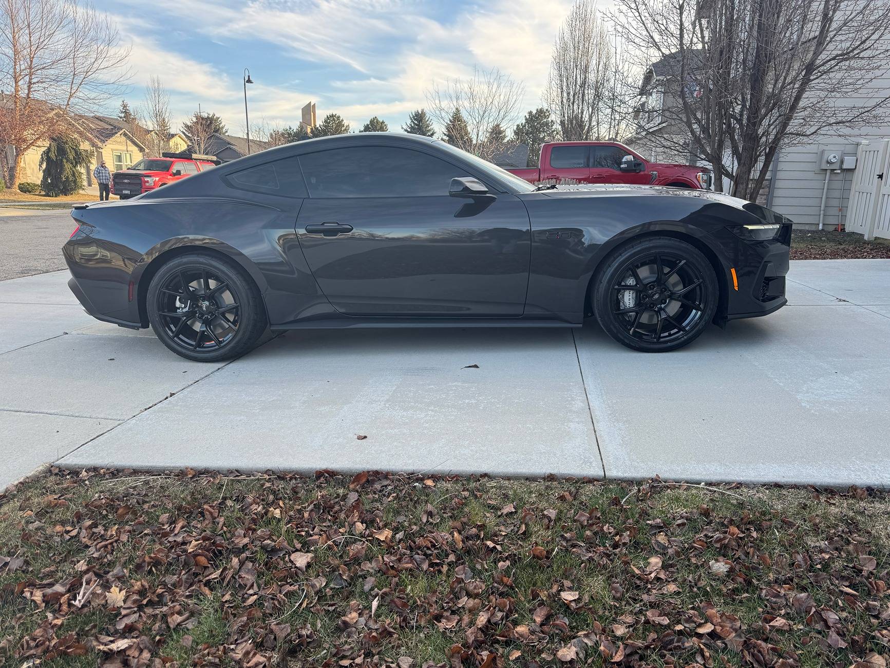

I have attached a photo of these wheels on a non HP car for you.
S650 Mustang 2024 Atlas Blue Mustang GT On SVE SP2 Wheels IMG-20231015-WA0001

I have a 2024 Mustang GT Premium - Not a performance package. Car came with 255/40/19 Tires & 19x8.5 wheels - all 4.
Like others here I hate that the tires are way inside and tucked in. I want to get a set of wheels and tires that has a slight poke, nothing major, maybe an 1/8" to 1/2" out. I came across this setup:
Front 19x10 SP2 Wheels - 285/35/19 Nitto NT555 G2 Tires
Rear 19x11 SP2 Wheels - 305/35/19 Nitto NT555 G2 Tires
https://lmr.com/item/WTK-188912GB/sve-mustang-sp2-wheel-nitto-tire-kit-19x10-11-black-2024
Do you guys think, this will give me that aggressive look/stance that I'm going for, I don't plan to race or lower the car.

Yes, the + 35 mm offset on the front, +50 offset on the rear, will push them out to almost flush with the wheel wells. Much better look. Send pics once done :)

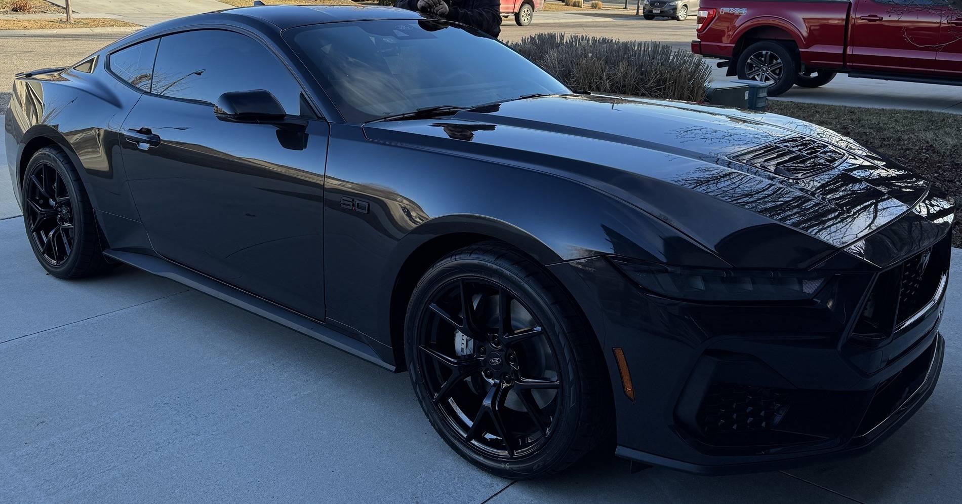

Looks amazing! Thank you for sharing these photos!

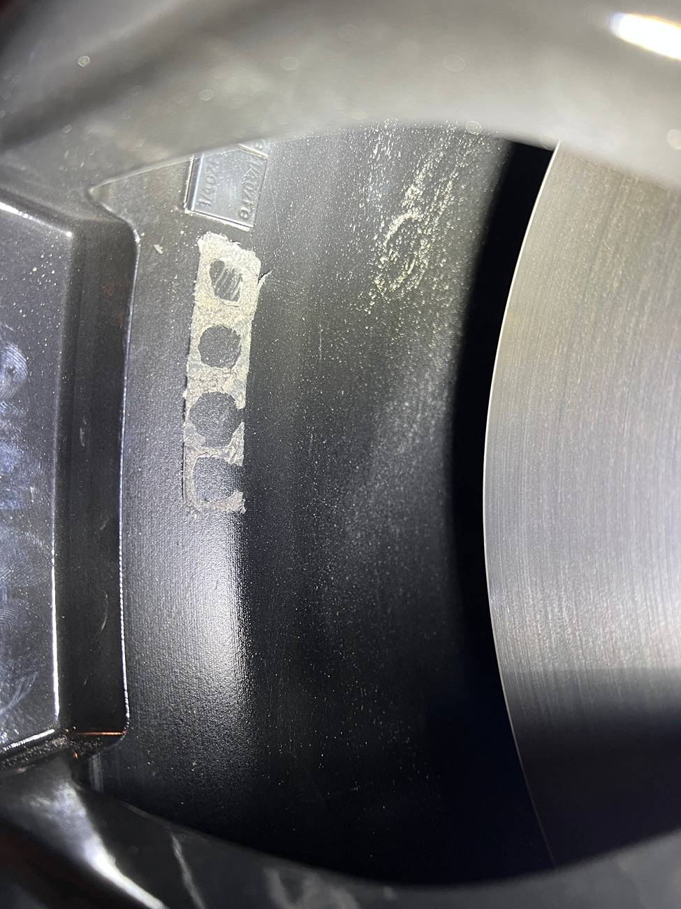

I noticed the SVE wheels that you guys (LMR) sent me has old adhesive glue from what looks like previous balance weights that were on the wheels. All 4 sets have them, these weren't used, were they? Took a pic of it.
Good Morning!
We do not sell used wheels or wheels that have been used for marketing purposes on our site. These are sold through our ebay store and marketed as such. I am unsure why these would have adhesive from weights on them, but if you could send us a quick message at - https://lmr.com/contact we can get you taken care of.

I love it, feels it up lot more and gives the car more aggressive stance. Here is another shot.
Looks great Staliion!
I just ordered the same wheels for my non-HP Dark horse but with Continental ECS sport 02'
Do you feel the wheel well gap is more than stock with this setup?
The picture LMR provided of the DH seemed like increase gap too but photo's are deceiving.
Stock PP or non-hp is 27" diameter front and 27.7" rear
the 285/35 is 26.9" and 305/35 is 27.4" so seems like it's so close that the gap wouldn't be noticeable

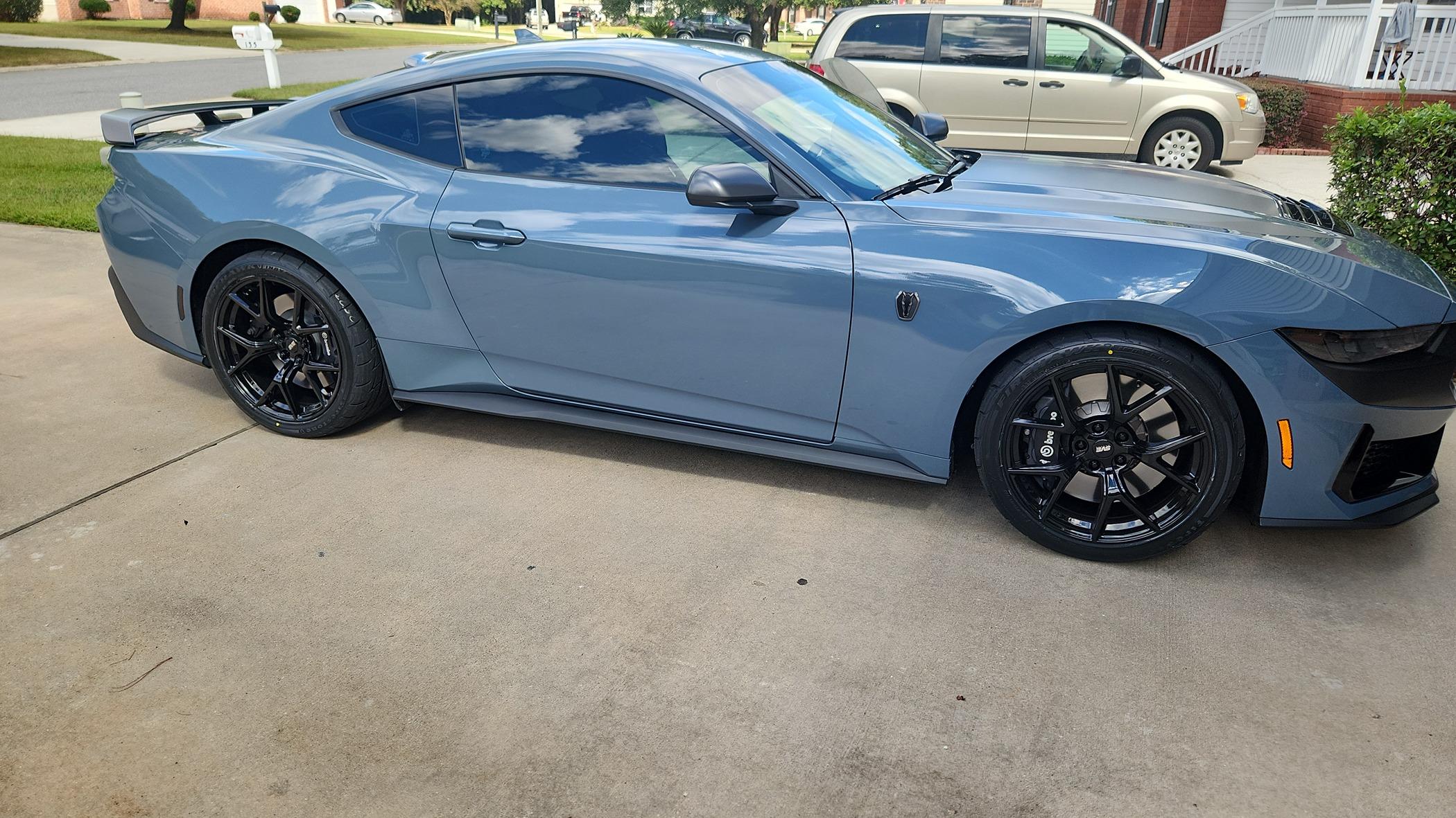

Here’s my DMG GT with the SVE SP2 wheel package I bought from you guys a few weeks ago. 19x10 and 19x11 with the Nitto G2’s in 285/35/19 and 305/35/19’s. Definitely love the more aggressive look compared to the stock 255’s all around and better traction when launching at a stop!
