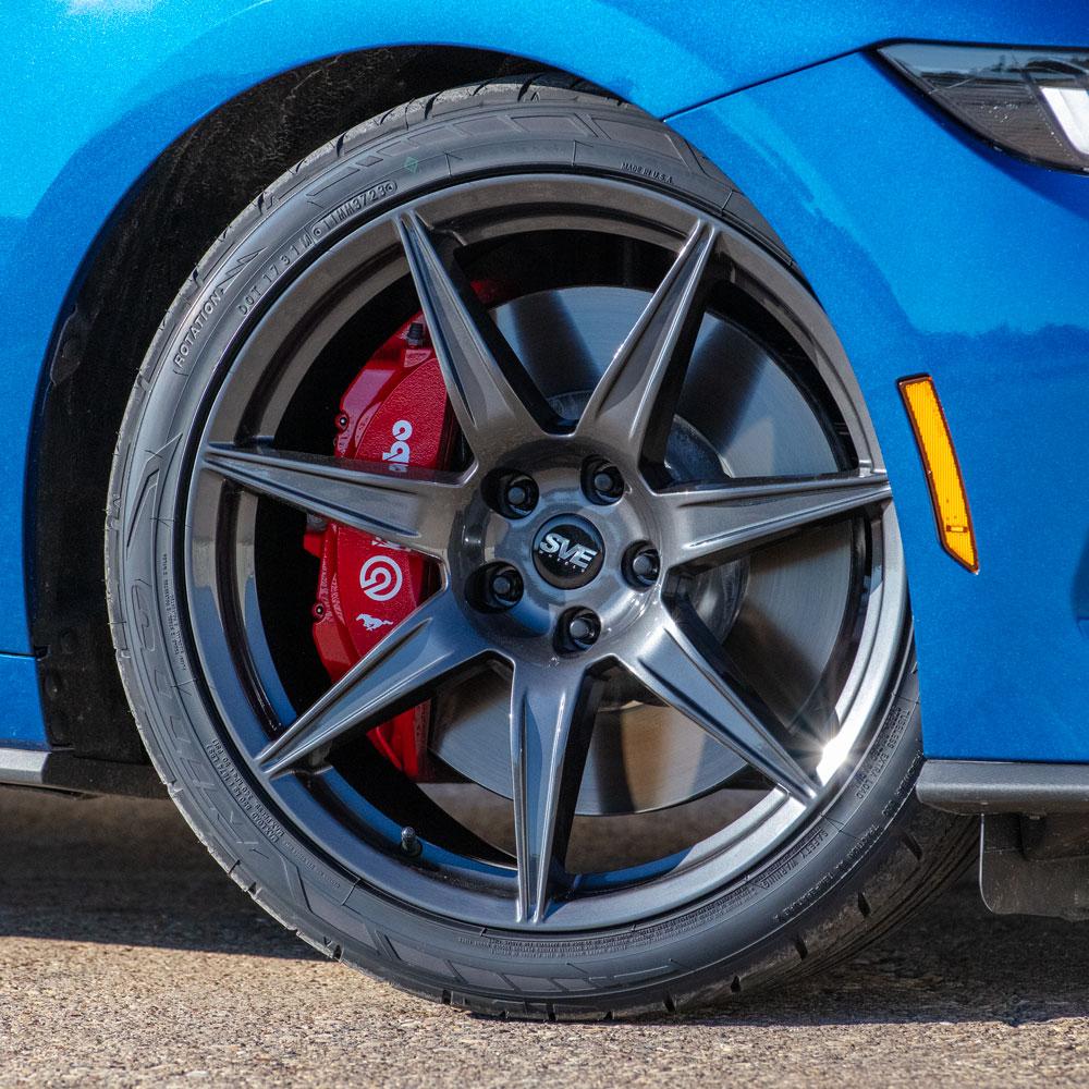

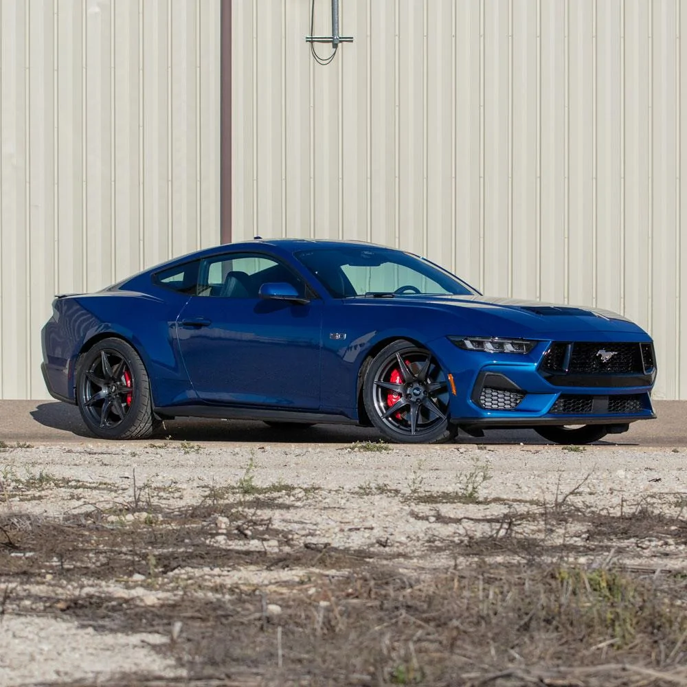

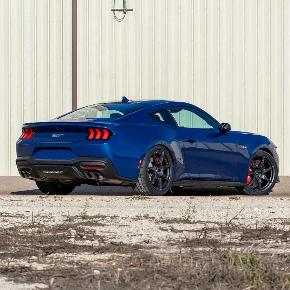

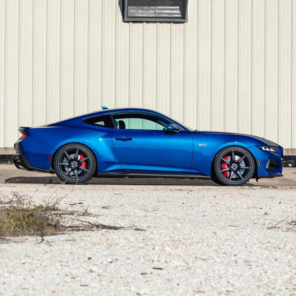

Our new 2024 Mustang S650 sitting on our SVE CFX wheels. 20x10/11 and lowered on the Ford Performance 1” Lowering Springs.
  • 20x10 SVE CFX Wheels
  • 20x11 SVE CFX Wheels
  • 275/35/20 Nitto NT555 G2 Tires
  • 295/35/20 Nitto NT555 G2 Tires
Wheels - https://lmr.com/products/mustang-sve-cfx-wheels-24
Springs - https://lmr.com/item/M5300XA/mustang-ford-performance-m-5300-xa-lowering-springs-15-19
2024 Mustang Parts - https://lmr.com/products/2024-Mustang-Parts
Do you know if there is any rubbing on a 20x11 square setup for a DH handling pack car?

Unfortunately, we have not test-fit these wheels on a DH HP car yet. We are actively looking for one locally to test them on and should know soon.

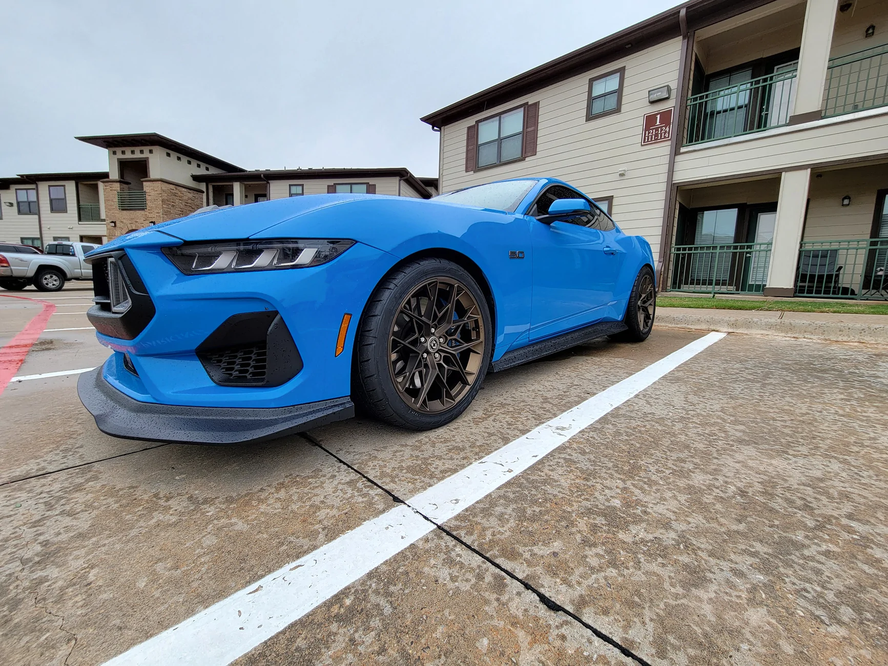

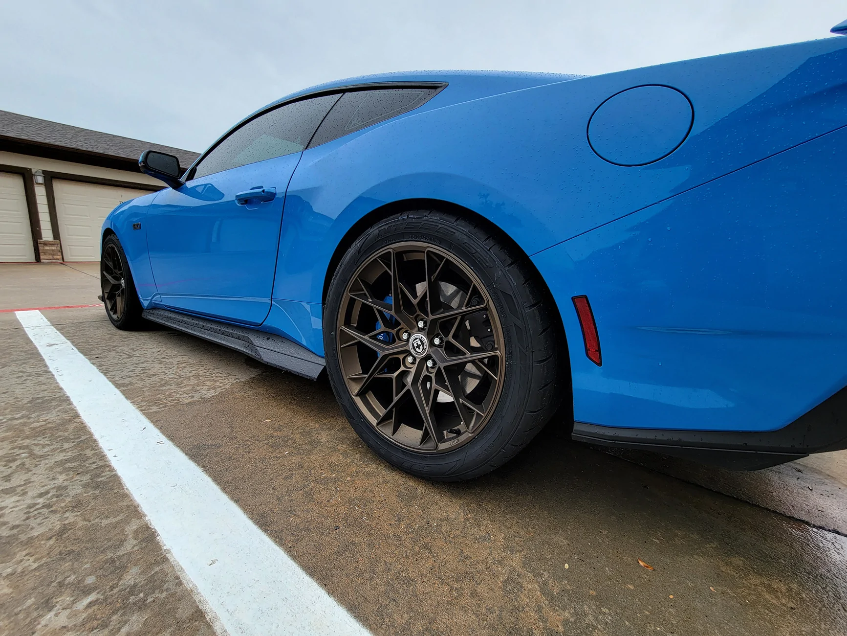

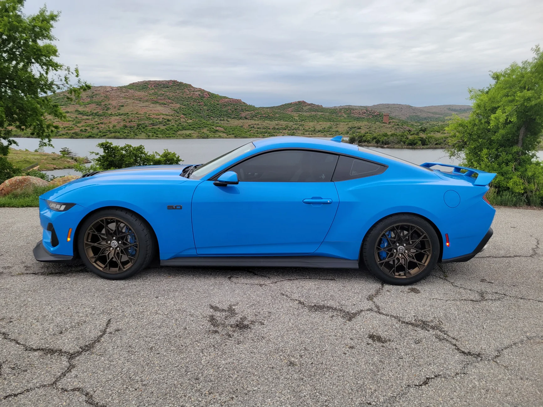

I actually run 315/35 in the rear. Fitments perfect on an 11 with plenty of clearance on the backside so no worries there. Fronts I run 285/35 on a 10" rim with 0 rubbing at full lock, I think any larger though on 20s and you'll have issues
S650 Mustang 2024 Atlas Blue Mustang GT On SVE CFX Wheels 20240420_135129
S650 Mustang 2024 Atlas Blue Mustang GT On SVE CFX Wheels 20240420_135117

Looks good!
any issues with rocks chipping paint in rear or it it not poking out enough to be a issue?
Are you on 50offset wheels?

theyre flush with the rear arches so no issues, fronts are flushed at the top but tuck in a bit at the bottom so rocks get caught by the wheel wells
yes 35 front 50 rear
