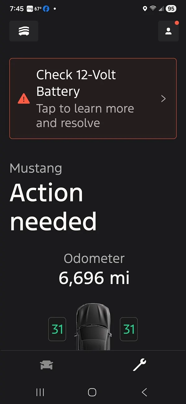

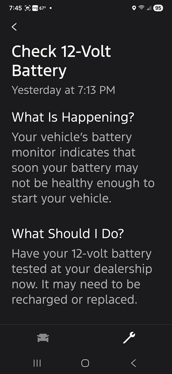

Last night after I got home from work (yes Thanksgiving) I got this message from the Ford app.
S650 Mustang Battery replacement by Ford Mobile Service. 16431
S650 Mustang Battery replacement by Ford Mobile Service. 16433

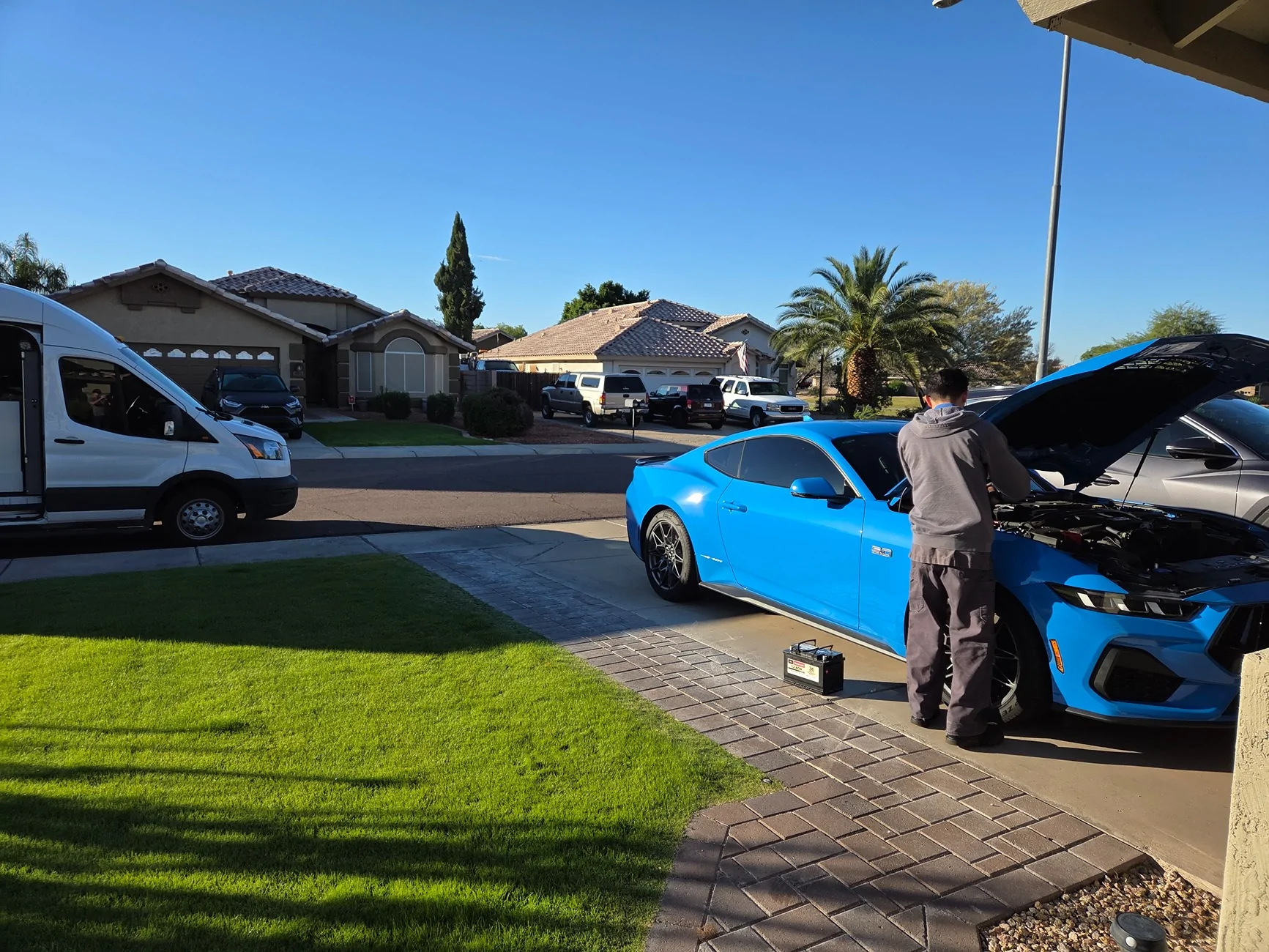

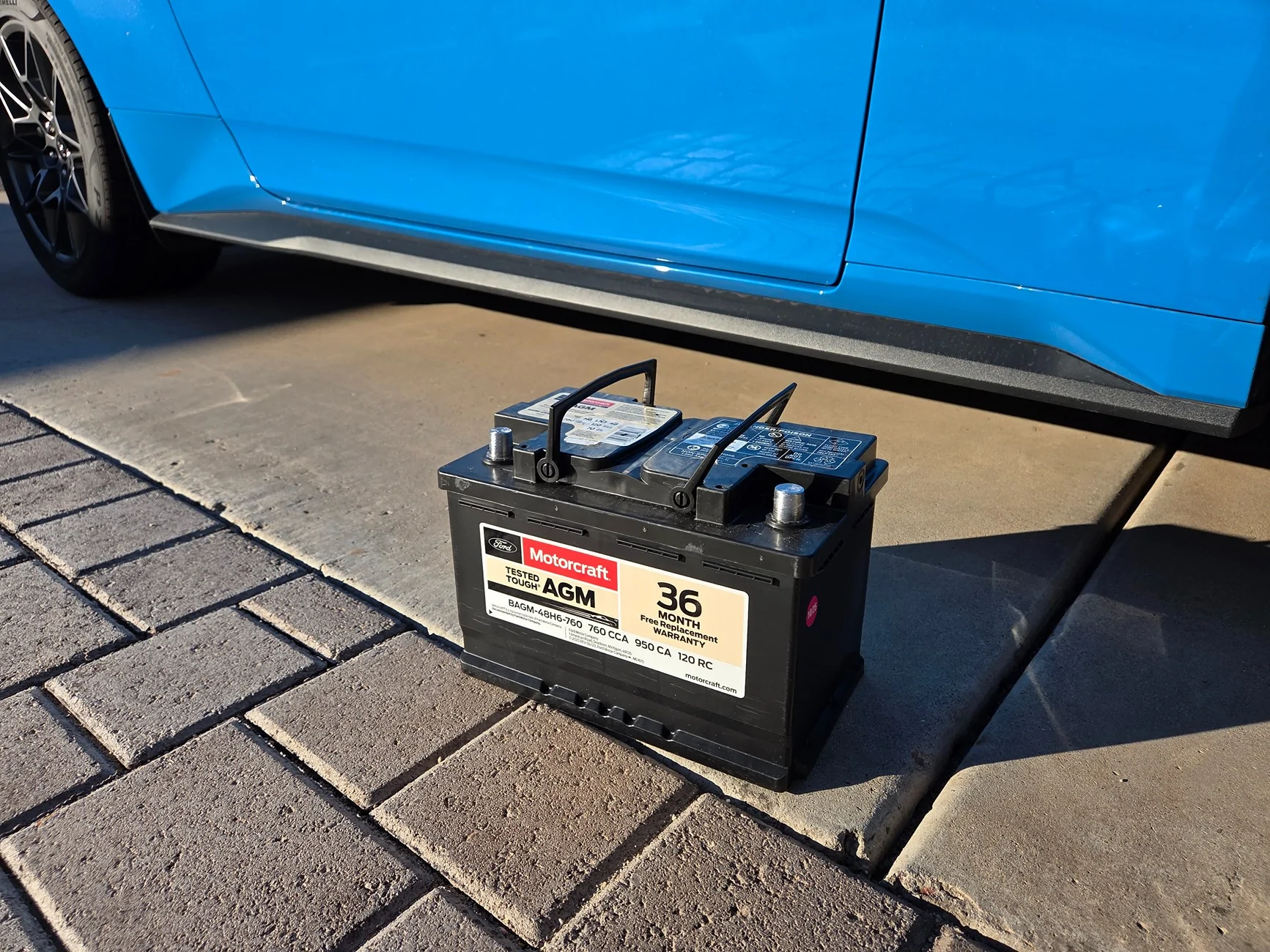

The battery issues in these cars have been well documented of late. Last weekend my heart beat got replaced by the chime again. So I put a battery tender and charged it. I drove the car all week with no issues.

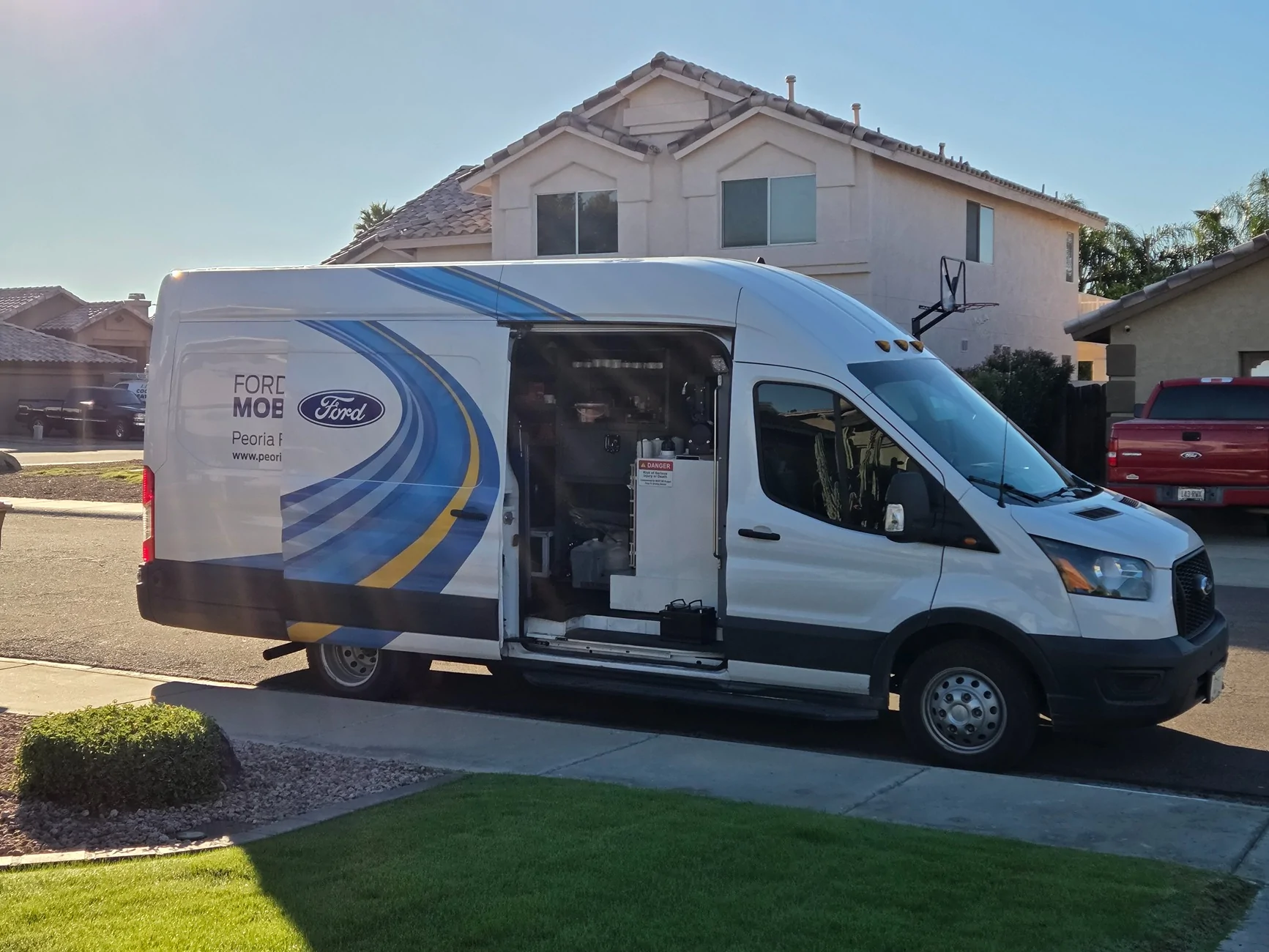

So I decided its time for a battery replacement and scheduled a mobile appointment for this morning on the app. I fully expected a call to schedule service, but they showed up at my door at 8:30 in the morning!
The tech was as polite as he could be and explained he was there to change the battery and top off my fluids. So I pulled the car out of the garage, (which started just fine despite the warnings on app and dash). After he replaced the battery, he said the battery monitor sensor was still saying the battery was low. So he had to do a BCM reset. After that everything was good. He said he be happy to come back out for a mobile oil change too. So I tipped the guy and went back to my coffee. Great experience from Ford!

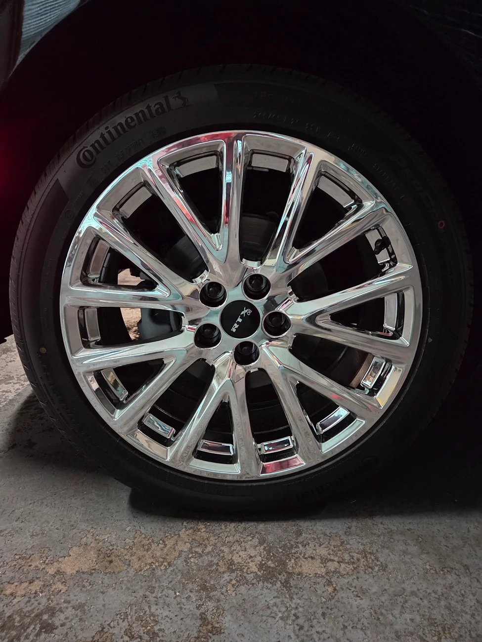

@BimmerDriver .... just my opinion but I give $50.00 for simple and more if it's a complicated job. Oil change with filter double lubed $100.00 I purchased expensive aftermarket rims that my wife wanted. This was on a brand new vehicle. We had him take the "summer" tires of the OEM rims and put them on the new aftermarkets". We then had him put the new "winter" tires we purchased on the OEM rims. He also had to install two sets of McGard locking nuts. He balanced all eight rims/tires. Then he used his rattle gun to spin the lugs and McGards on most of the way and did the final tightening "old school" with a hand held torque wrench. New car, expensive aftermarket rims for summer and decent OEM rims to be used in the winter. Lots of opportunity for parts/vehicle to get scratched. You could view the whole process from the waiting room. He took great care not to scratch anything. I tipped him $150.00. He thanked me and said he was going shopping that night to buy his daughter her first bike and the money would come in handy..... Respect...... Attached - the wife's new rims - telling the wife her new rims got scratched.....not good ..... LOL - Pic attached :cool:
