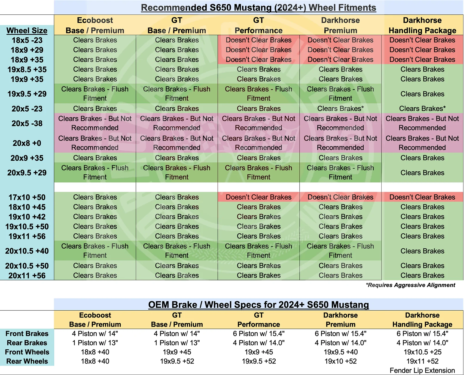

We’ve organized something the Mustang7G community has been asking for — a comprehensive S650 Mustang Wheel Fitment Guide built with help from WELD Racing and Forgestar.
The 2024–2025 Ford Mustang S650 introduced the widest range of factory brake configurations, wheel diameters, and fender widths of any generation to date. Understanding these differences is critical when upgrading to aftermarket wheels.
This guide covers all major trims — EcoBoost, GT, GT Premium, Dark Horse, and Dark Horse Handling Package — and details which sizes clear factory brakes, offer flush fitment, or require minor adjustments like camber or fender extensions.
Fitment Guide - WELD RF and Forgestar S650 Mustang Fitments - GT - Darkhorse - Handling Packa...webp
Brands referenced include:
  • WELD Racing: Belmont, Laguna, Solana, Ventura Drag, RT-S Forged Wheels
  • Forgestar: F14, CF5V, CF5, CF10, D5 Drag Series
You can view the full article here: 2024–2025 Ford Mustang S650 Wheel Fitment Guide (EcoBoost, GT, Dark Horse, Handling Package)

I'm surprised you managed to get 18's that clear the 6 piston brembo's, unless I'm reading that wrong and those are rears
Whats the reasoning for not recommending the 20's?

So the 18x10s are rears only. Fronts you are limited to 19inch or larger with the bigger Brembos.
20x5s are an aggressive fit and usually sit right on or near the fender so it will need alignment adjustment to avoid having the tire catch the fender.

Thanks. That's a nice tool that'll save many a lot of grief.
