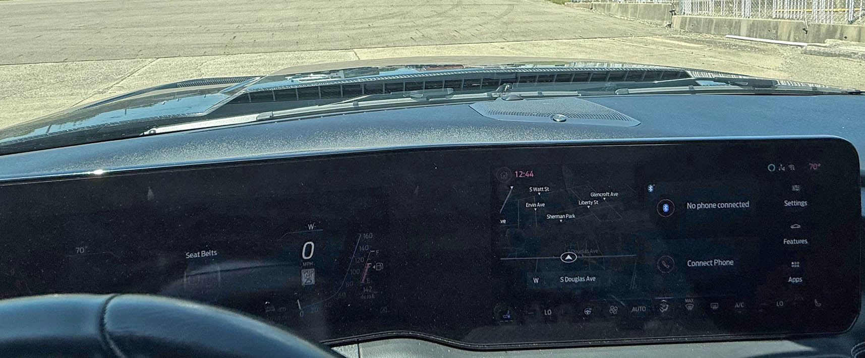

The cowl does not seem to affect visibility while driving any more than the original did. If it does, it is not by much.
