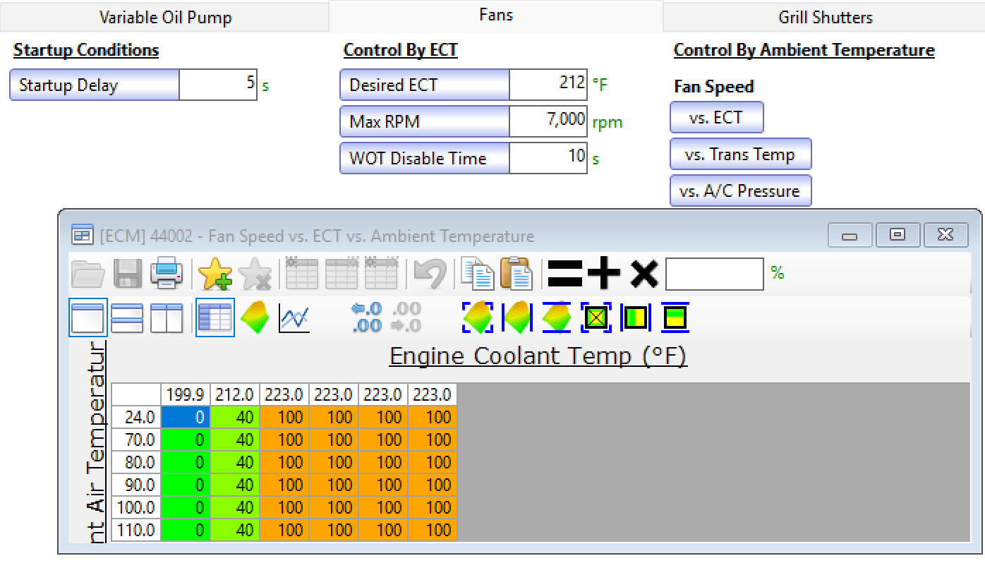

I’m trying to keep the engine temps down on racing. We’re just the 170° thermostat do any good or we throw off the tune and everything I know computers are set up and run hot from the factory. I’m worried about doing some runs overheating the number eight and seven cylinder.

Have someone real tune it. I turn the fans on much faster and at 180 not 212 like stock is set. And whipple doesnt change that either in their tunes.
From the whipple tune.
S650 Mustang 170° stat with Whipple Ford, racing stock, tune 1774227124752-ad
