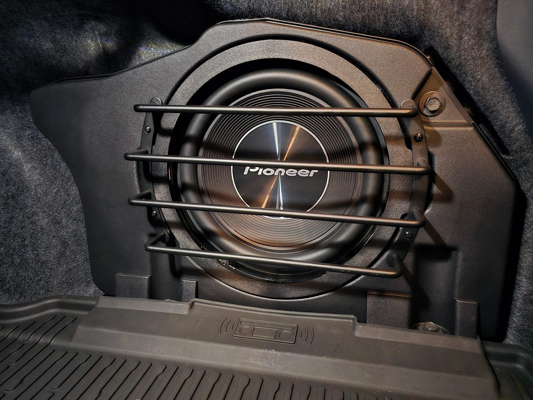

I completely misread the 550 thread you talked about. Thought the pins were on the ring, not the mesh grille. Went about it the wrong way, got the first pin to pop without breaking, not so much the following 3 and just said "F'it", yanked the the rest off. A little velcro and that 4 bar cover, I'm good with it. No rattles
I honestly like the look of your better. I might end up doing that!
