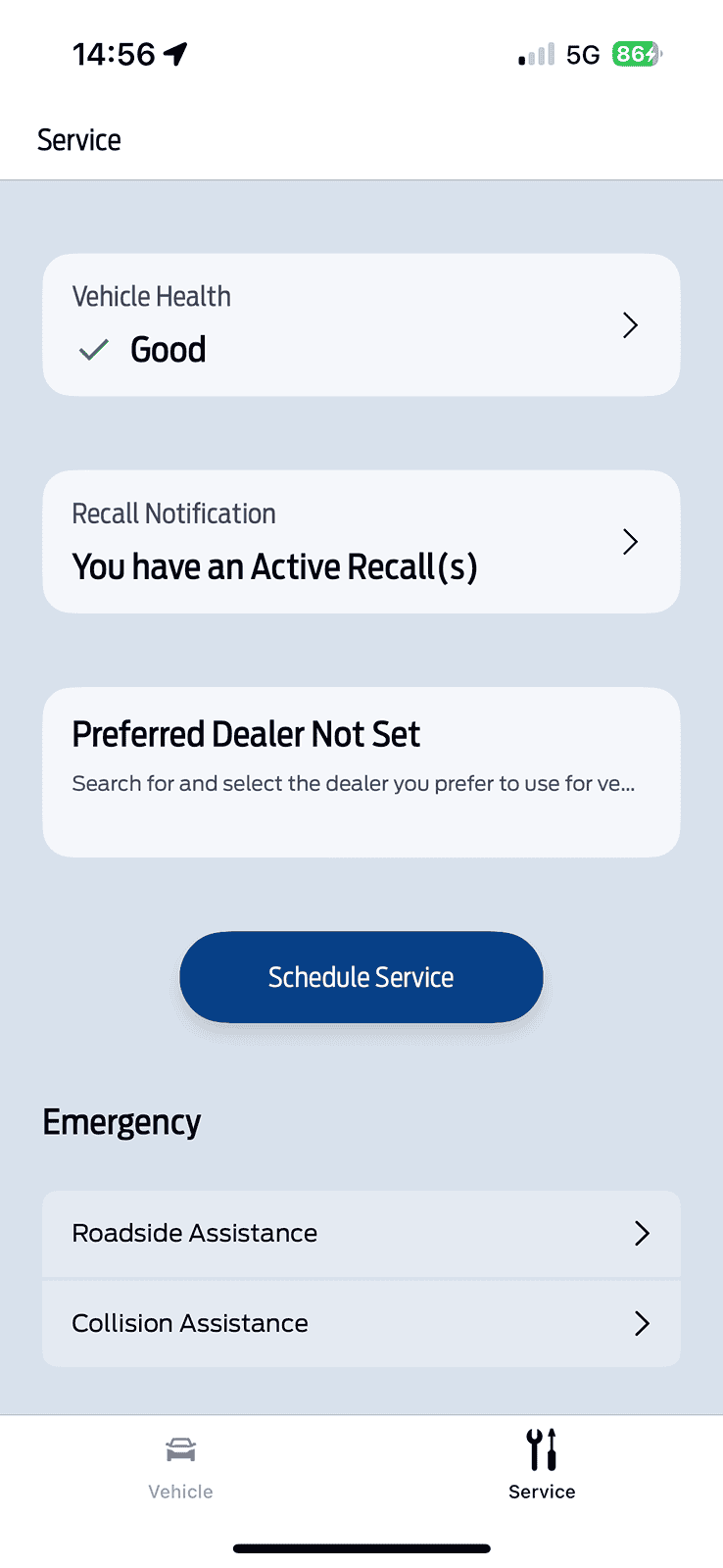

I happened to check my Ford Pass app today and see that a recall was issued yesterday for my car. Here is the info.
Campaign/NHTSA#
24S36/AWAITING
Issue Date
2024-06-03
Description
On your vehicle, the hydraulic clutch pressure line may not be properly retained to a locating stud on the dash panel. A line with improper retention may contact hot exhaust components and melt, leaking hydraulic fluid.
Safety Risk
A leaking clutch pressure line will not impact the volume of brake fluid in the brake system, so you will not observe an impact to brake function. However, this condition can impact the brake fluid supply in the clutch and can result in an inability to change gears. If leaked hydraulic fluid accumulates near a sufficiently hot surface, you may observe smoke and experience an under-hood fire. An under-hood fire increases the risk of injury.
Remedy
Ford Motor Company has authorized your dealer to inspect the clutch line free of charge. The clutch line will be located properly and in most cases that will close the recall. However, in the case the clutch line on your vehicle must be replaced, your dealer will replace the clutch line with parts available. If parts are not available andor backordered, you will be offered a rental until parts are available.
Next Steps
Contact your local dealer and schedule a maintenance appointment. To find your local dealer, use the "find a dealer" feature below.
I am currently trying to setup a service appointment.
