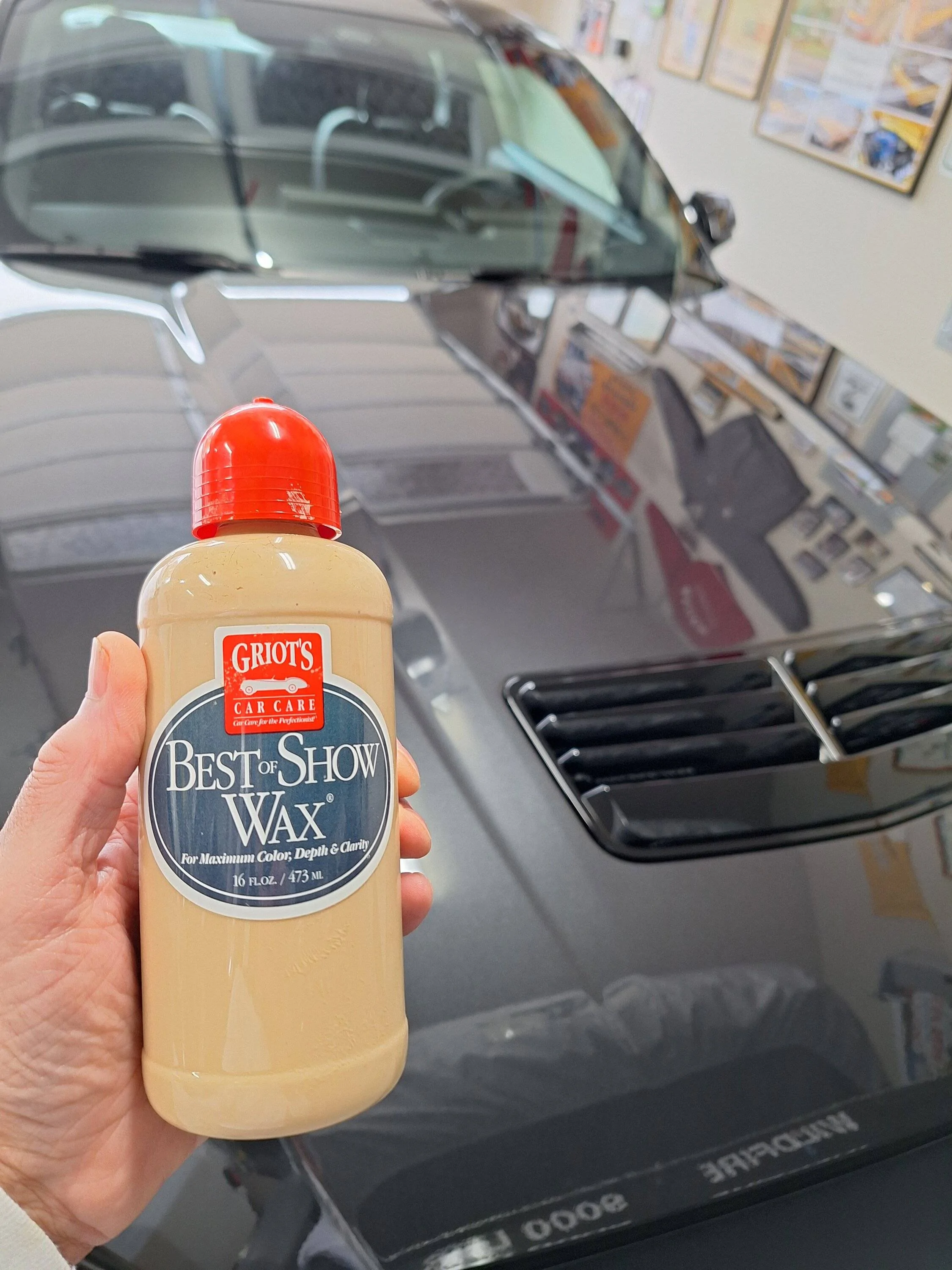

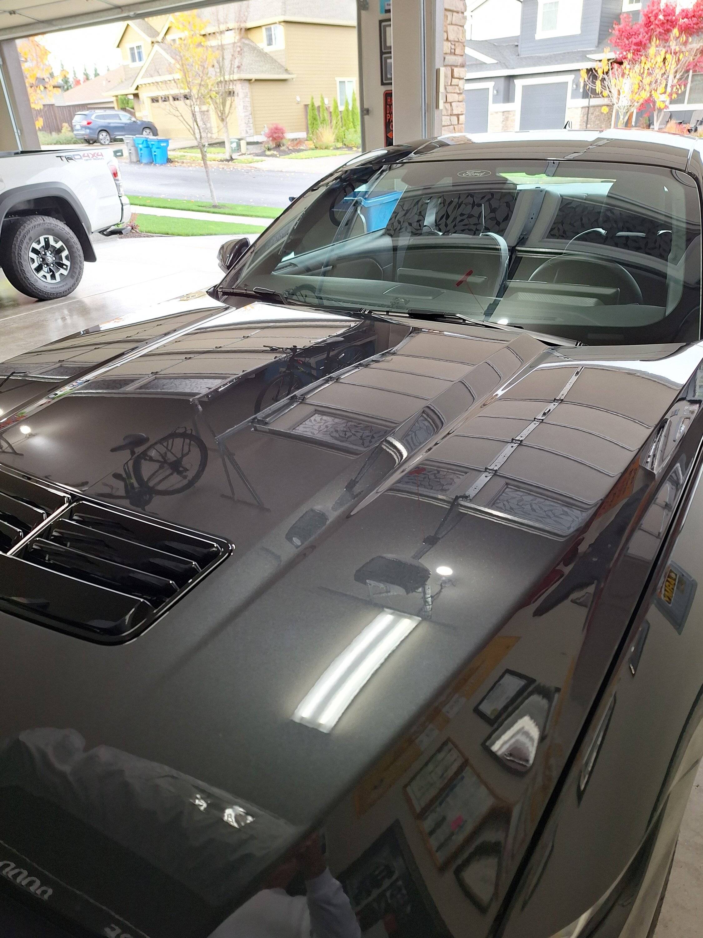

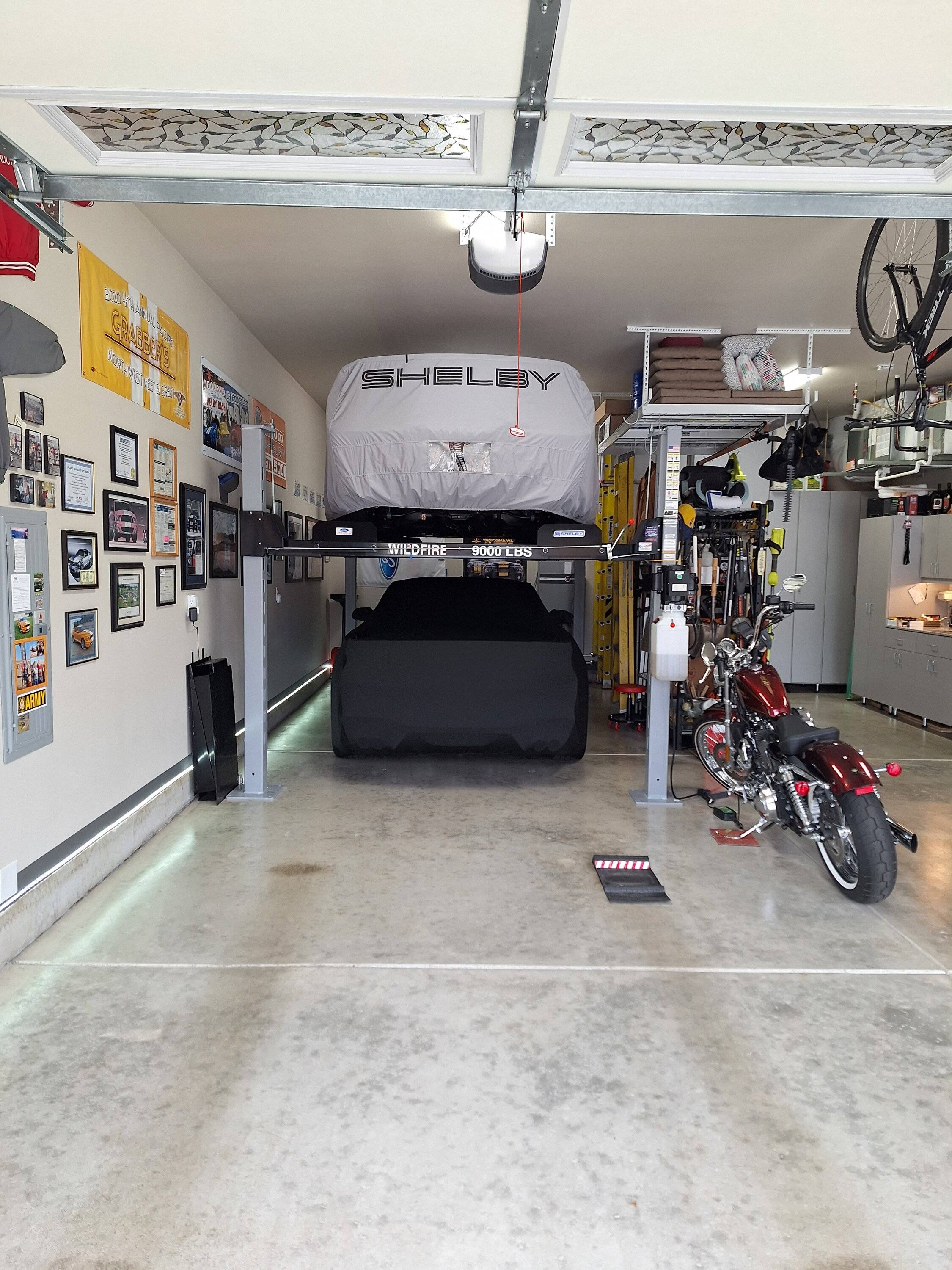

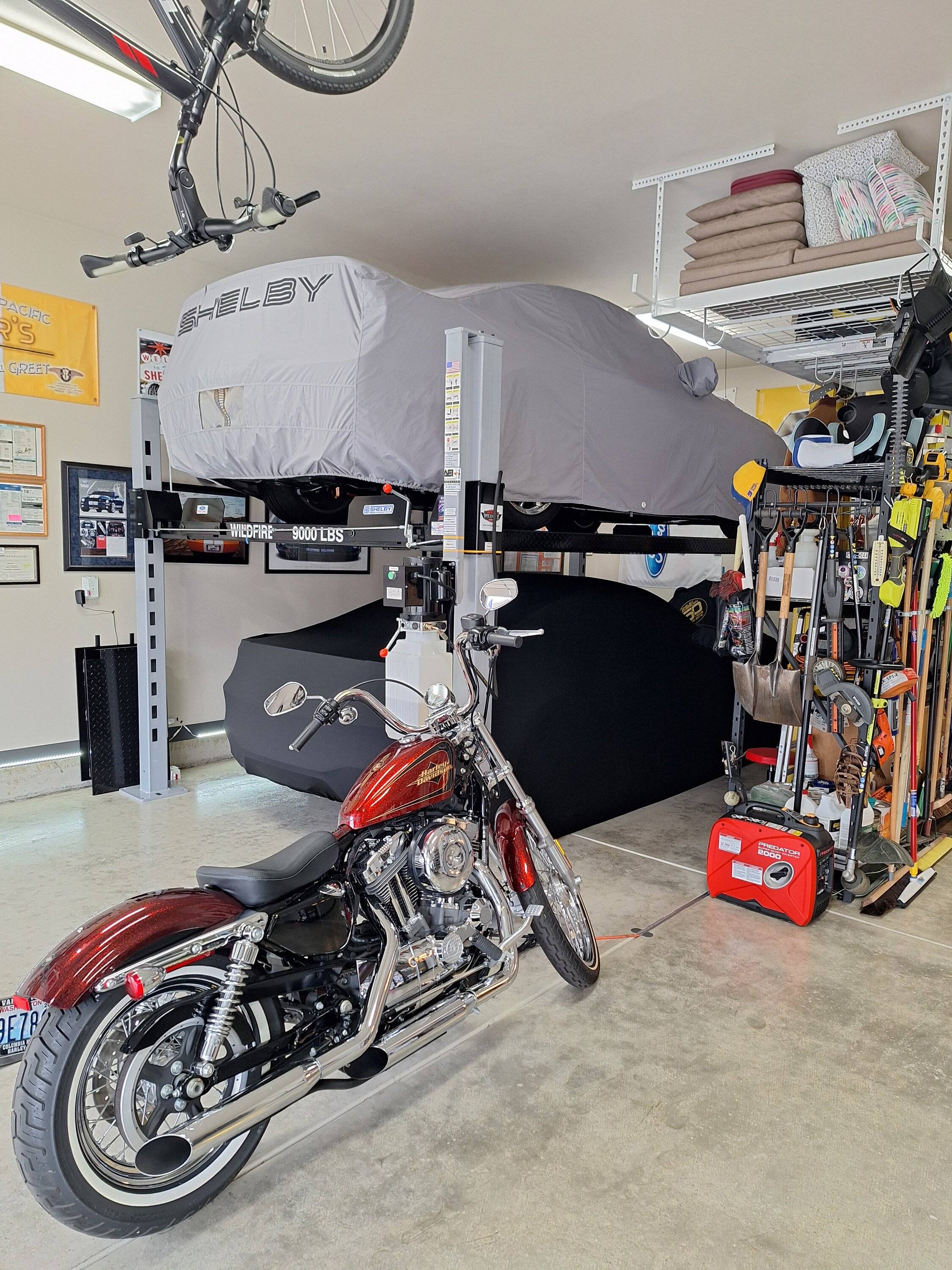

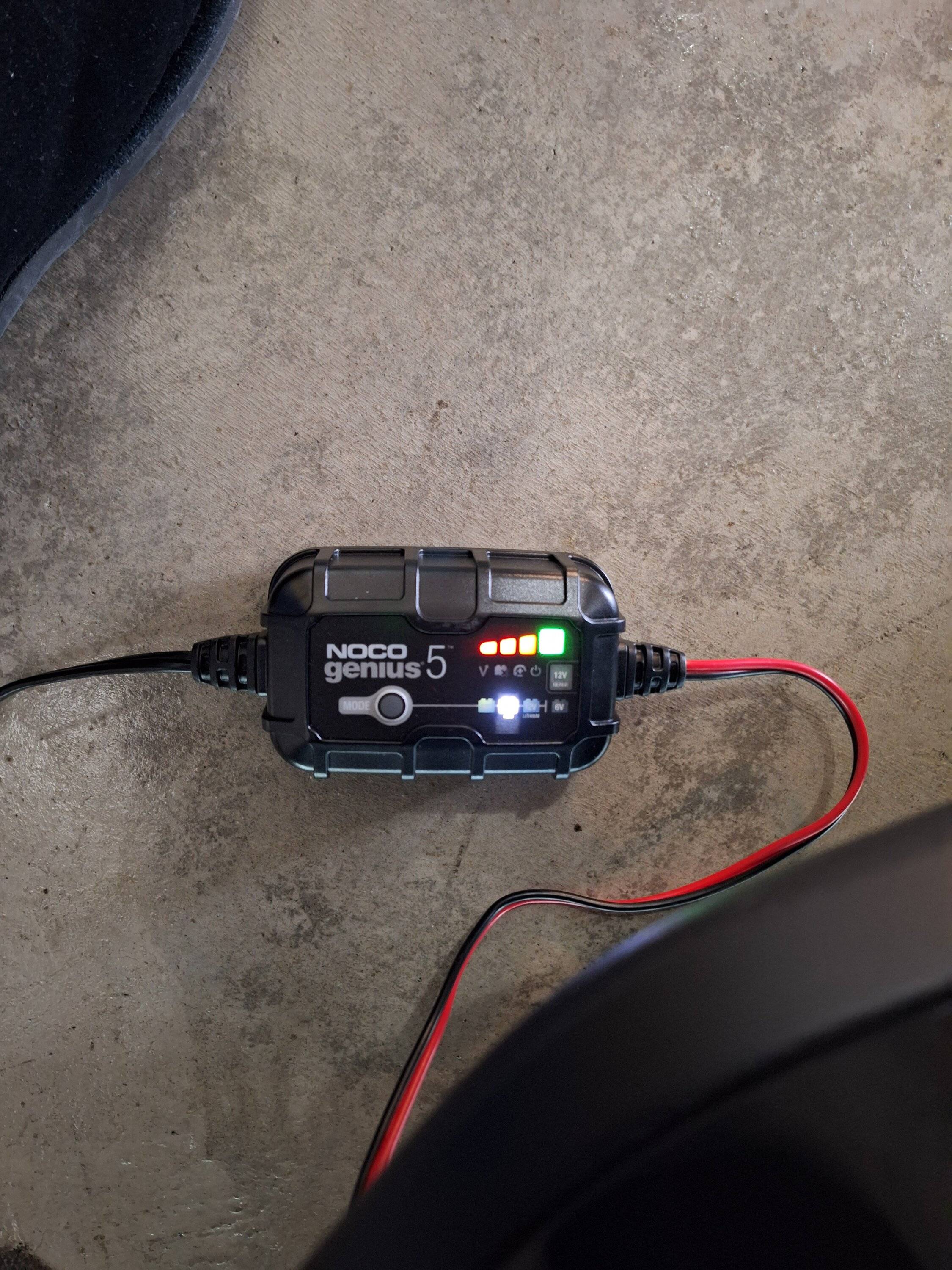

Put my Mustangs up for in preparation for the Pacific NW winter today.
1. Battery tender
2. Extra air in Tires
3. Clean & Wax
4. Car cover
5. Fill gas tank & add STA-BIL

What model lift is that? Curious on how you like it

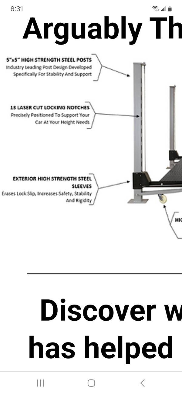

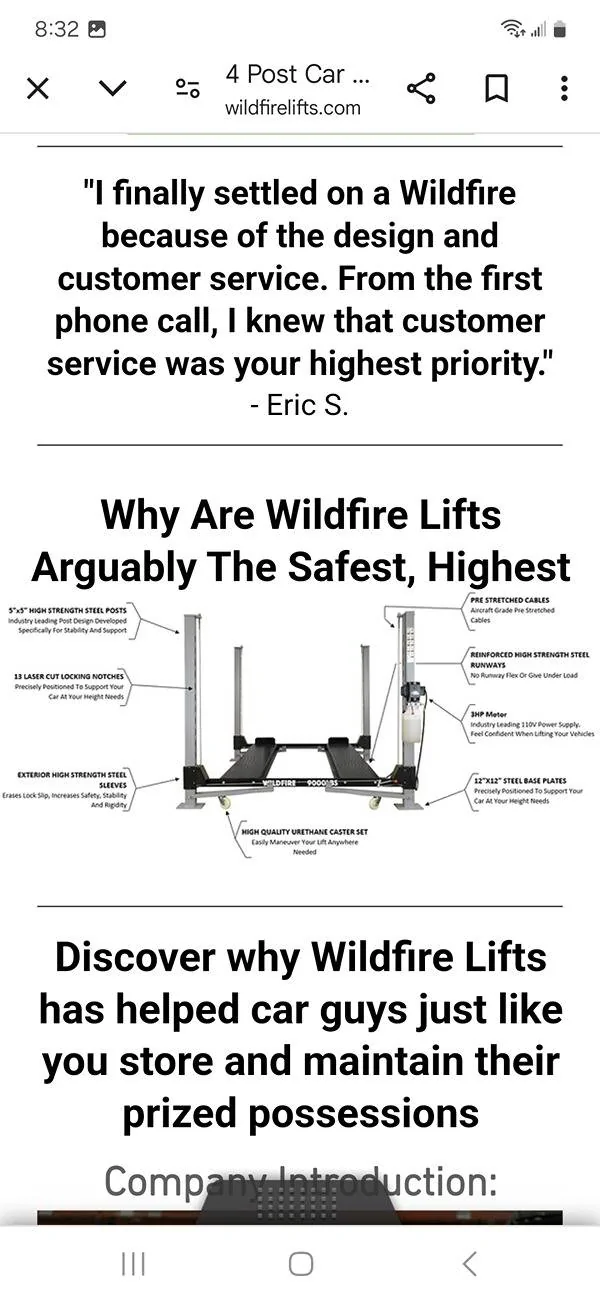

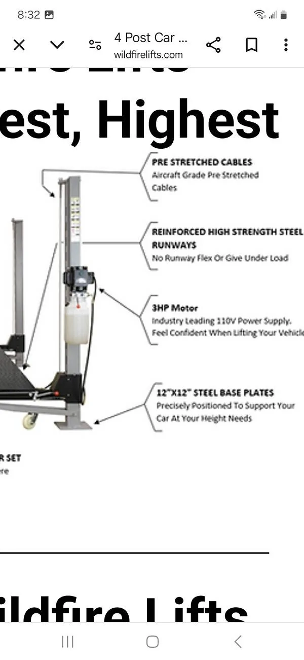

How well does the lift work with it not being bolted down? Every lift I’ve ever used in shops, are all bolted down.
All their lifts are designed as free standing as shown on their website. The steel 5x5 columns are encapsled by a solid steel sleeve to make it rigid and stable. With the car up in the air it is rock solid. The base plates are 12x12.

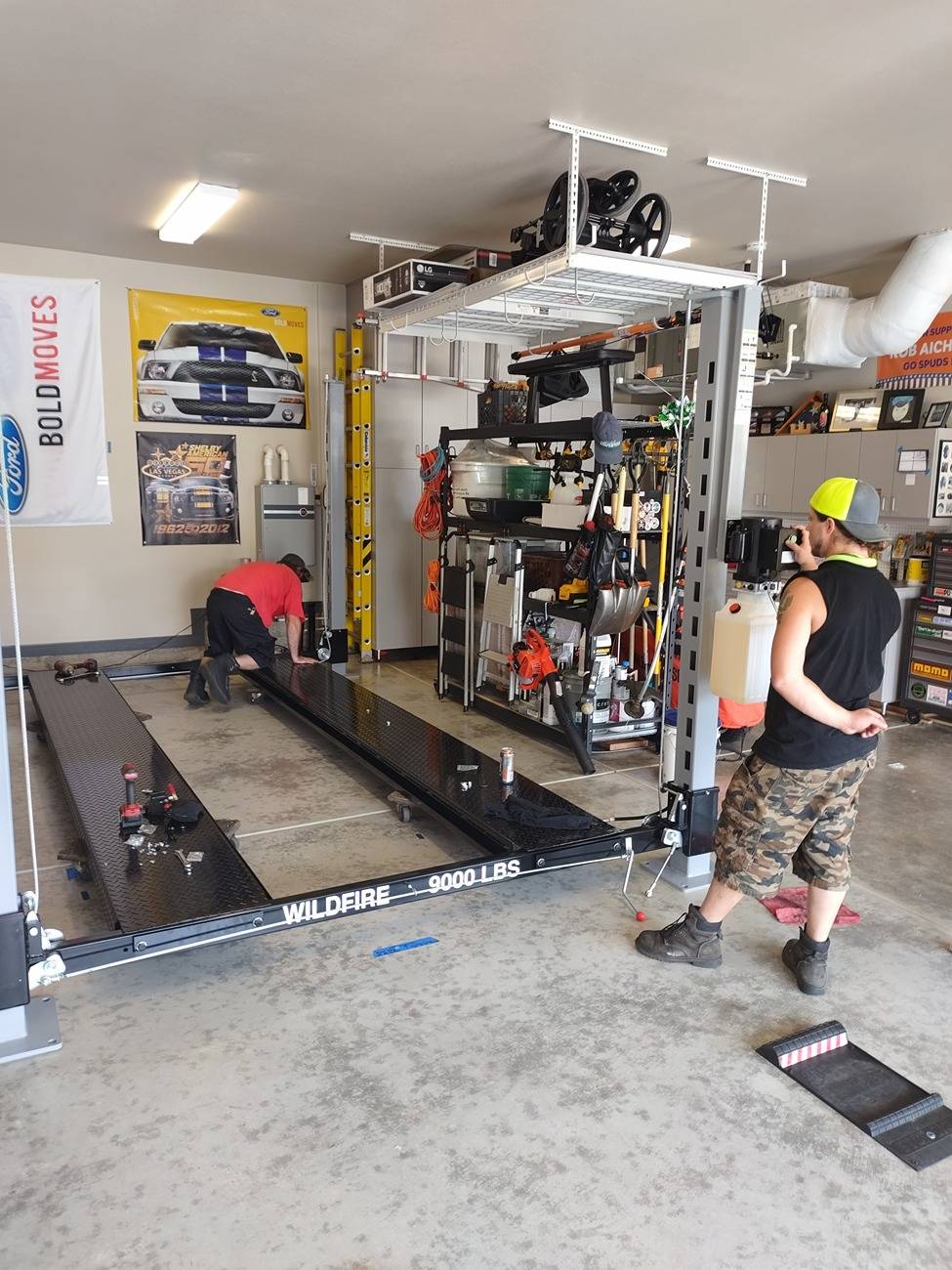

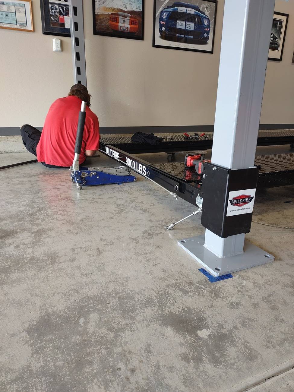

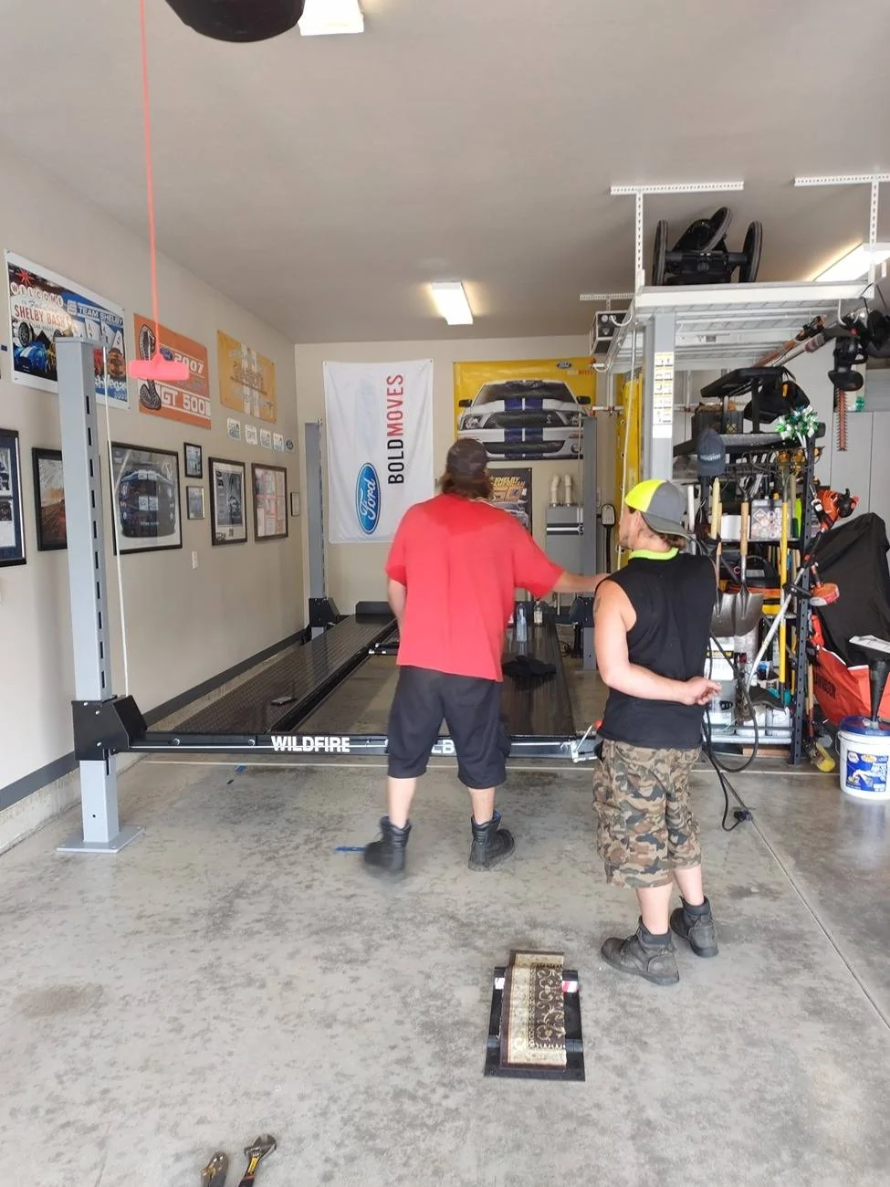

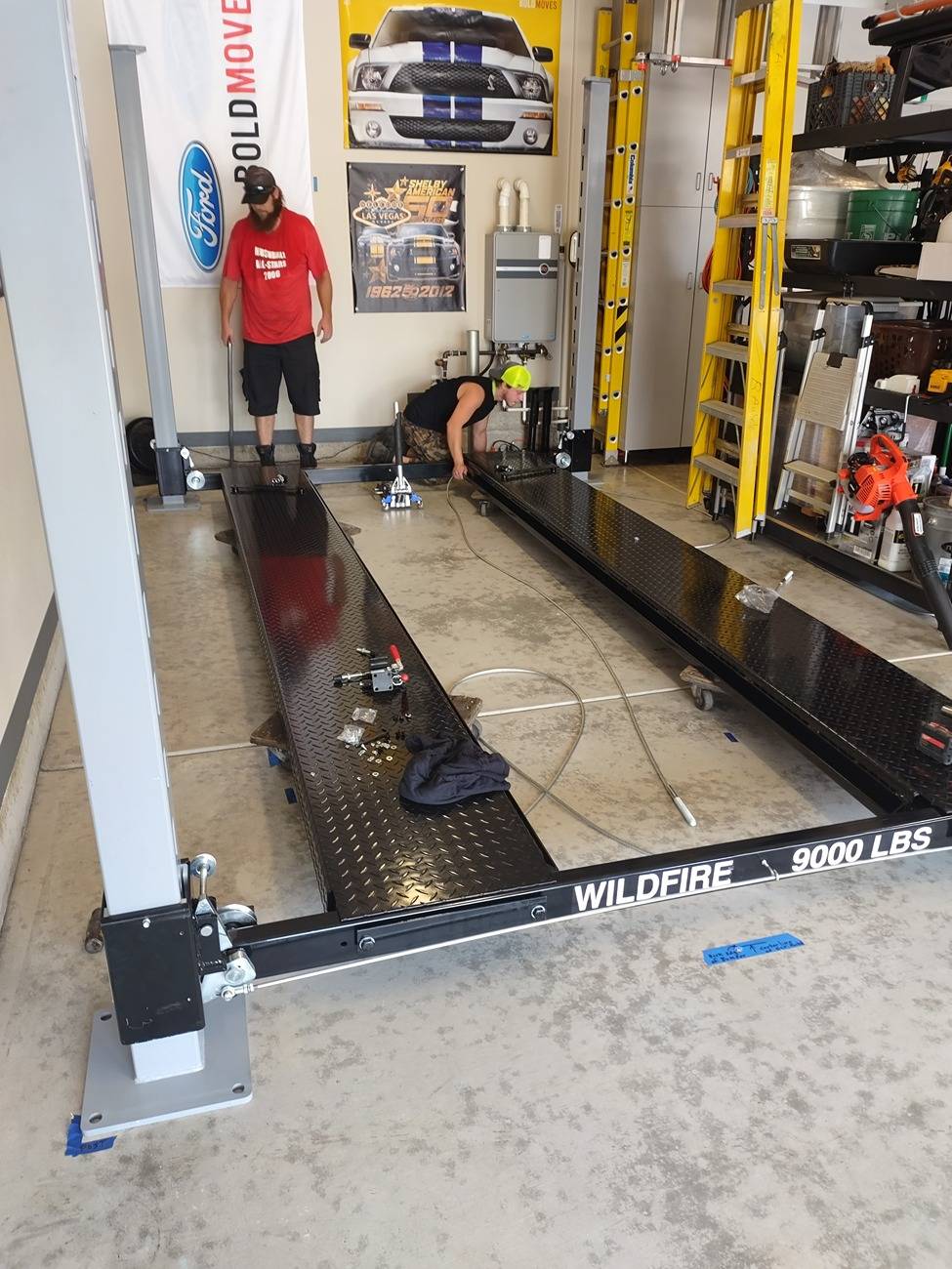

Here's a few photos of setting the lift up. I paid 600 bucks to have a Lift company pick it up at the port and then install it and certify it. Zoom in on the photos and look at how beefy the columns and base plates are. Also look at the steel sleeve that goes.around each column.
