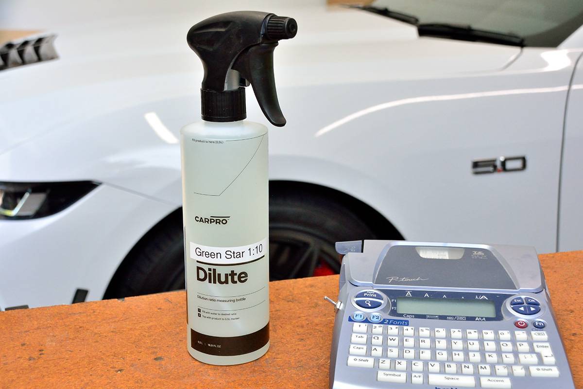

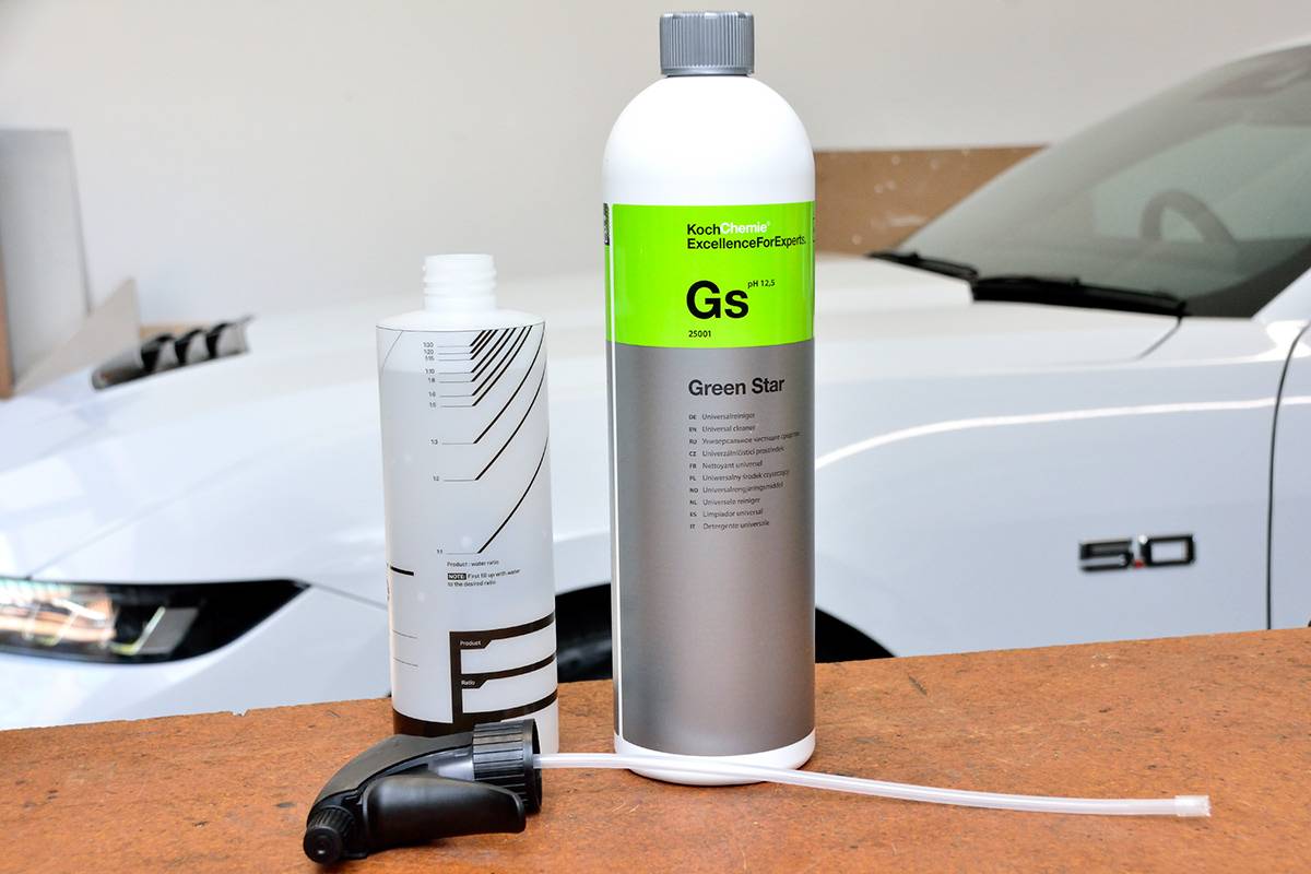

I'm a convert!

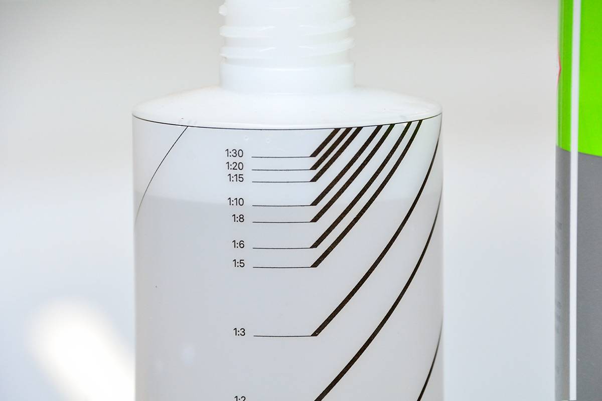

New to me, and first time use of CarPro Dilute measuring spray bottles.
Check your desired dilution ratio on the product bottle, fill the Dilute bottle with water to that dilution marker level, and top up with the product.
In my case I want Green Star all-purpose cleaner at the ready in a 1:10 dilution.
S650 Mustang What's In ALM's Garage? _DSC2207_1200

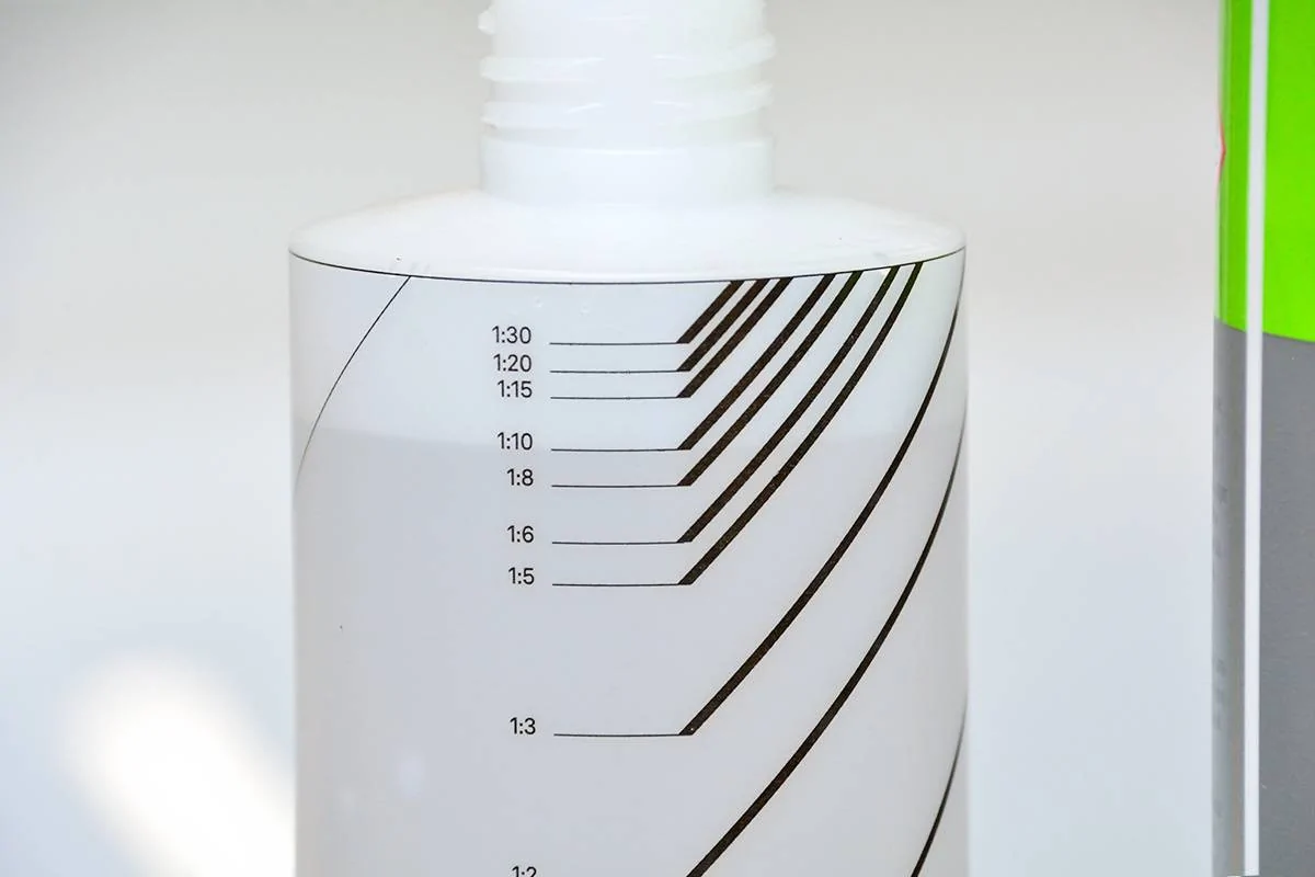

Fill water to the obvious marker, 1:10 in this case.
S650 Mustang What's In ALM's Garage? _DSC2208_1200

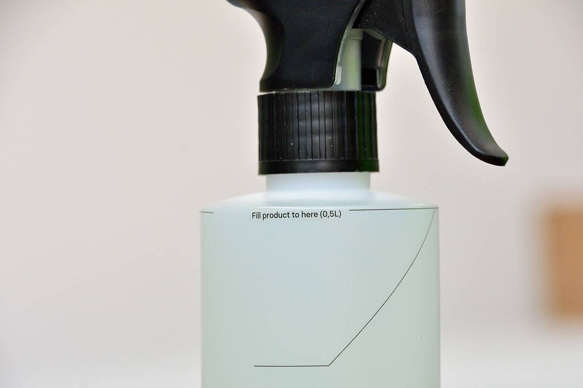

Then top up with actual product to the fill line.
Level rises slightly, once the spray head is screwed on.
S650 Mustang What's In ALM's Garage? _DSC2216_1200
Add a label.
Job done. :like:

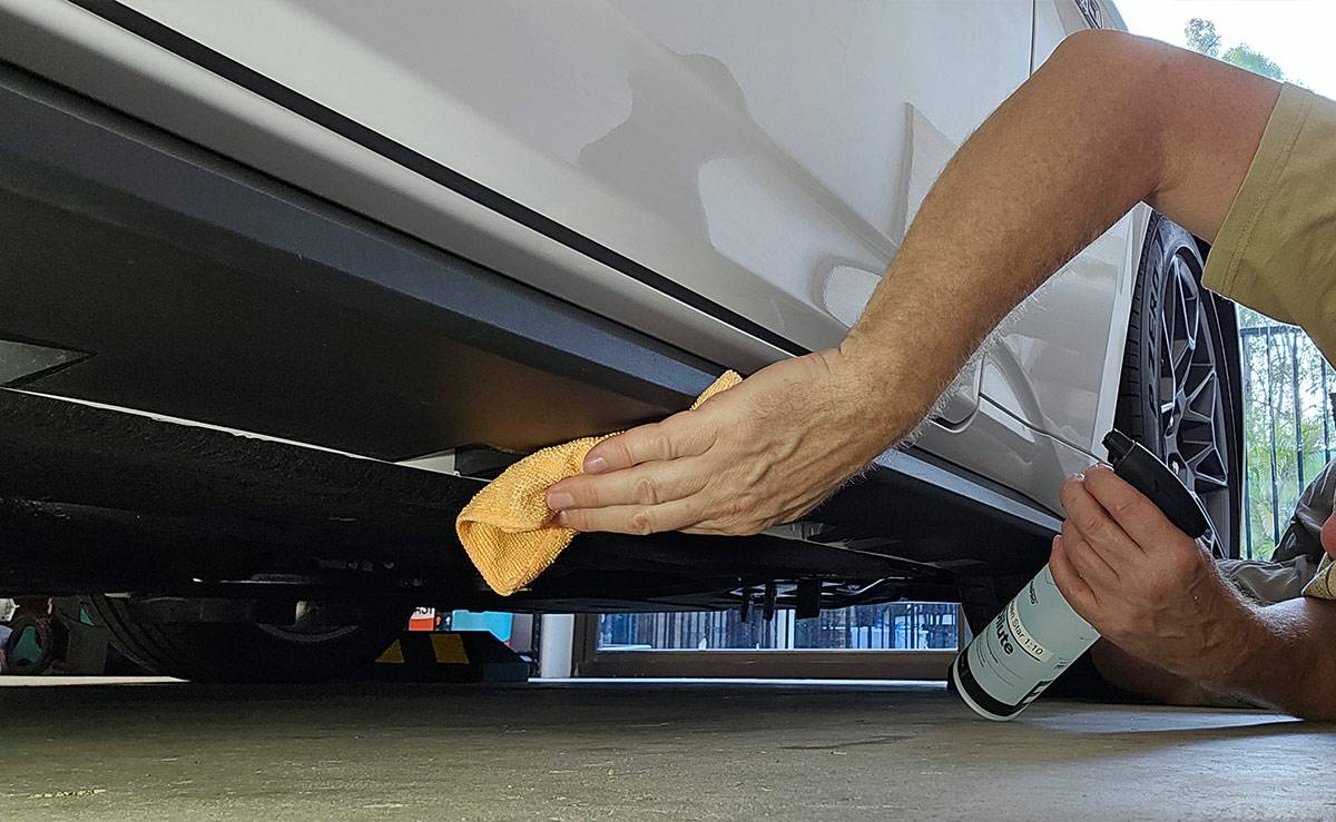

We got a basic wash yesterday, but underneath cannot be forgotten.

I love those bottles. I'm not great with numbers, other than remembering car facts and figures, so using these is a massive help and requires no calculation at all.

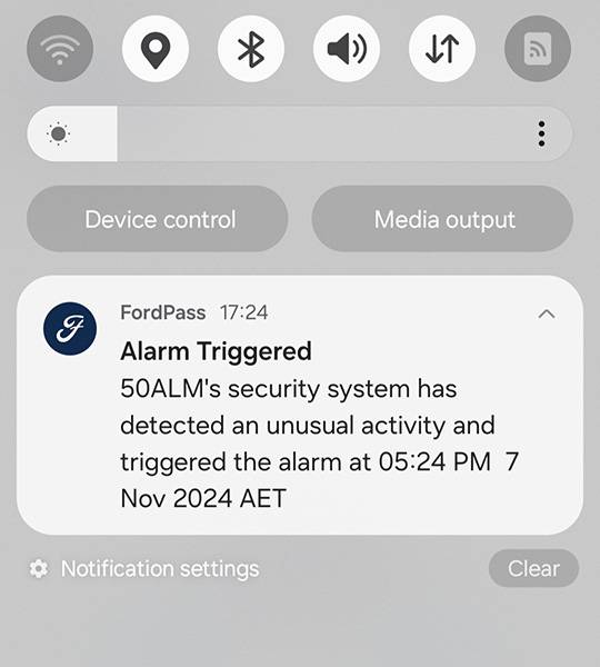

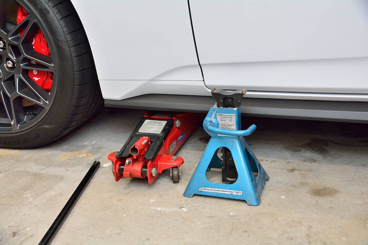

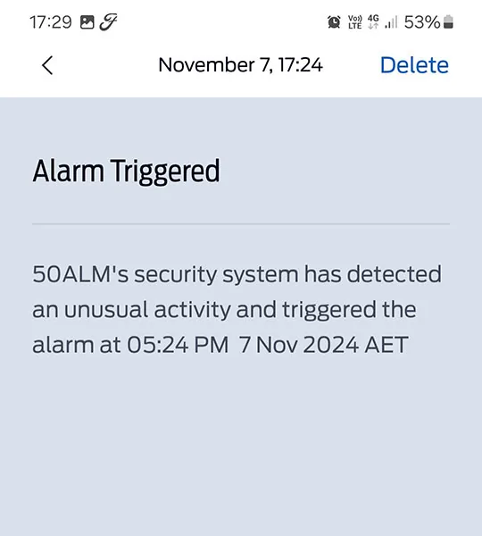

If your vehicle is off and locked, don't jack it up!
Apparently, the rather loud alarm will go off.
Don't ask how I know this. :facepalm:
And the Ford Pass notifications work as well.
(I have not disabled or crippled connectivity in any way)
S650 Mustang What's In ALM's Garage? Screenshot_20241107_172901_FordPass
S650 Mustang What's In ALM's Garage? Screenshot_20241107_172516
It was a mad rush back into the house to get my key fob and unlock the car. :giggle:
