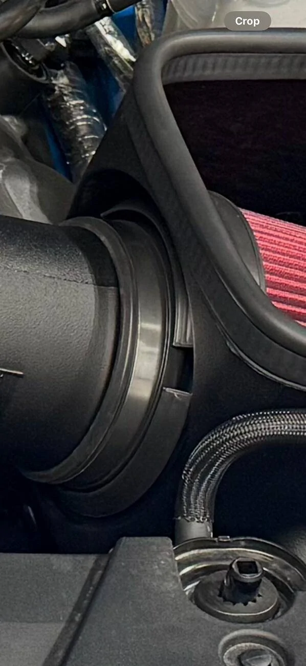

Unfortunately, they cannot. I would prefer those filters, I liked the test results and the quality from them. The reason they do not fit is due to the box design, the S&B filters pull through the box and don't actually attach to a tube.

Pardon the ignirance but how do they attach then?
They pull through on the engine side. In this pic, you can see I actually do not have it pulled all the way through at the top. (edit- it is pulled all the way through, just appears to not be. Hopefully this pic helps though.

They pull through on the engine side. In this pic, you can see I actually do not have it pulled all the way through at the top. (edit- it is pulled all the way through, just appears to not be. Hopefully this pic helps though. The throttlebodies seem to be good may give some benifit but at 500 ish each that aloy of cash for minimal gain without a tune
Gotcha much easier to get the filter on.

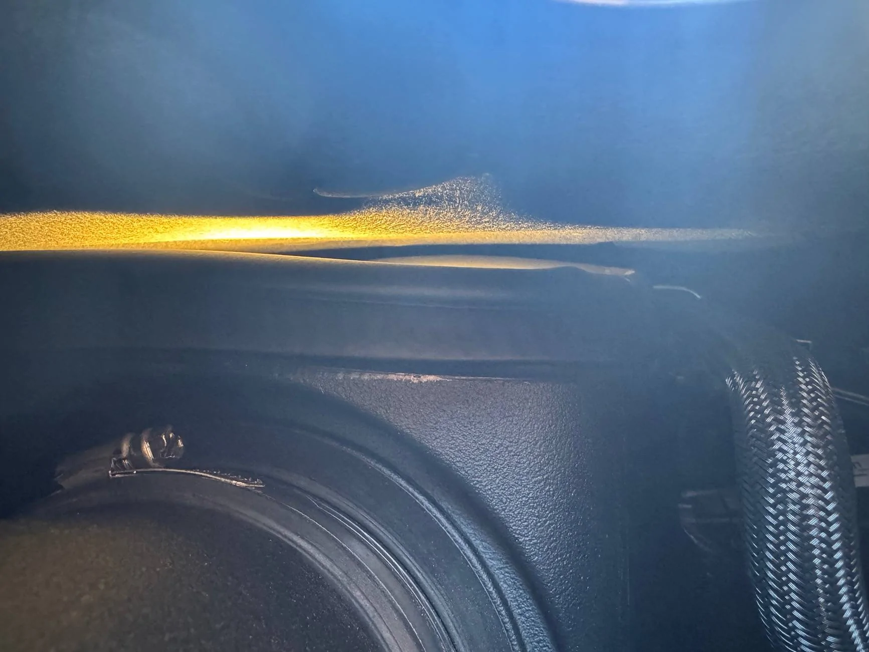

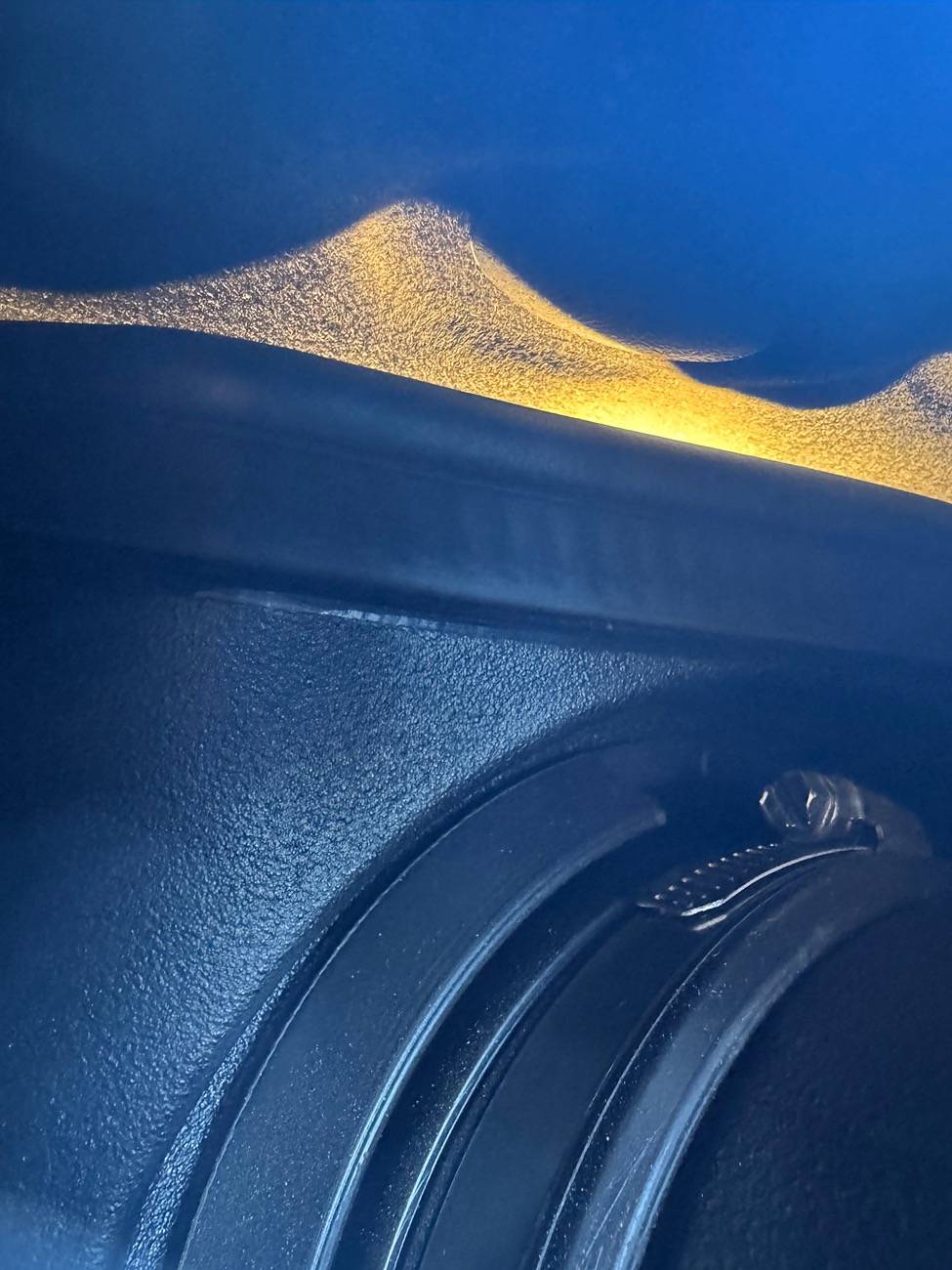

I edited the first post to include an additional video showing the intakes do not seal up to the hood as advertised ...
***update- JLT/S&B reached out and I possibly received some defective boxes and we will work to get correct boxes to replace these.
Hi. Did you get the new boxes from them yet? If so, how are they?
I have the same issue with sealing on the top with both sides
I did not, they are going to be testing some new seals on the top of the boxes then sending me those. I suggest you reach out to them and let them know you have the issue as well.

I wanted to provide an update to this intake- JLT / S&B worked with me on testing out some new seals and a little spacer on the driver side. We got the airbox to seal up to the hood about 95%. I'm pretty happy with this as it's the best value intake at this point and it achieves what I was after at the lowest price point. I also added some different silicone boots to the intake to clean it up. I am very happy with it and wanted to share my experience.
