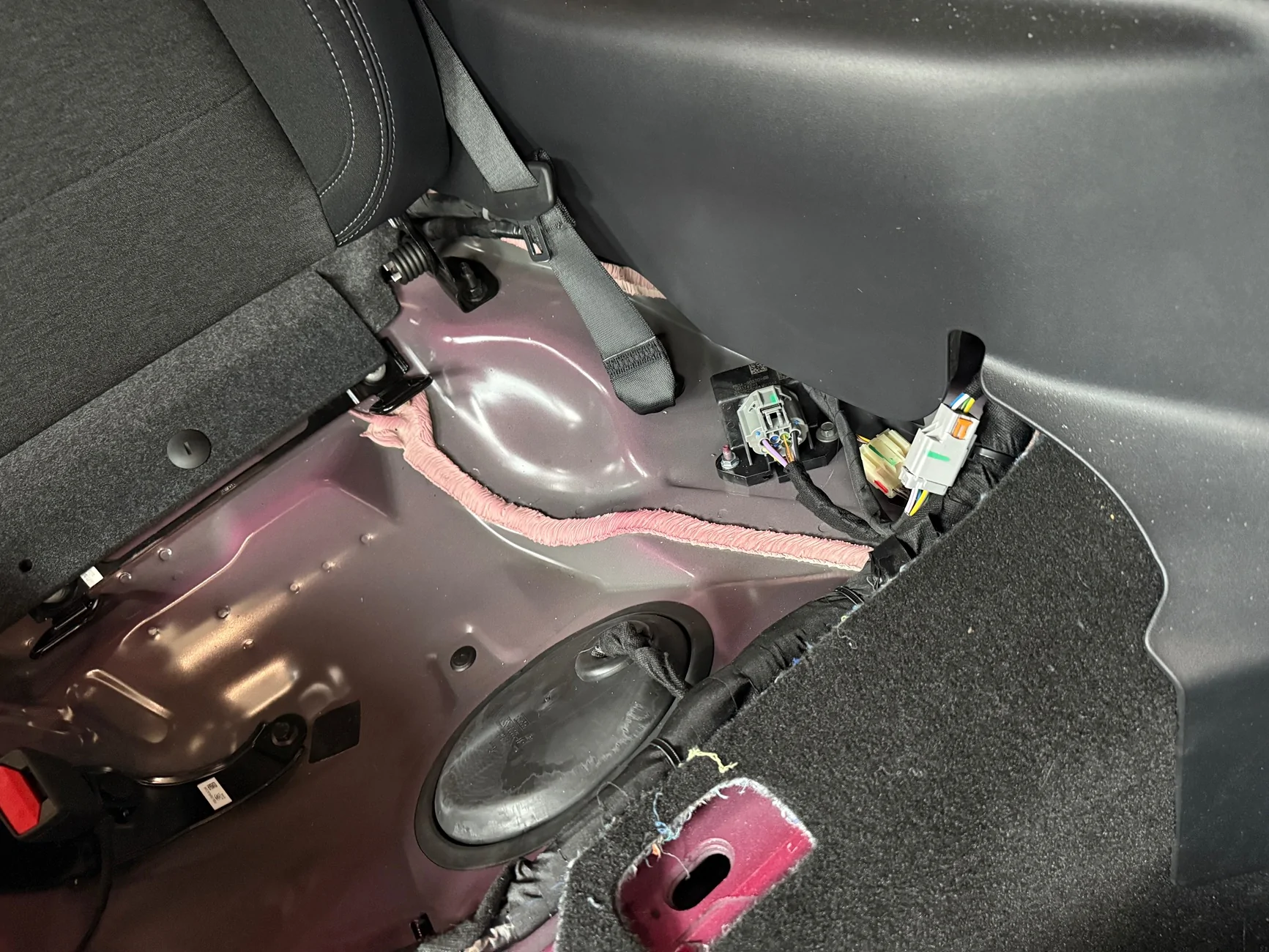

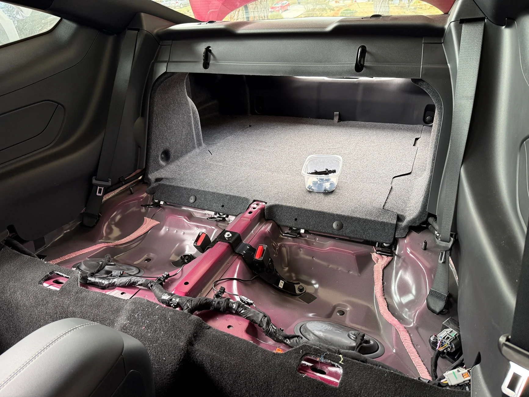

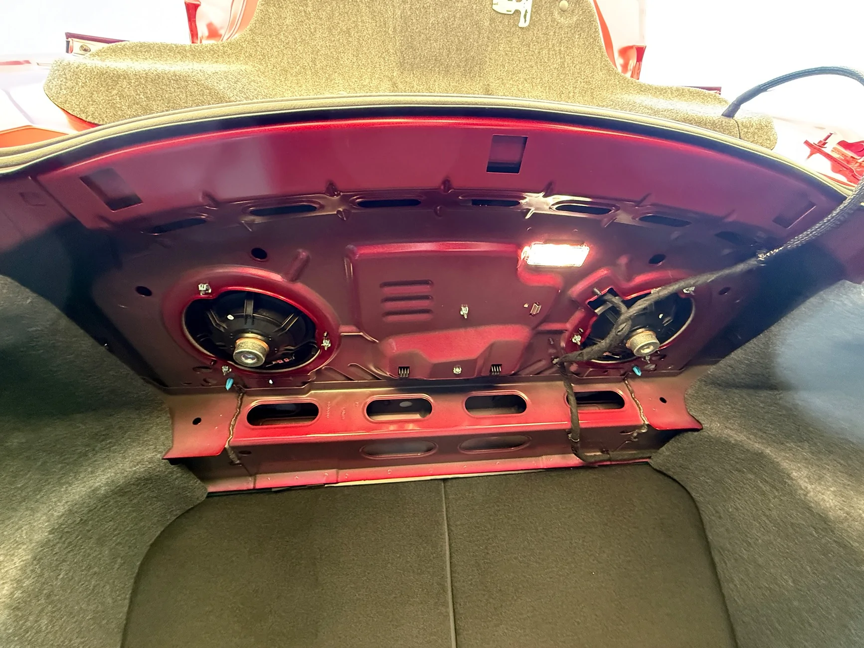

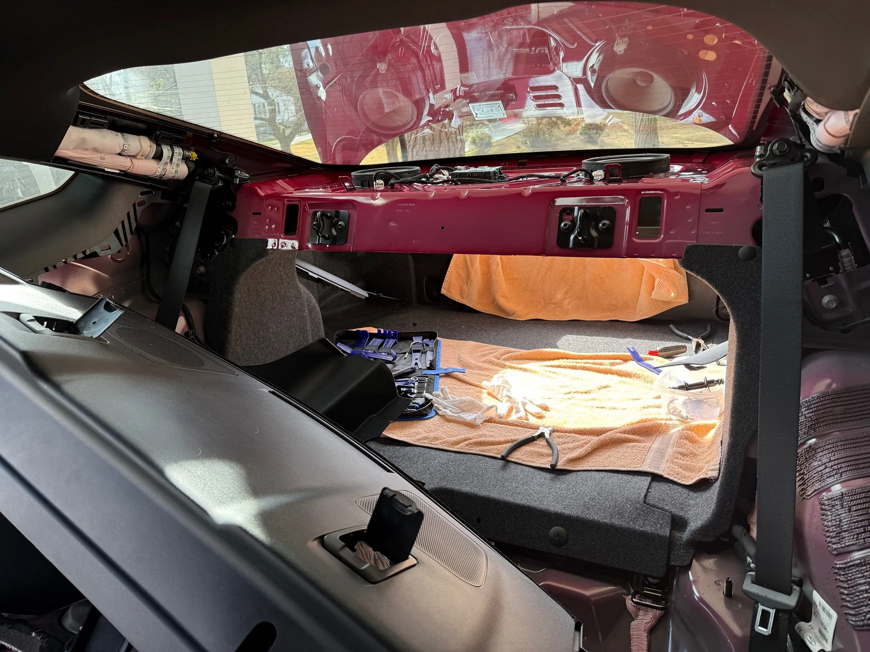

Just did a complete deck lid removal etc to replace the rear speakers. No strange fasteners luckily. Is very similar to S550 videos on YouTube. Taking rear seats out is a must
And blue alignment tabs in rear need to be pinched with needle nose
