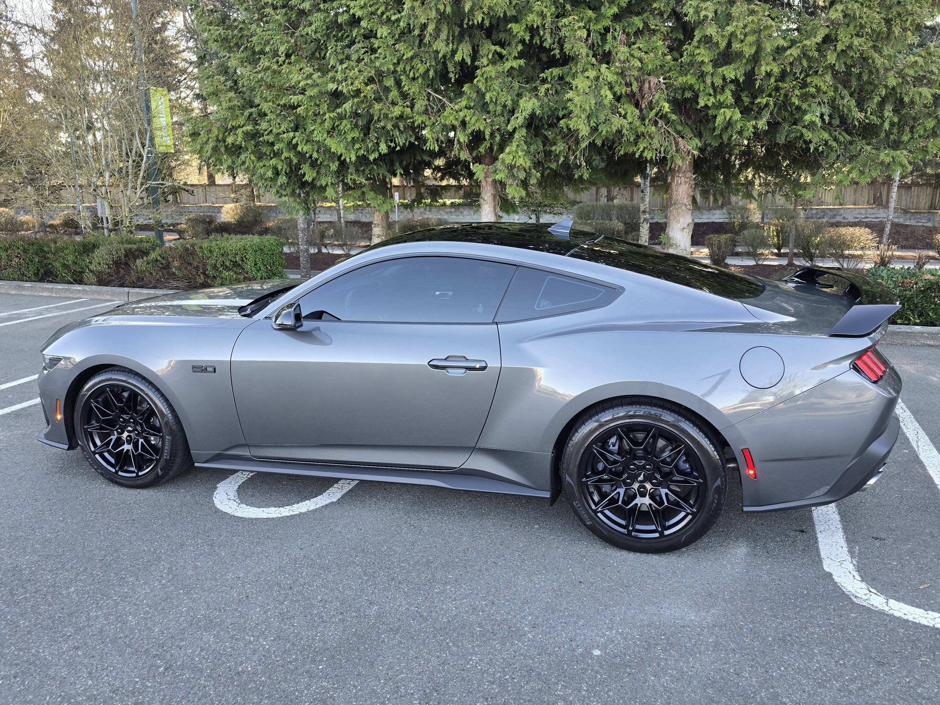

Hi All,
I think I know the answer (which would be no), but want to confirm.
Is an alignment needed for just adding the these two suspension parts?
I just added the IRS rear braces and don't plan to add any other components like the other stop the hop bushings, sleeves, etc.. They bolted right up no issues and car feels great. Immediately feel the power being laid down better to the tires!
I also ordered a 2pt G-Track brace for the front and will install next week which I plan to be my last suspension mod based on what I do with the car.
2024 PP A10 Magna ride
Thanks
Evan

I would say if you didn't do the bushings (didn't unbolt the subframe) you should be fine without. Although if your car has never had an alignment, I would highly recommend it as most seem to be out of spec from the factory.

Nice looking car!!

If you've had it less than a year, less than 12,000 miles, and bought new, you should have an alignment paid by Ford
