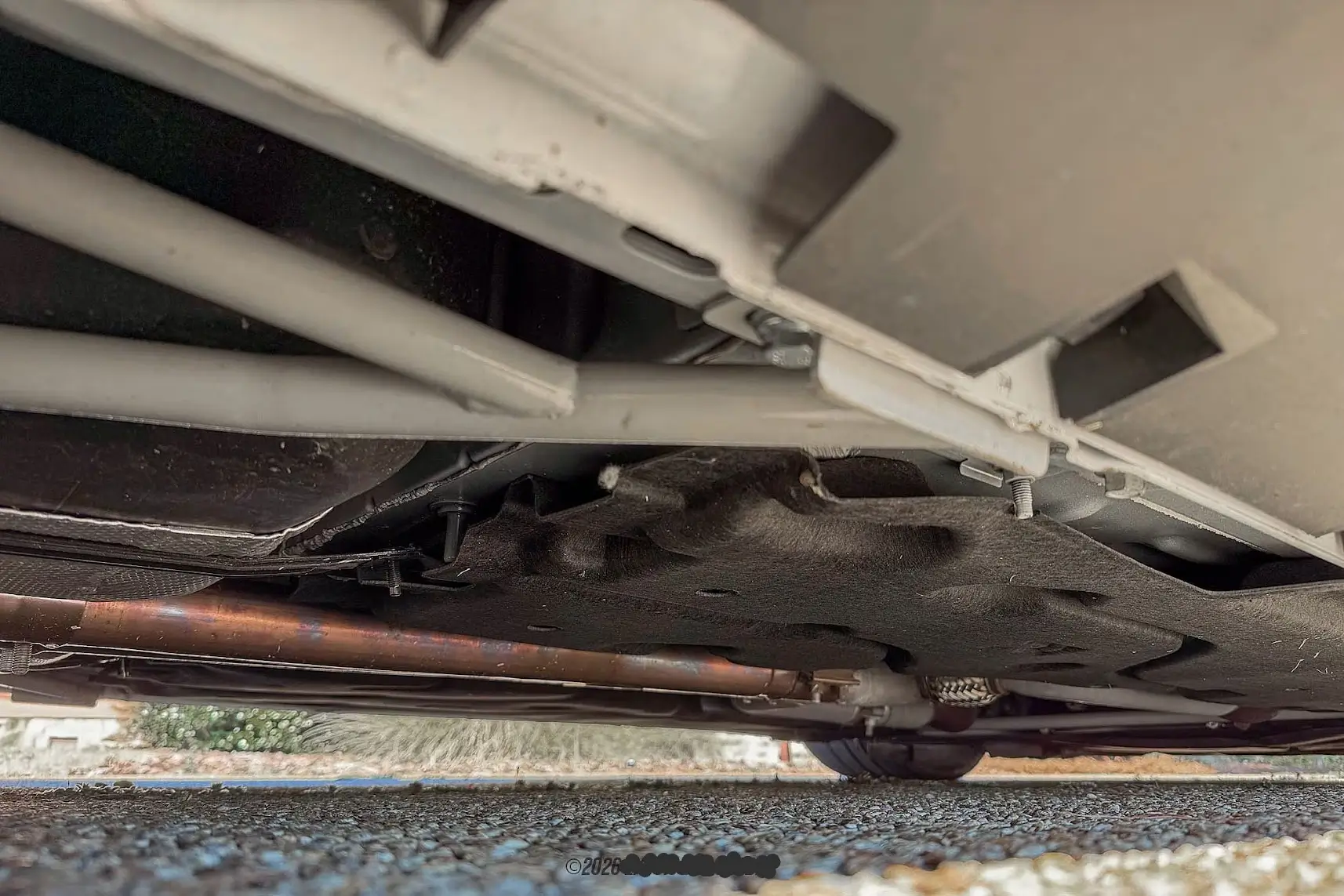

Steeda’s Stop the Hop Kit is not a single, unique part, rather a pre-packaged marketing bundle of several different rear suspension components sold under one part number.
It is strictly listed as "Coupe Only" because every single tier of that kit includes the Steeda IRS Subframe Support Braces.
The underside of the convertible chassis features massive, factory-installed cross-bracing which physically blocks the Steeda IRS Subframe Support Braces from bolting up.
Because I could not fit the rear IRS braces, I focused on stiffening the front half of the chassis by utilizing the G-Trac K-Brace.

@MustangMitch69 : Ahh Ok. In truth, I never looked to see if it was coupe only....Heh, I have a coupe, so I was like yeah.
Makes sense, the verts have the extras. Honestly, I have not seen underneath a Vert Mustang since my 97 Vert GT.
