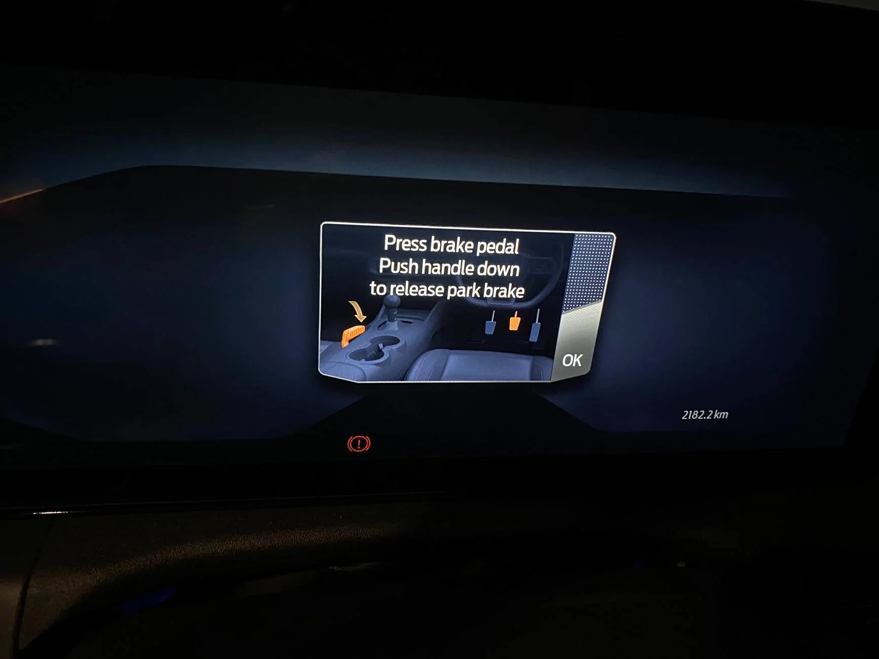

Anyone know how to get rid of this .. it's on the main screen and car off.. hand brake is off !!
Stays on even when car running
S650 Mustang Press park brake push handle down to release park brake IMG_4204

By chance have you tried using the steering wheel buttons to acknowledge?

Dumb off topic question, but is your parking break on the left side of the console, away from the driver? I'm asking because of the picture in the error message.
I mean that is the drivers side here in the states, but it seems out of place for a right hand drive car.
Yeah, that's where it's located for RHD models. Ford didn't bother with a redesigned centre tunnel for the RHD markets!
Same for the 2004 GTO in America. I guess they can move everything but the parking brake lol

^ since it’s backwards maybe pull not push? Downunder upover. Hopefully it cleared by now.

All gone...FYI. my battery went flat in 24 hours as it stayed on even when car locked..
Called Ford assist and they sent out a service tech.. had to clear all faults on system, and now gone!!! Battery all charged again..booked for first service next week.. 2500 km.
Did you try to unplug the battery first for a hard reset before you chose to let the battery drain?

Unfortunately not!!! Didn't go flat until just before tech arrived!!
He said first time he had seen this!!
Hopefully won't happen again
