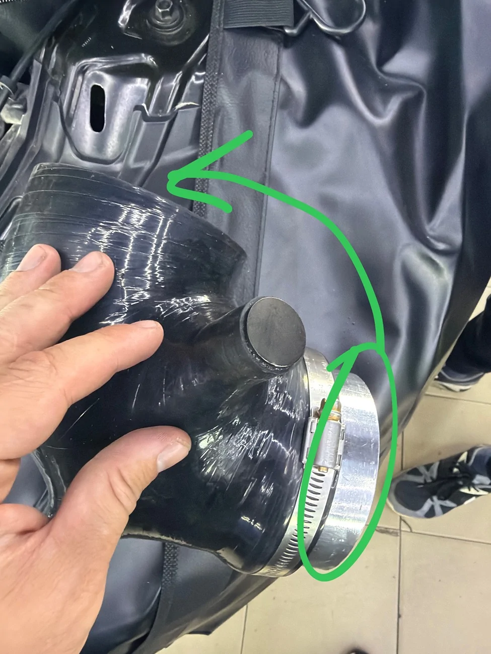

1. Guide don’t show all instructions what to do with Dark Horse grile
2. Pipe from turbo don’t fit on it = making new one. Pipe 95mm, Turbo 101mm
3. Filter has no place to be installed, as there is no space for him, we cut metal tunnel between pipe and filter
4. Dual pipe to throttles is so f**** heavy!
5. Mounts of turbo - had a lot of issues to become them straight
regarding adapter for CJ
Called to Boschma to USA and asked to send asap his new one for Ess - he sent, but hood don’t close with it and is is very difficult to connect dual pipe with it
