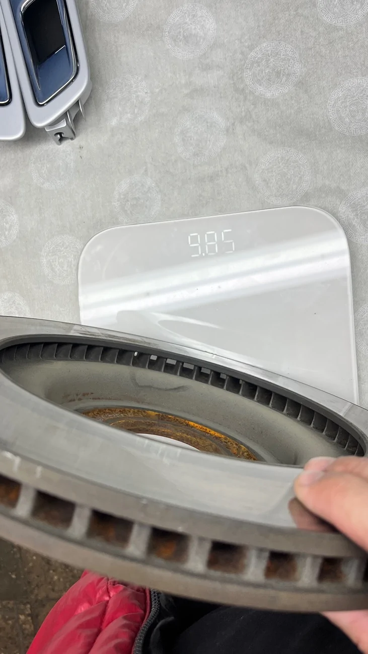

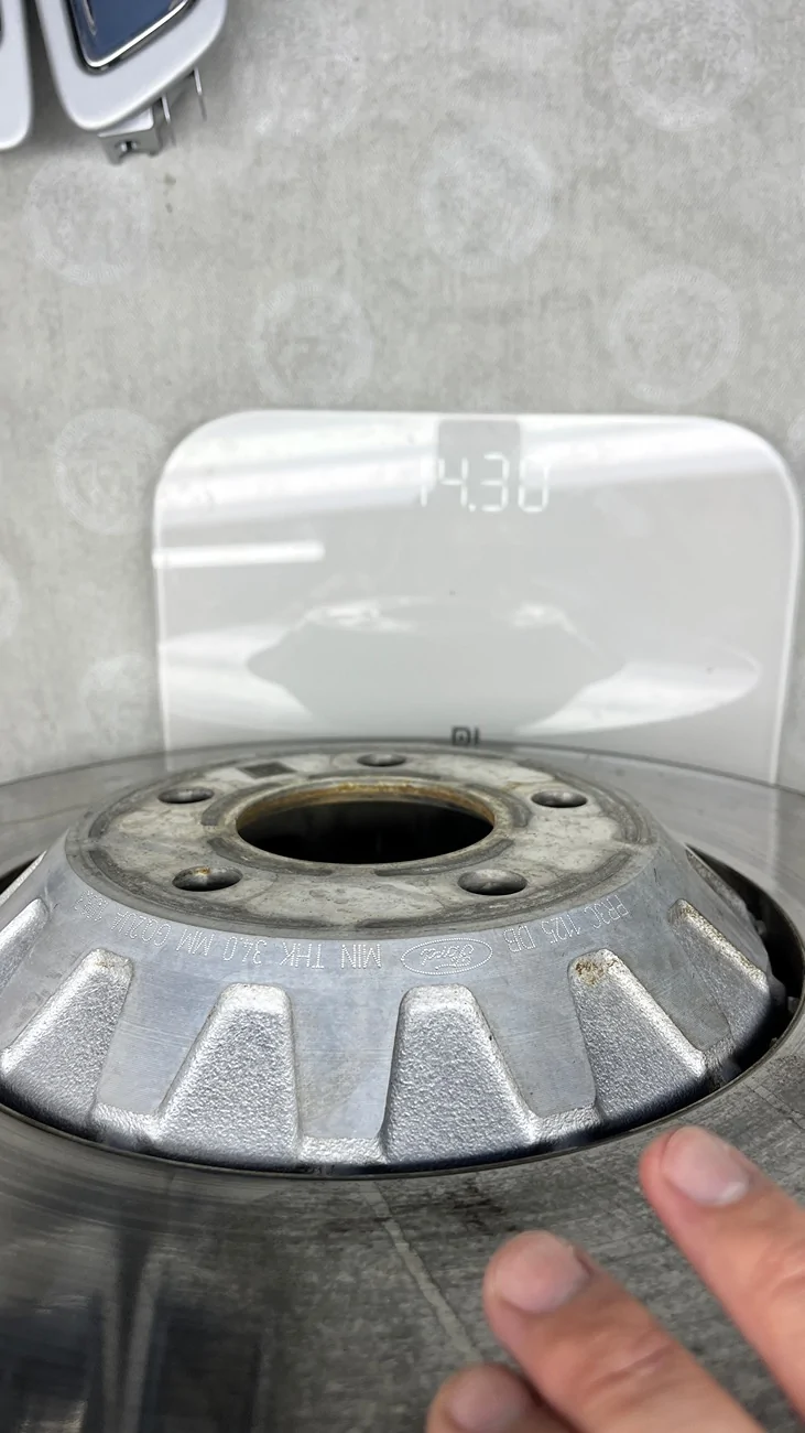

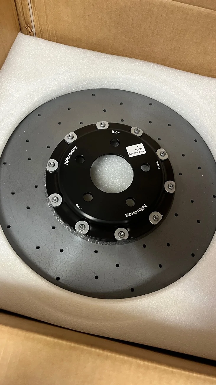

received carbon-ceramic rotors
Front - 6.15kg
Rear - 3.9kg
stock
Front - 14.3kg
Rear - 9.85kg
Total
Front -16.3kg
Rear -11.9kg
Grand total = -28.2kg (-58.3% stock weight)
at least 1 thing is cheaper here in Russia) 4 rotors = usd7.000
in USA I see usd11.000
https://racingbrake.com/for-crk-390-360/

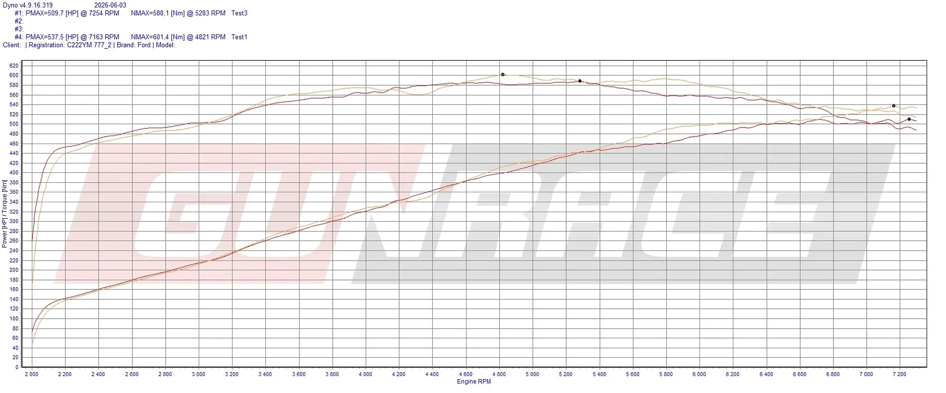

today made dyno on Cobra Jet
Same dyno
Same weather
cobra jet without cams even makes power lower…
Red - Cobra Jet
Orange - stock DH manifold
S650 Mustang Mustang Dark Horse S650 N/A made 537whp on dyno with bolt-ons & tune IMG_7950

So this shows it hurting power from 5600 to 6400 pretty substantially.
I thought it should gain 6500-7700… but I was wrong 😁
now I am buying ESS g3R blower with 120mm pulley for 93 and RFS Fore dual pump on 100/95mm pulley for e85 and I am confused … shall CJ gain power or make it less without cams…
