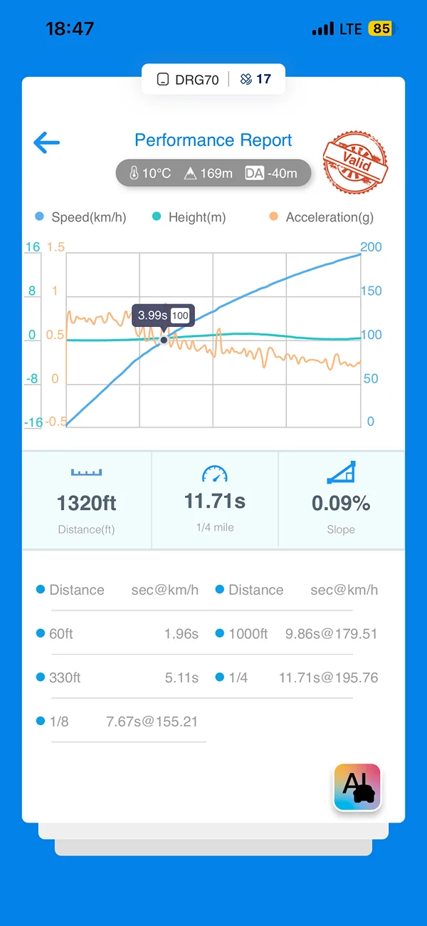

check out 1/4 on street

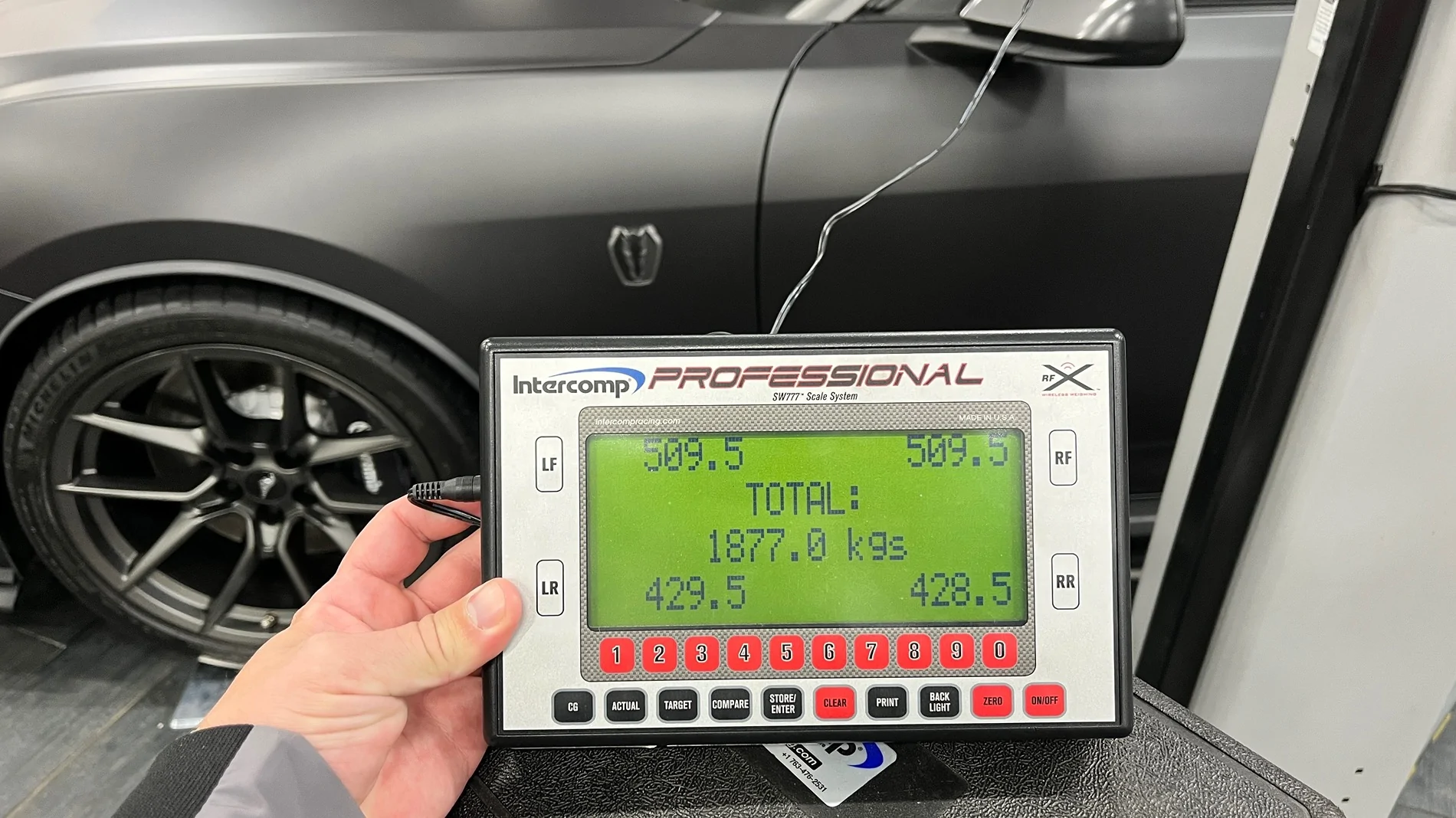

4138lbs without me
537whp n/a
Stock wheels and rotors
S650 Mustang Mustang Dark Horse S650 N/A made 537whp on dyno with bolt-ons & tune IMG_6893

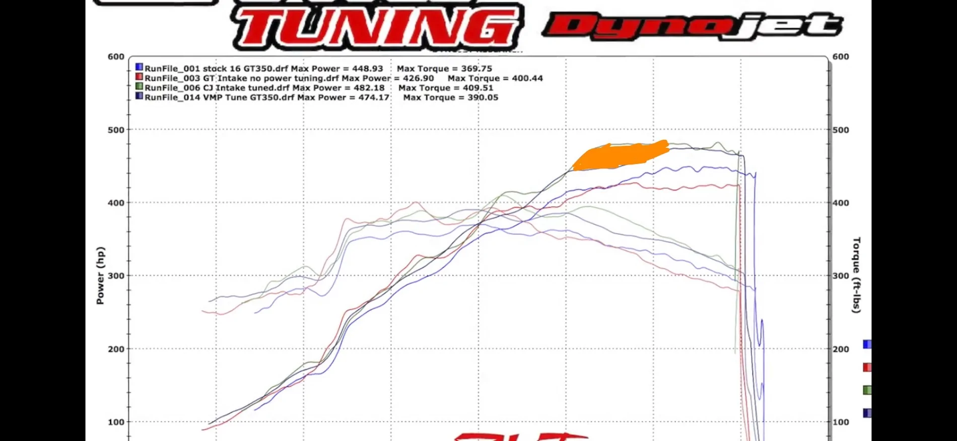

I bought just cobra jet intake with Boschma’s adapter
don’t want to go inside engine to install cams
cobra will give +40whp at 6500-7500 rpm
still have a hope to run 10.999 N/A e85 on drag track)
