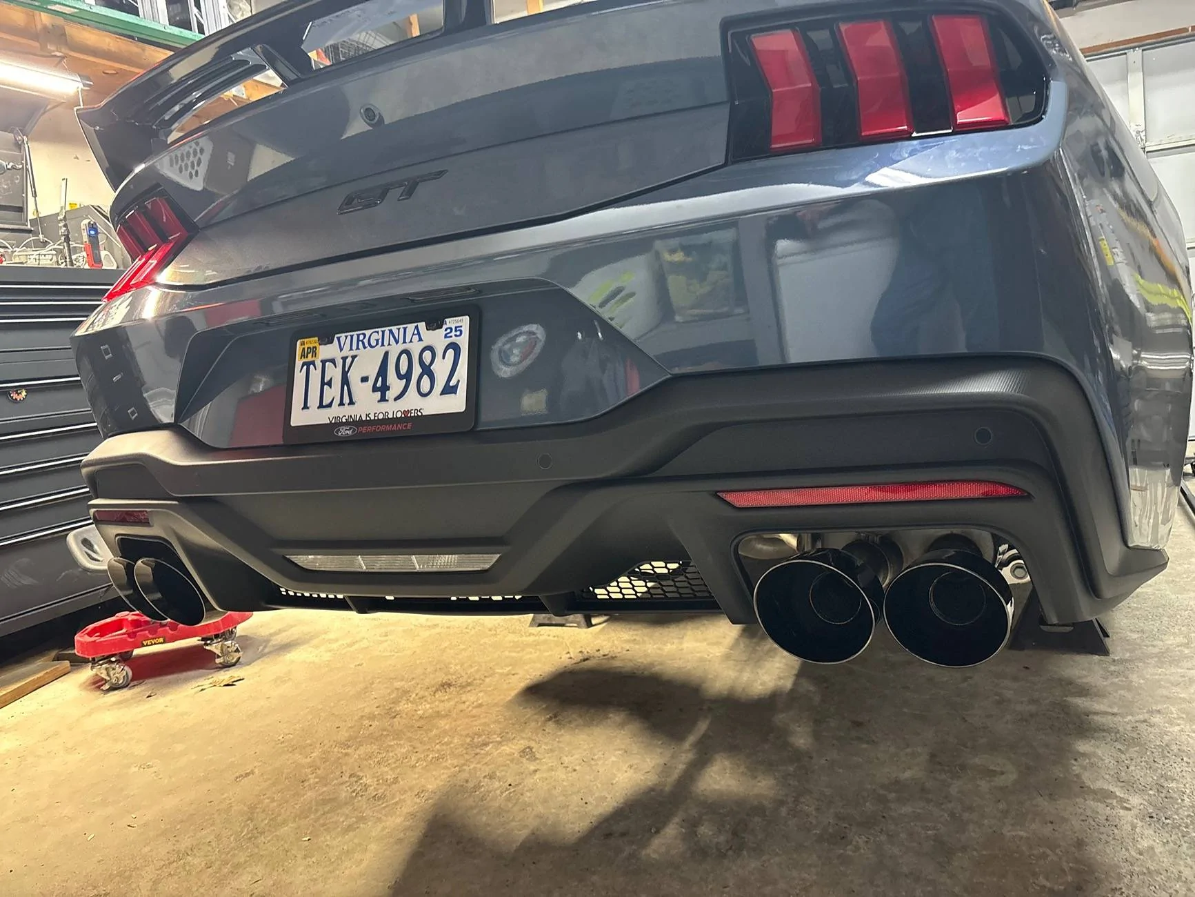

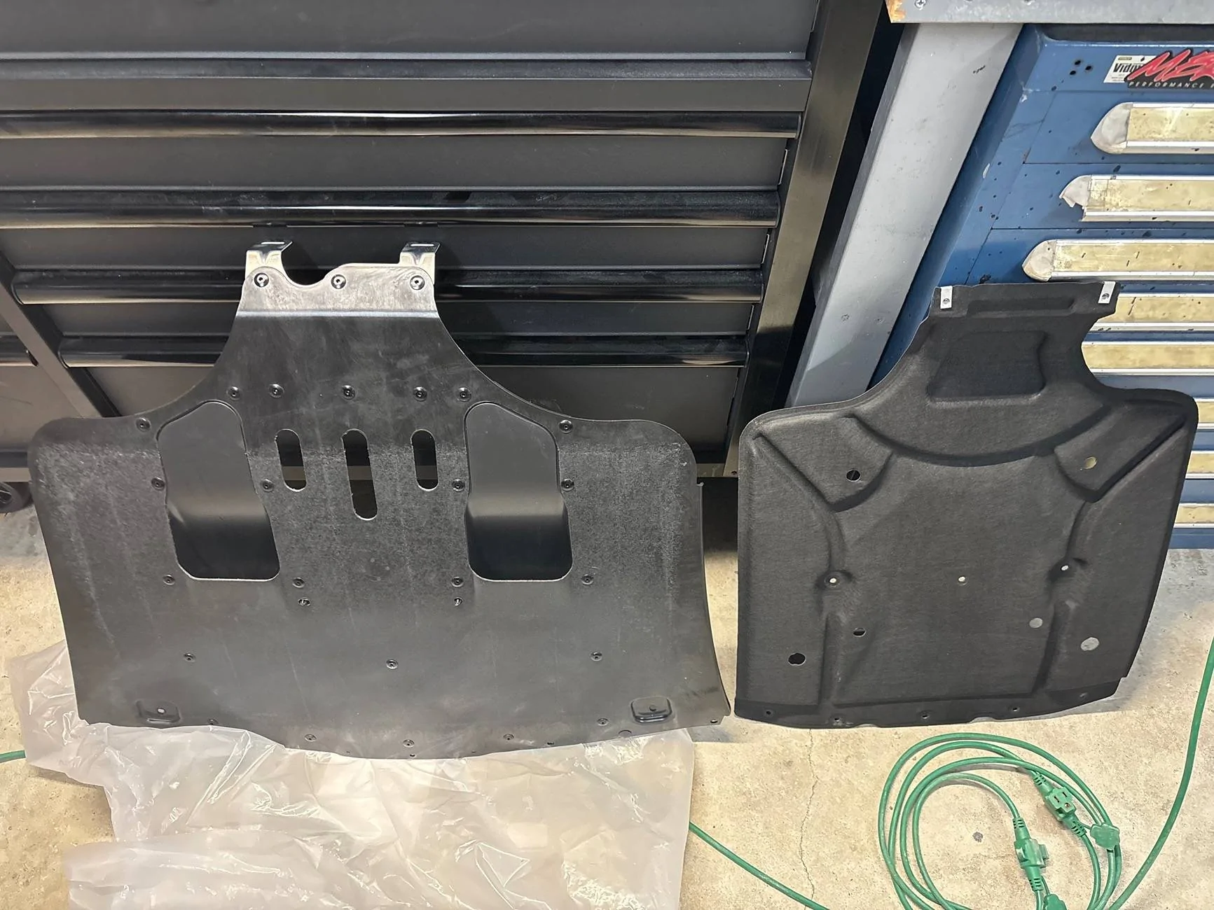

Here are some pic’s.. valance and under tray are ford part numbers and some hardware are also ford parts.. some hardware you have to reuse..

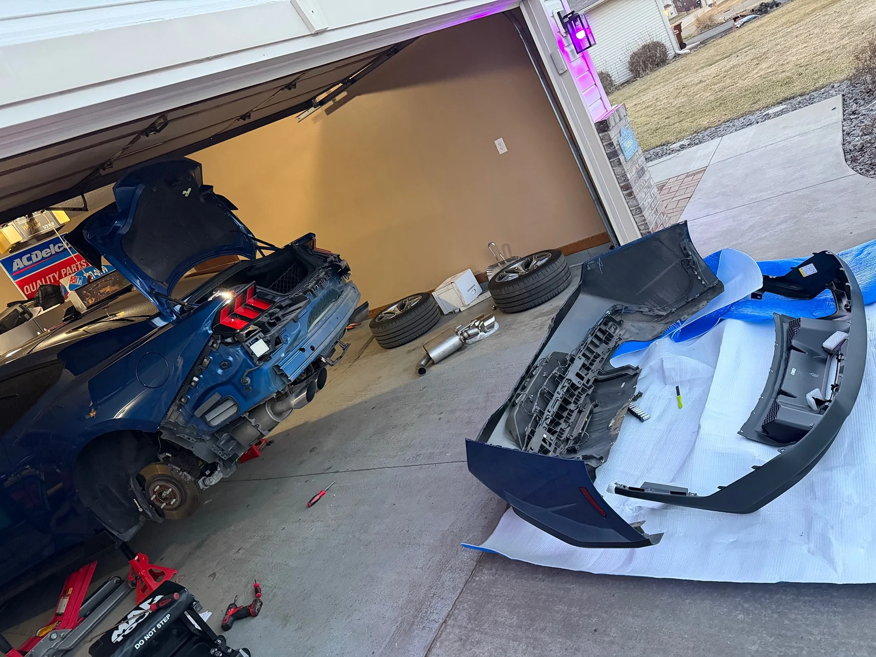

Yes not a bad install.. have a helper with the bumper removal. When pulling on the bumper sides it is a little stressful because you think you’re breaking them. Don’t forget to hook up the harness before reinstalling the bumper.. or you will be taking it off again. Trust me I know that…if you look on YouTube for 2024 Mustang tail light install and there is a video that shows the removal of the rear bumper which is needed on the S650..

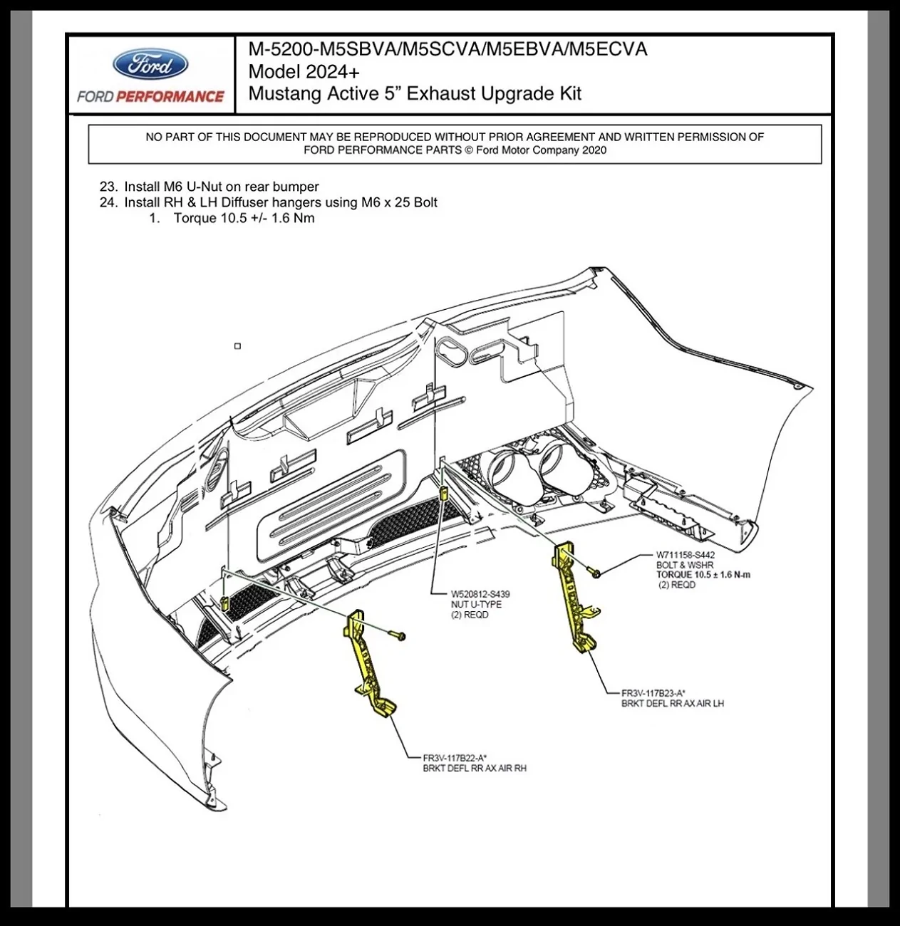

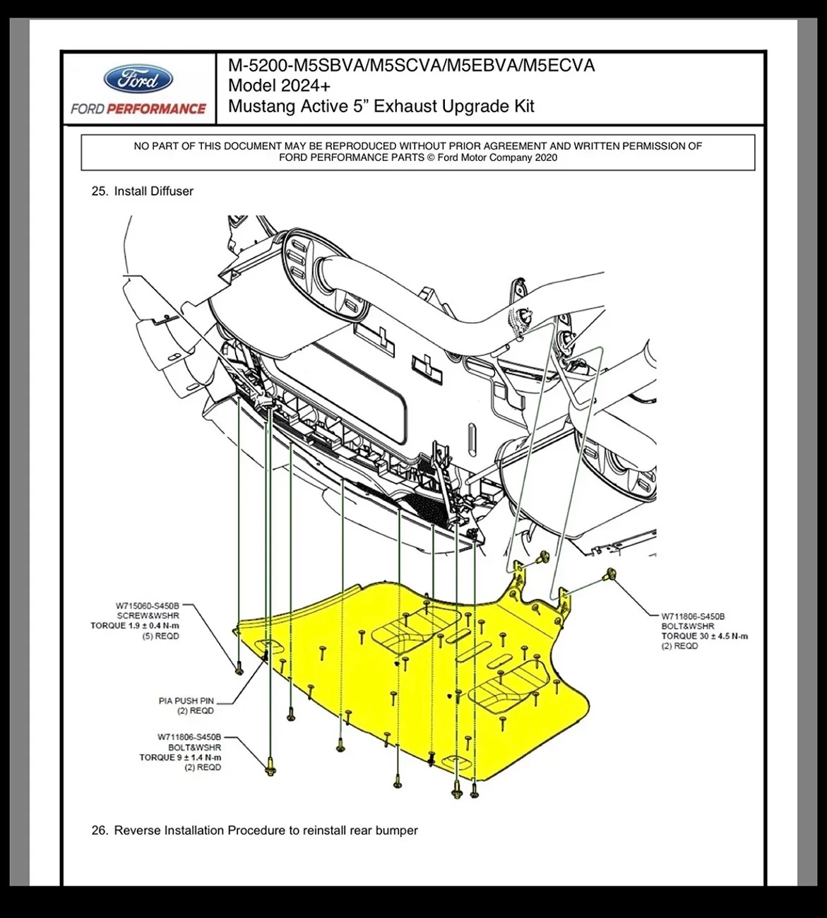

Hey man I was trying to install the Levittown Ford parts kit which comes with the under tray and DH diffuser. But I’m not sure where to install the belly pan braces on the dark horse diffuser. Also the the front part of the belly pan has the metal mounting that seems like it’s supposed to attach to the exhaust hangers which the GT Premium doesn’t have. Would you be able to shed any light on this? Sorry for the long jumbled message…

messaged you some pictures hope they help
Hey my kit was missing the instructions and I and wondering where those brackets go as well. I found this thread while trying to find out where they go. Do you mind posting or messaging those pics also?
