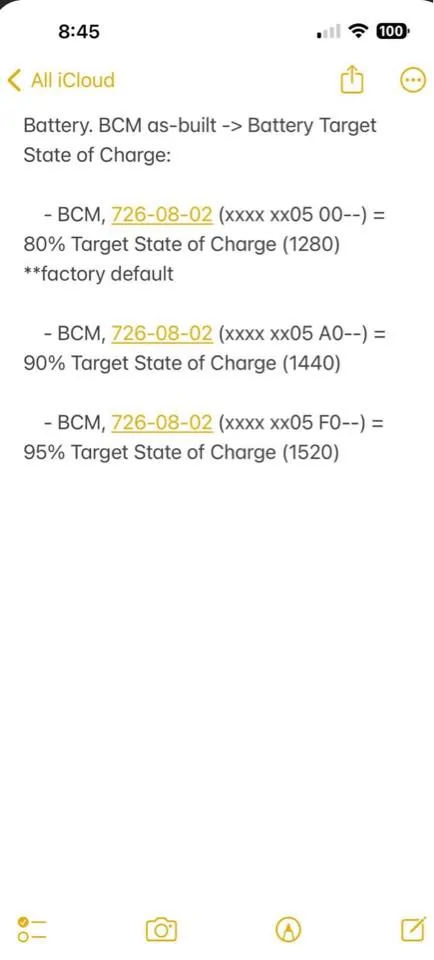

Not sure where you missed this but there are plenty of threads on here and other Ford forums / Forscan forums where it states the BMS restricts charge to 80% SOC to preserve battery life. In some cars you can change this using Forscan.
That is 100% true :giggle:
The running voltage of the vehicle is determined by the charging system (not the battery) and with modern alternators this will vary depending on battery SOC and other factors. It can be very complex but basically it will charge at a higher rate (around 14.5v) when needed but drop to around 13v when SOC is at or around 80%.

What is not true? What simple test with a voltmeter?
ALL Ford cars and trucks use a BMS system in this way with a target SOC of 80% as a default
Check out the BCM settings here for the 2024 Mustang:
(28) 2024 Mustang FORScan List / Database / Spreadsheet (by Livinitup) | Mustang7G - 2024+ S650 Mustang Forum (Dark Horse, GT, EcoBoost, GT500, GT350, Mach 1)
726-080-02
S650 Mustang Moving A 2024 GT In Neutral? 1763567802801-f
726-080-02

The engine is running in everything I have mentioned above, nothing to do with testing a battery with the engine off. I am well aware how to check a battery SOC on a non-running car.
Not sure why you are finding this so difficult to understand?
ALL Ford cars have a BMS that determines the charging of the 12v battery when the engine is running. It changes the output of the alternator (or DC-DC converter in EV's) between around 14.5v and 13v depending on the SOC of the 12v battery which has a target of 80% SOC as per the post above to prolong battery life and reduce the risk of overcharging. It will go a little above 80% at times but will also maintain that buffer to avoid reaching 100%.
The comment about my own car and monitoring the voltage on a long journey confirms this.
I'm not making this up you know - all the evidence is there as I have posted and it isn't just Ford that use this system. Why would people be changing the target SOC setting in their Mustangs and other cars if it wasn't there?
There is simply nothing to argue about 🤷‍♂️
